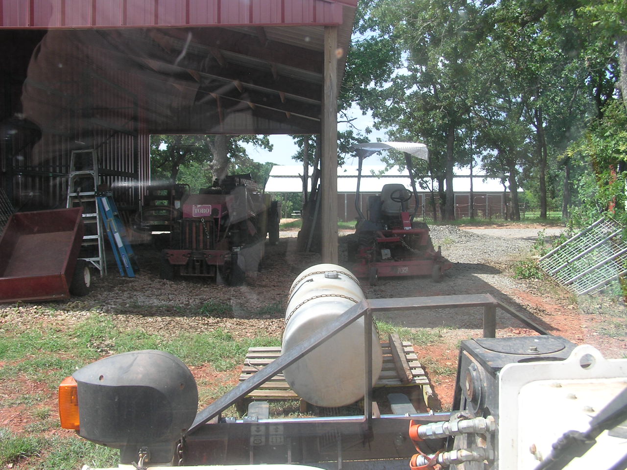

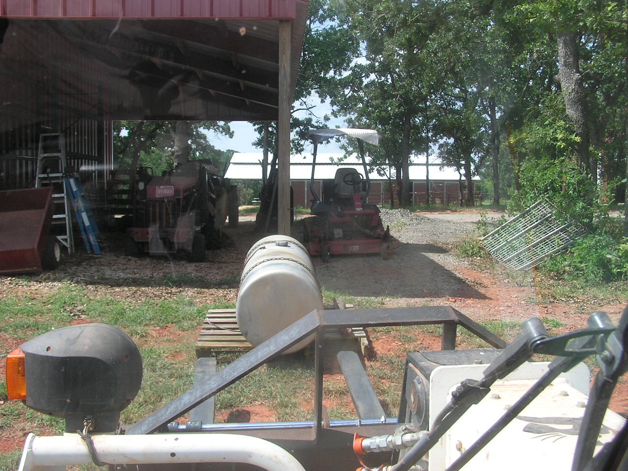

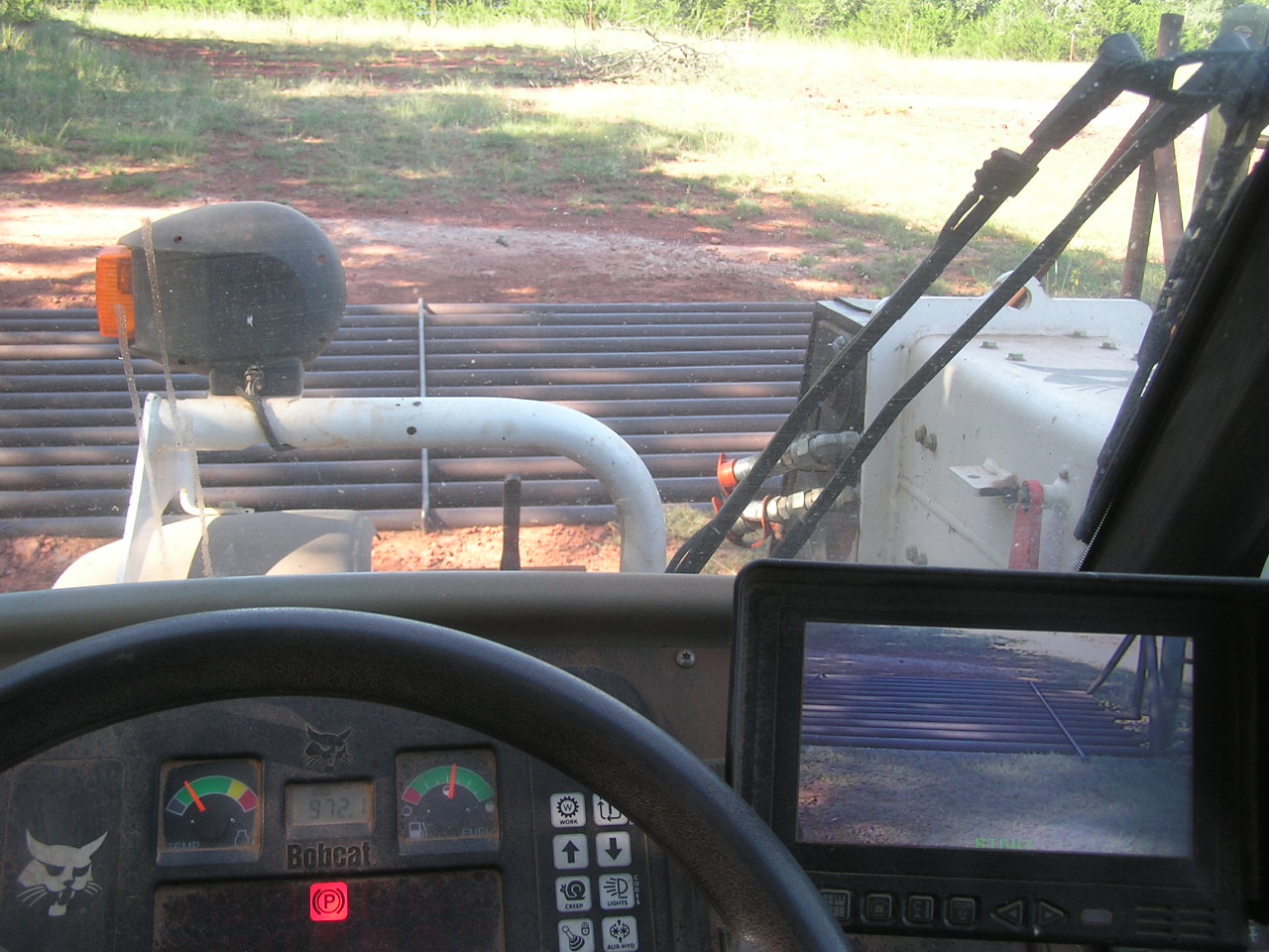

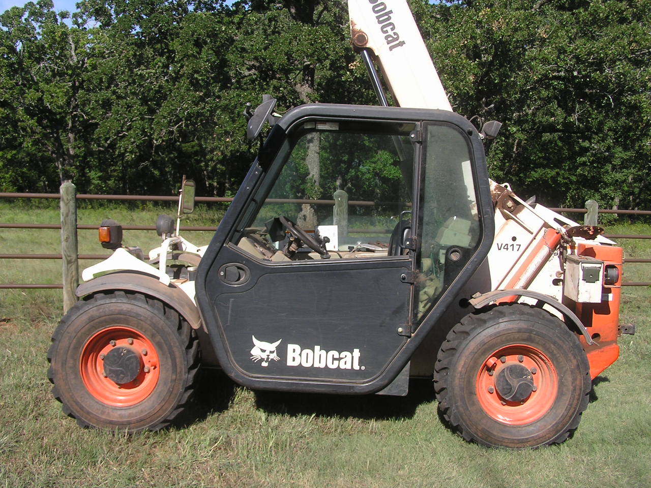

I think that offset cab works to your advantage with the camera setup, being able to eyeball the left while viewing the right on the screen.
Yep, this shows the view and what the camera sees:
The offset cab works well with seeing the 42" forks also:

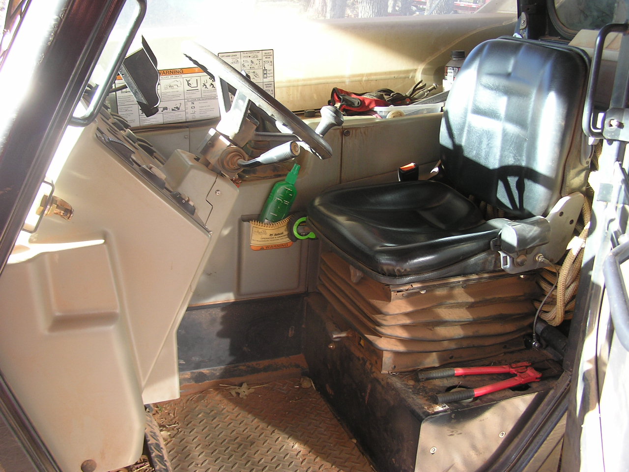

But the biggest advantage for this old man is the step-in cab:
