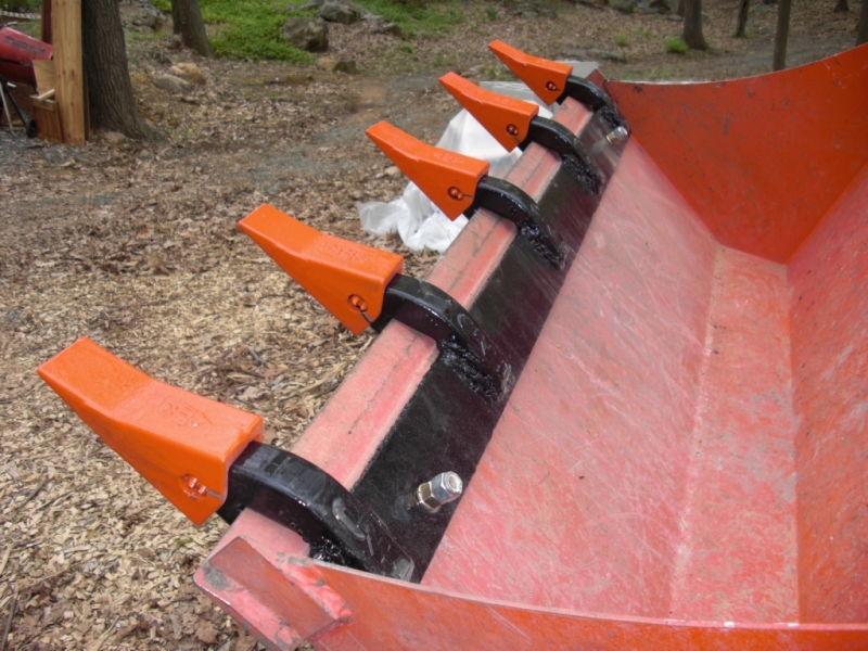

No, like this
Just bolts on the sides.
Made my own about 8 years ago.
My 20 hp CUT thinks it is an excavator. I have moved probably 30 truckloads of blasted rock and more soil.
Moved, actually rolled, rocks bigger than my bucket many times.
Every time I 'plant' my bucket in rocky soil I come up with a full load.
Back dragging is like raking up the roots in forest topsoil.
Have never bent, damaged or hurt anything, trick is to let the hydraulics work and never slam into material especially rocks.
Absolutely best attachment I have.

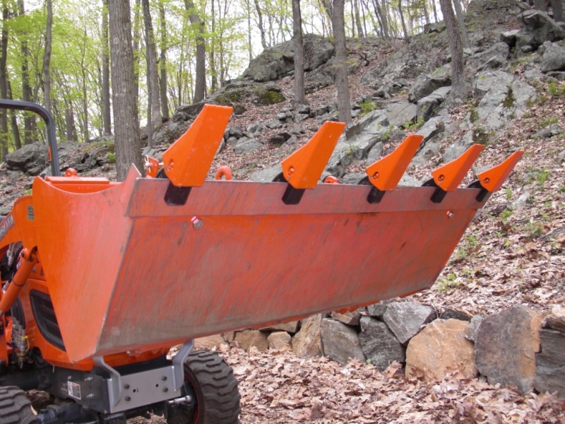

I have the Piranha tooth bar for my Kubota BX25, because I can take it off in the fall and install my bucket expander, which doubles the heaped capacity of my FEL. This is very useful for moving snow in the winter, which of course is very light. So, with the bolt on option, I have the best of both worlds!

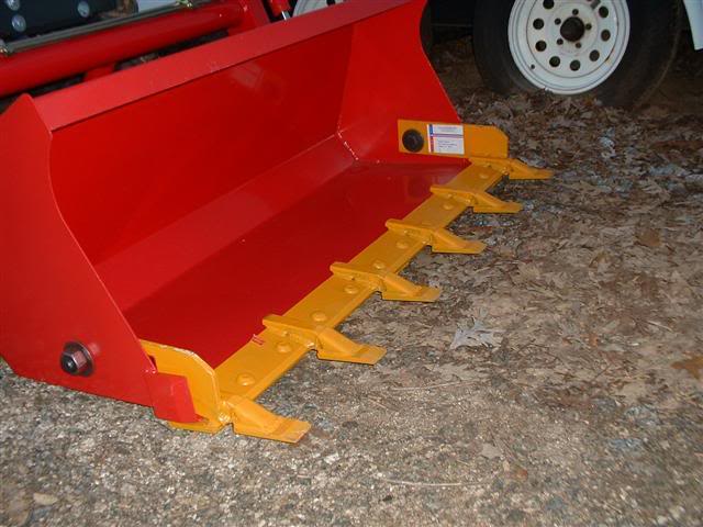

I bolted my tooth bar on five years ago and really can't think why I would ever want to take it off. Back dragging is done with the heel of the bucket. I prefer the tooth bar over the piranha.

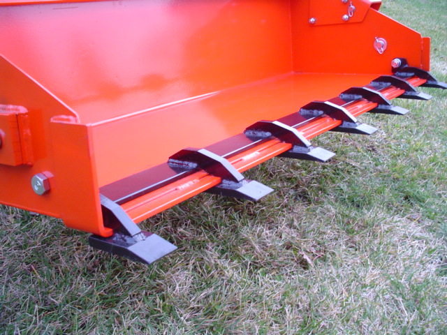

Kristen at BXpanded replied to my email this morning and gave me a quote for a Piranha bar for a 78 inch bucket, about the same price as the Ratchet Rake. BXpanded has also changed their website. At least I think they have or I'm losing my mind, which is a distinct possibility. Now instead of mentioning a few specific brands they have a General Information page which explains how they have made Piranha bars from 34 to 106 inches.
Waaaaaahhhhh! I could have had a Piranha bar after all.
Well, the Ratchet Rake is easy on, easy off and the bottom row of teeth does make ripping roots more effective I think. The front teeth push and loosen and the under teeth seem to get additional roots up. Kind of like a razor with two blades instead of one. Also, Mahindra discourages back dragging at more than a 15 degree angle so the under teeth make back dragging more effective for us.

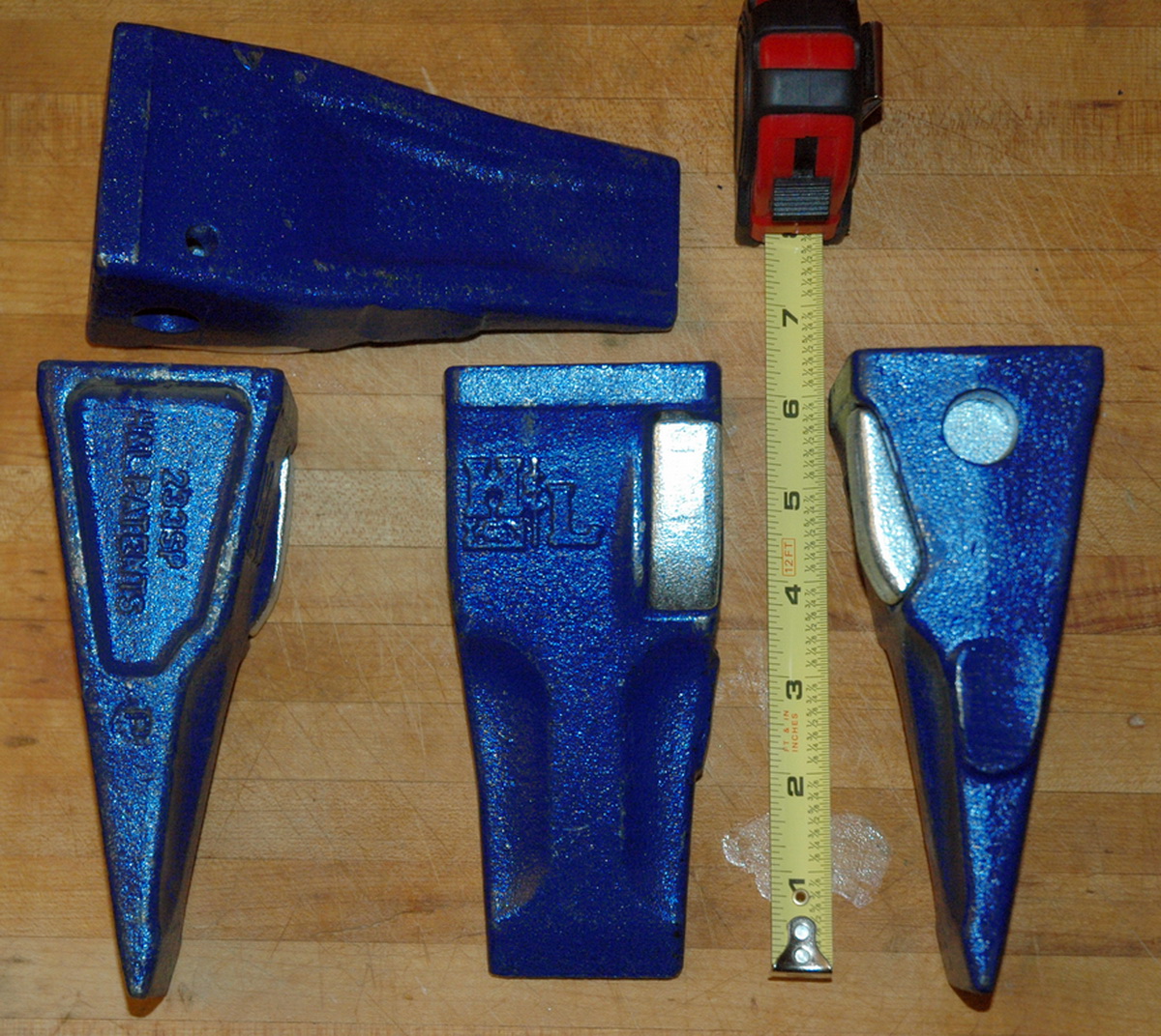

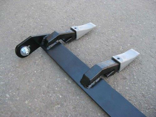

Looks like I'll be building this tooth bar myself.
I picked up a set of 5 teeth, ordered 5 adapters, and checked on steel prices for stock 3" x 48", 1/2" thick, both mild steel and AR400.
The teeth are by H & L Tooth out of Tulsa (made in usa !!!)
So a couple more questions before ordering the steel.
Is mild steel ok for the bar (see pic), or should I go AR400 hardened steel ?
As I understand it, the forces would mainly be on the cutting edge if the adapter fits the cutting edge properly, and not transmitted to the bar.
Mild steel would be easier to weld.
Most tooth bars I see use the wings on the ends that bolt to the sides of the bucket, but I have seen a couple builds that bolted the bar to the bottom of the bucket (I don't mean set screws) Is one a better (stronger) design than the other ?
Once UPS shows up with the adapters and I pick up the flat bar stock, then I'll start a new build thread.
