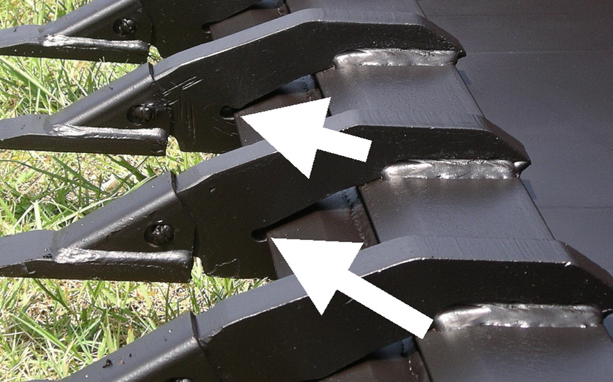

When I was out at the GET dealer, we tried a dozen different styles of 230 series adapters and only one was a great fit with my cutting edge and a 1/2" bar.
One of my fears was that a prefabbed TB would not fit as well as I would like, hence this DIY project.

The fit of the adapters is one of my concerns with building my own. I can't think of anywhere locally where I'd be able to get my hands on them to check them out so its going to be an order and hope situation. However my cutting edge has some wear on it anyhow so none will probably fit the same across the edge anyhow. I was looking at these, if the link works, http://m.ebay.com/itm/6-PENGO-BUCKE...ITS-ON-MOST-/171077539825?nav=WATCHING_ACTIVE

With the adapters I selected the 1/2" bar will fit flush with the bucket and the adapters.
Also a good snug fit with my 5/8" cutting edge.
One thing the GET dealer mentioned is that you want a slight gap between the tip of the cutting edge and the adapter... good example in photo.
A couple of the TB manufacturers I spoke with also said that the bolts could be only snug and it would not affect the rigidity of the TB.

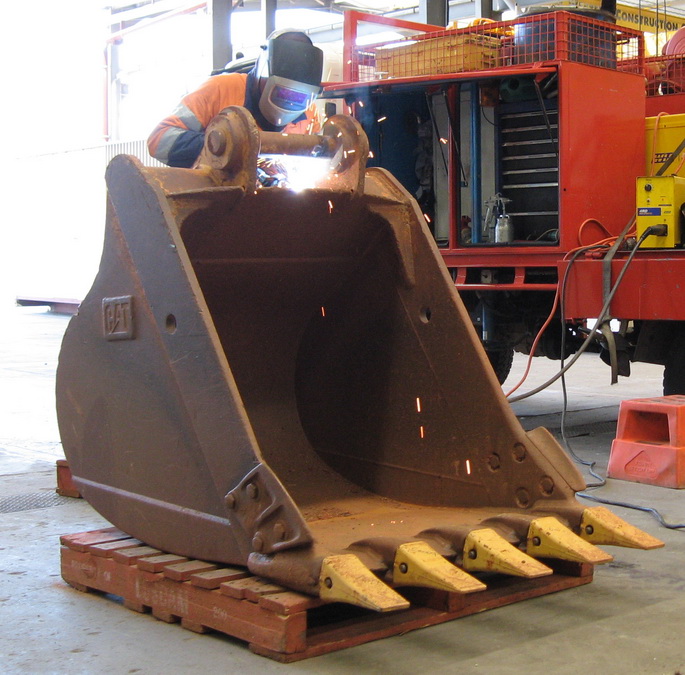

I don't think there is any doubt that adapters properly welded onto a bucket are stronger than a tooth bar.
Emphasis on "properly welded". The GET dealer told me it would take an entire day to weld on 5-6 adapters when you take into consideration all the preheat and slow cooling steps required to weld hardened steel.
I bought 7 weld on adapters and welded them on to my skid steer bucket. It is a tracked machine with a 6,000 lb breakout force.
I didn't do any special procedures just welded them on with a 6010 root pass and 7018 cover. No preheat and no special cooling. This was a few months ago and we have used the snot out of it since then. I haven't broke one off yet. I put all 7 on in 1-2 hours.
Ok... you've convinced me !!!
Thanks for the information.
I've only put 30 hrs on it in almost 2 years, so I guess I'll stop worrying about and get it done.
I laughed when I looked at the breakout force for a medium sized CAT loader and my Ingersoll.
I think the preheat/slow cool process might be a bit more important for something that size.
