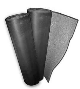

We used dense material for sound insulation in HVAC systems, there are a variety of commercial brands. This would be similar in installation as the bubble wrap but would give better acoustic resistance.
Acoustic blanket - Vicoustic

As used in cars, felt is good for sound deadening.
Not that I have tried it, but I would believe the self adhesive roofing underlays that replace felt paper would also be very good.
I did in past get involved in soundproofing small aircraft.
Different materials are used for different sound frequencies.
Lead is best for very high (like turbine whine) and dense foams felts etc for low freq.
