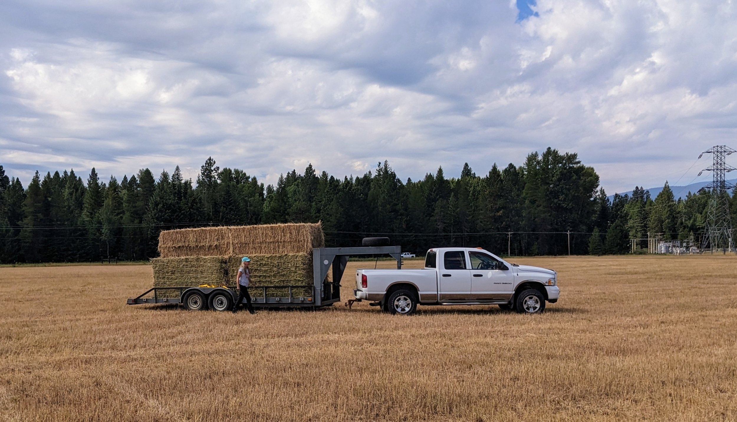

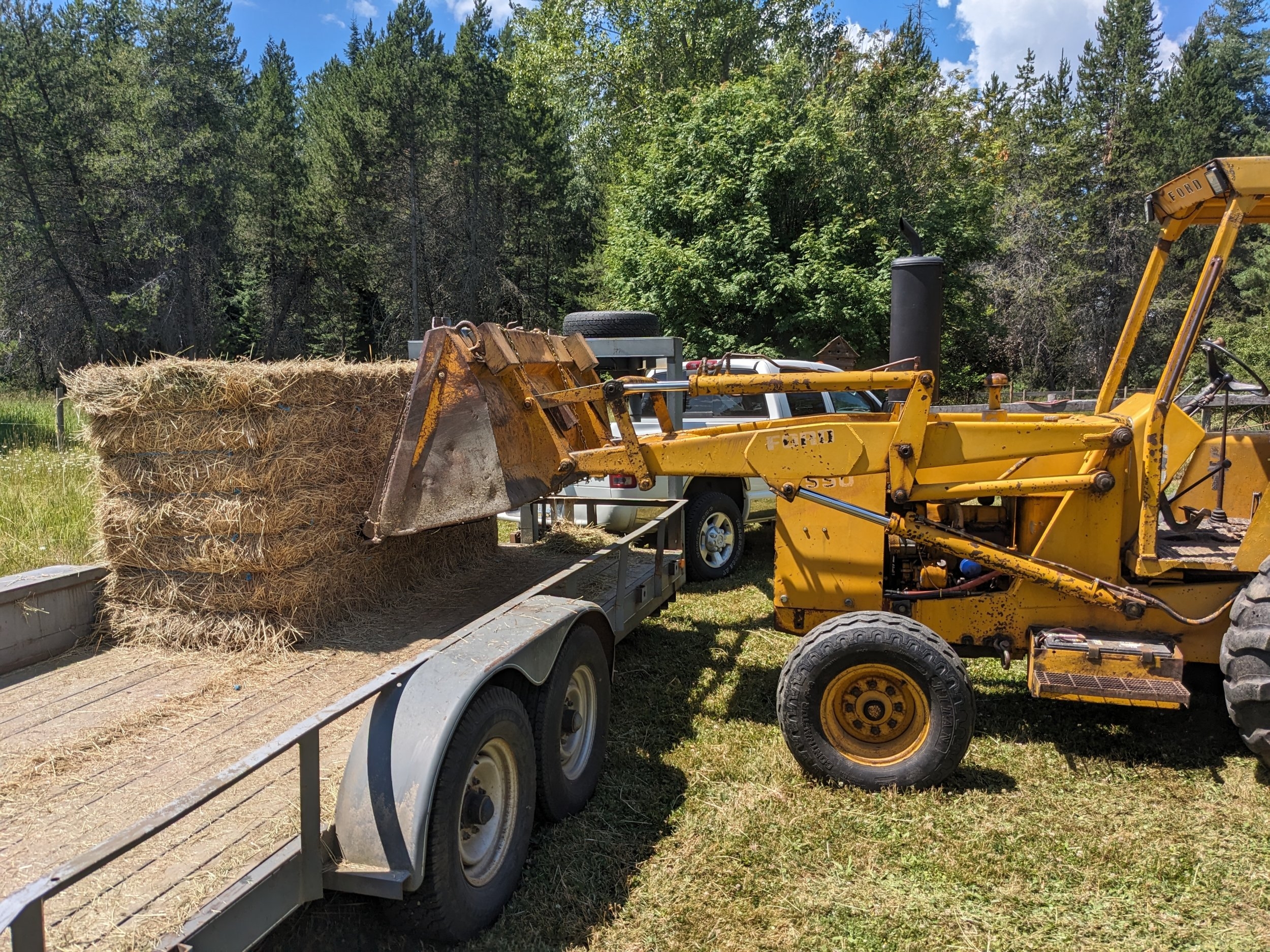

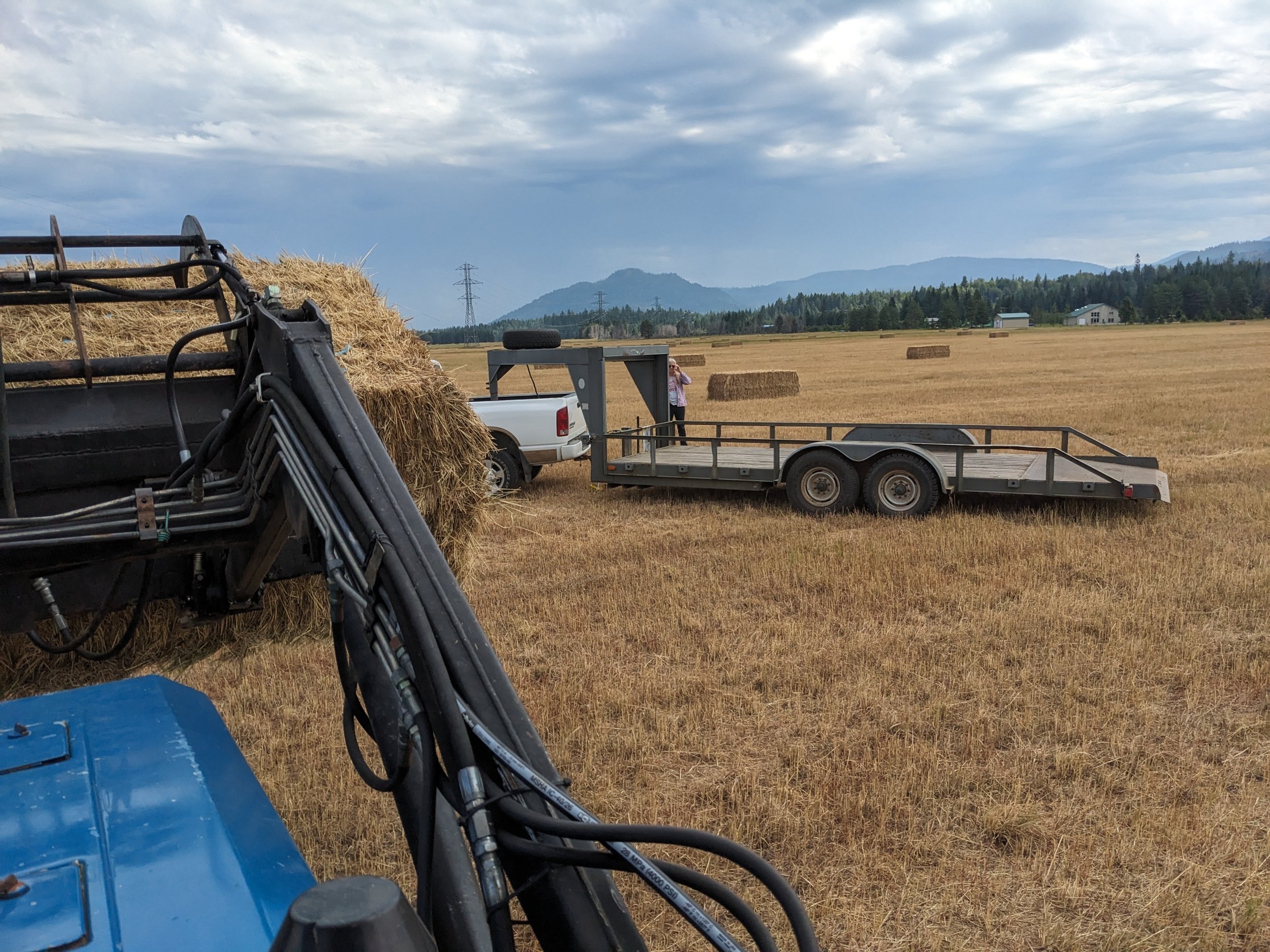

Update well the hay is Home and my plan to use two tractors worked.
Transported the Rhino to the hay field and then loaded 6 bales on per load using the Grapple by removing all but 4 round tines.
Once home fired up the TLB and unloaded the trailer.
Round Robin till the final trip picking up the tractor.
This bale spear attachment works great!
For the first time I was also able to completely unload the trailer from just one side because the 550 has such a great reach with the FEL
ps. after cleaning up pallets and putting down some 3/4 minus in the barn with the Rhino tractor, I decided to do all of the placement and stacking with the TLB and this Neat attachment.
Things must have gone well because my wife even commented "You are getting pretty Good at that!"

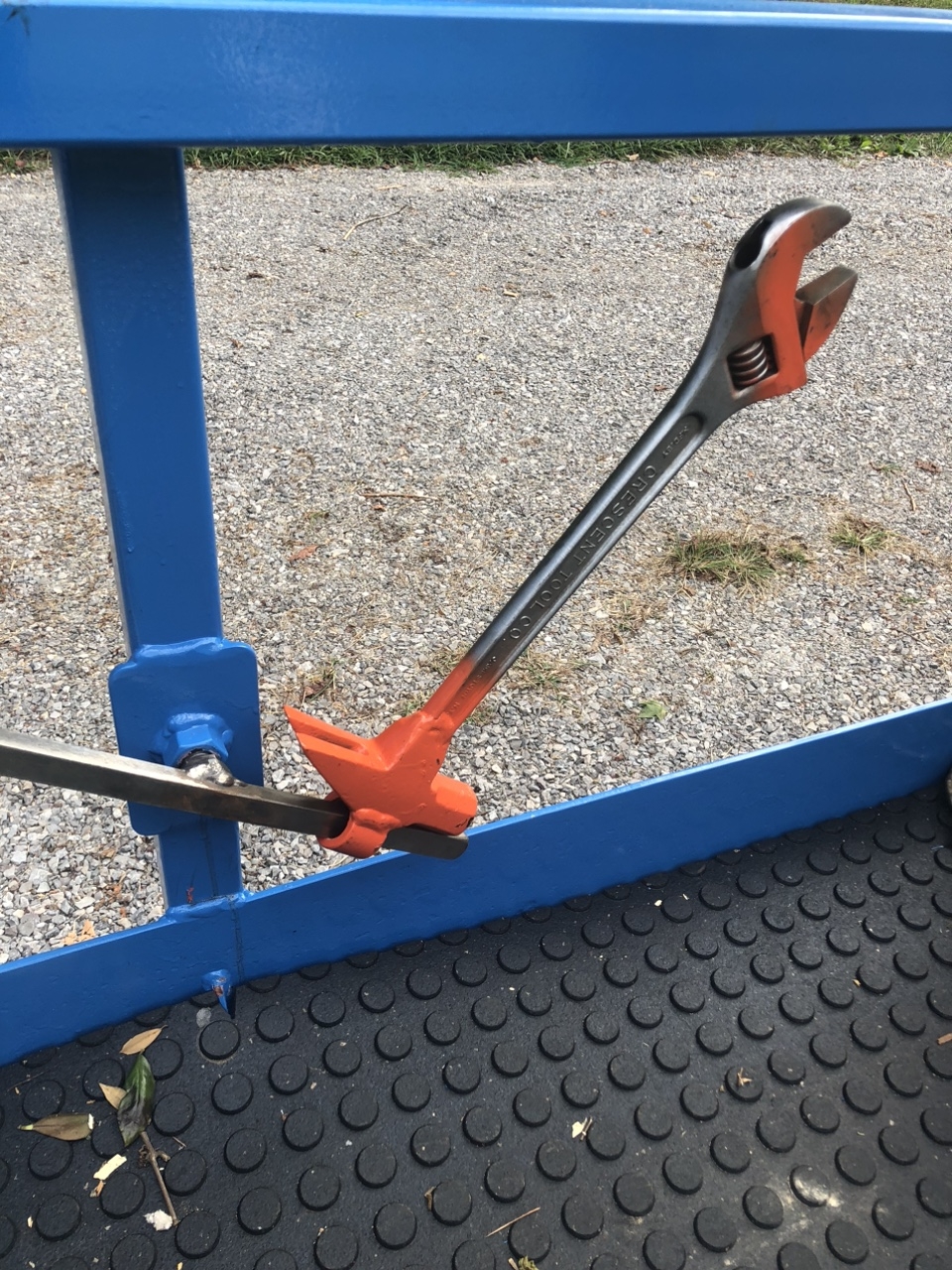

Have welded a short piece of thick wall tubing to hammers to easily tighten jam type screws on bucket forks or attachments. Also helps as a fulcrum when tightening fence wire.

“If it works for you, it works for you” someone once told me.
I think the backhoe buckets are built so strong, that type of spear would work.
Probably tear-up a normal farm tractor bucket.
