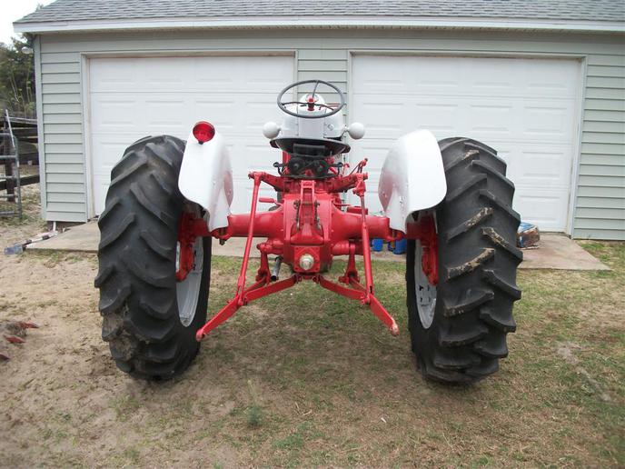

I put it back together having replaced all the other lines, but still using the original one that is missing. I installed fresh UTF ( napa premium heavy duty that meets m2c134 spec). It took some cycling but all the functions work. It is pretty noisy...kind of screechy...kind of a bypass noise. But it goes up and the bucket tilts. The fluid was immediately cloudy so it looks like another flush will be in order.
I can't get a good reading on my generator. Putting the meter accross the battery resultd in a constantly fluctuating reading. Won't register at the genny either. The meter works on my car battery...so i think it is good.
Lastly the 3point works but occalates when up. Fluid level looks ok.
Thoughts?

water in the oil will make it cloudy.
hit the drug store and buy a couple pints of 90% rubbing alcohol and dump it into the sump.. it will disolve the water and then when you work it, it will flash off easier.
tight pins make a screeching sound .. pretty common.
lift getting tho the top then bobbing is common of a small leak int he high pressure circuit, then leakdown, then circuit regen from the unload valve.
not a bad issue unless the hunting gets bad or it is not strong / fast enough due to leak volume.

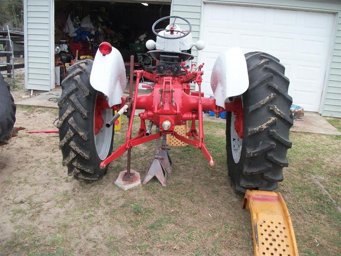

I think the meter might be the problem. With the tractor off the battery is at 6.4 volts. Running i just can't get a reading....so it seems to be charging none the less.
Found out why the power steering is losing fluid. A cracked line that appears to be copper...that will have to go.
