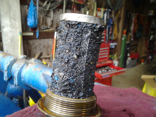

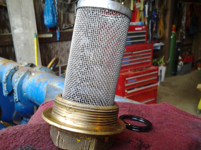

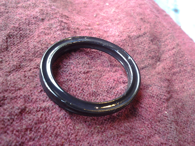

Located and cleaned the loader filter. Also found this seal floating around in there. It is smaller than the filter so i'm not sure where it came from.

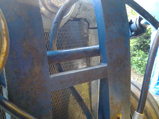

I also built a simple grill with expanded steel to protect that expensive radiator.

deffintely looks better clean!
