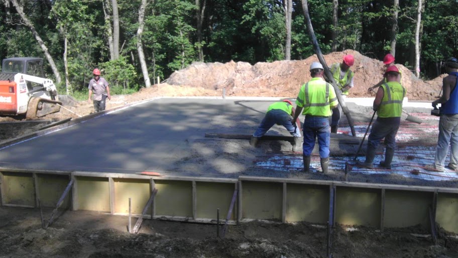

Been too busy to post. Here are some updates in order:

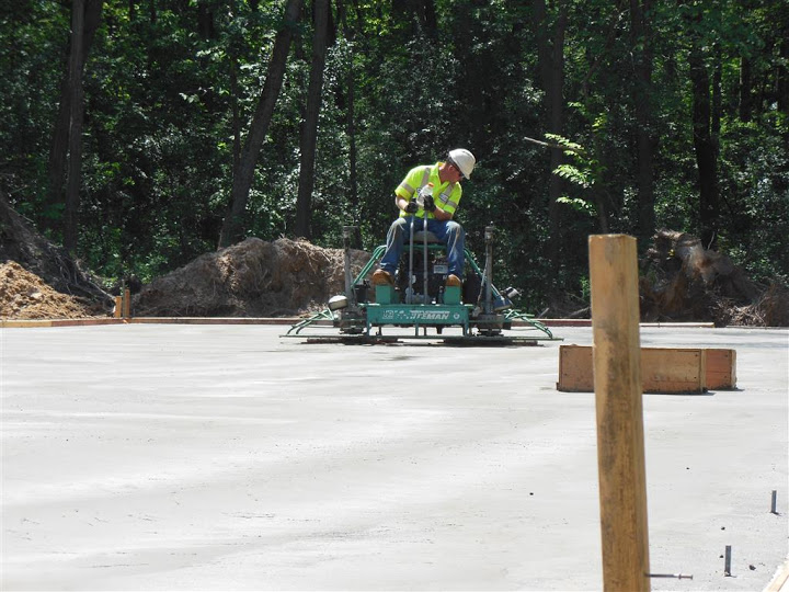

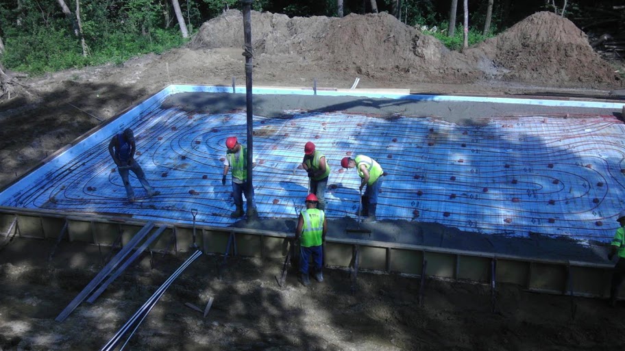

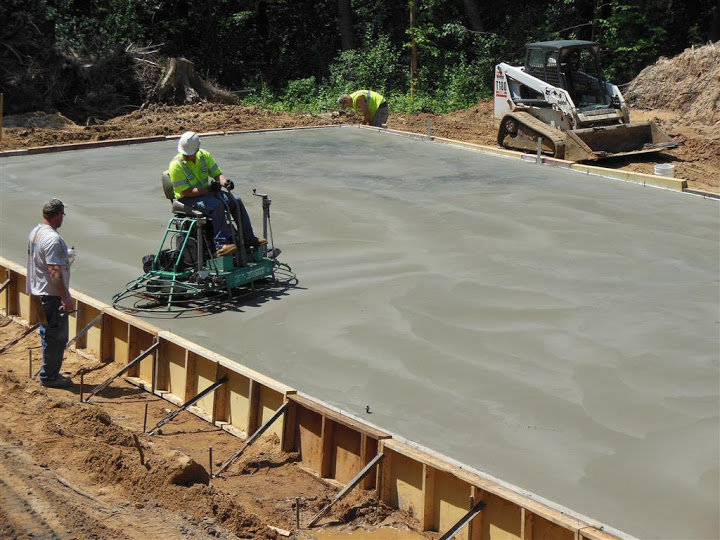

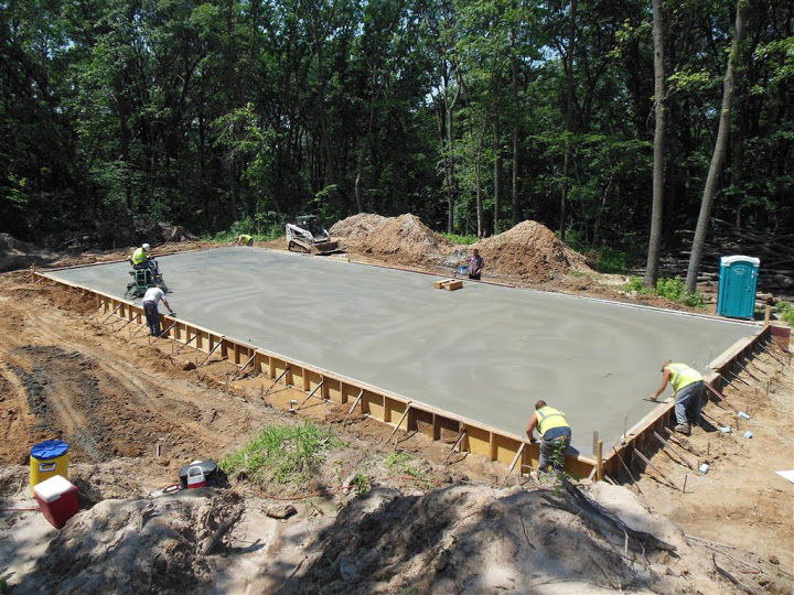

Shop slab pour:
Pouring_shop_slab%u00252520%u002525284%u00252529%u00252520%u00252528Medium%u00252529.jpg
Pouring_shop_slab%u00252520%u002525285%u00252529%u00252520%u00252528Medium%u00252529.jpg
Pouring_shop_slab%u00252520%u002525288%u00252529%u00252520%u00252528Medium%u00252529.jpg
Pouring_shop_slab%u00252520%u002525289%u00252529%u00252520%u00252528Medium%u00252529.jpg
I have gotta get me one of these!
Shop_slab_pour%u00252520%u002525282%u00252529%u00252520%u00252528Medium%u00252529.JPG
Shop_slab_pour%u00252520%u002525283%u00252529%u00252520%u00252528Medium%u00252529.JPG
Shop_slab_pour%u00252520%u002525284%u00252529%u00252520%u00252528Medium%u00252529.JPG
Final product
Shop_slab_pour%u00252520%u002525285%u00252529%u00252520%u00252528Medium%u00252529.JPG

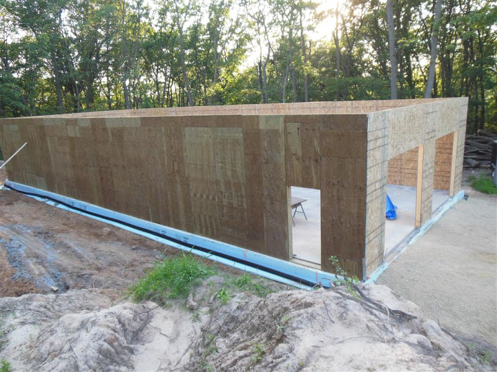

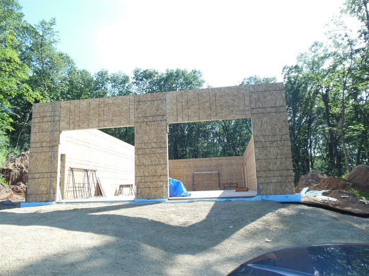

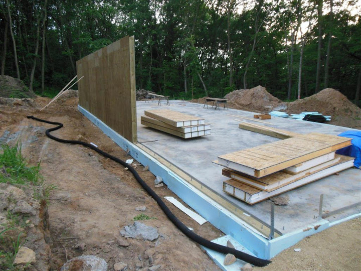

Then the framers started on the SIPs walls. Took 3 days for the 32x80' shop walls:

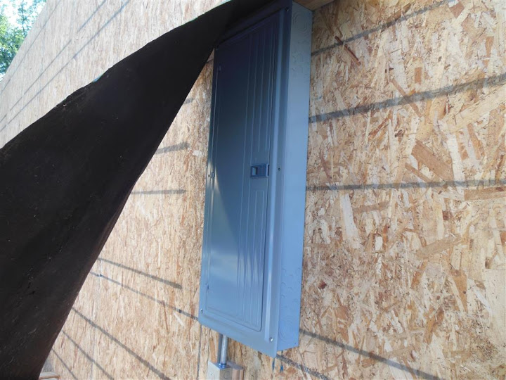

Then I installed the meter socket and main panel

And the power co eventually connected the power (what a bunch of slackers - they were even sleeping in their trucks at 9AM!)

Wow, went up fast! I see plywood was used on the one outside wall, any reason for that?

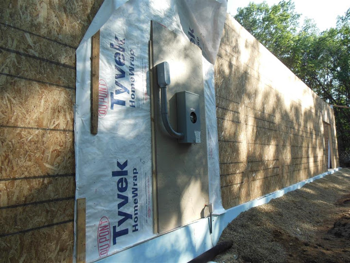

<img src="http://www.tractorbynet.com/forums/attachment.php?attachmentid=332661"/>
<img src="http://www.tractorbynet.com/forums/attachment.php?attachmentid=332662"/>

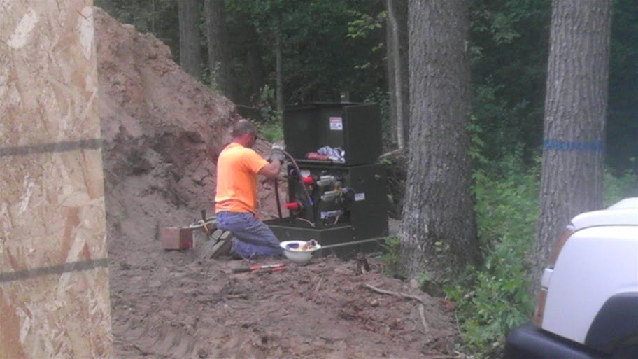

<img src="http://www.tractorbynet.com/forums/attachment.php?attachmentid=332663"/>

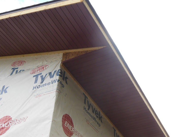

And some soffit
<img src="http://www.tractorbynet.com/forums/attachment.php?attachmentid=332664"/>

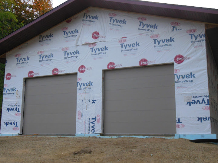

And garage doors
<img src="http://www.tractorbynet.com/forums/attachment.php?attachmentid=332665"/>
Looks good!
Any reason you put the doors on the short wall?
   / A(nother) Home in the (different) Woods
#125
Good eye, Pixguy. That one side is actually made from foundation SIPs panels instead of the regular above-grade type so it has treated plywood on the outside and treated studs inside it. They just finished backfilling on Fri (no pics yet) but that wall is now below grade about 4-5' now. That had to do with the hillside it was cut into and how it all fit.
That is the same reason for the doors on the end - I was a bit constrained by the site location here in that I am close to the setback limit and trying to work in a flat spot (well flatt-ish - there is no "flat" on this lot). This was how it fit. Plus the design has it broken into a front garage section and a rear shop section, and that is the garage section up front (for tractor and my truck). There is another garage door on the long edge, on the downhill face for easy shop access with tractor or whatever.

You can see the exterior finish in the electric meter install. It is LP smartside stucco panel, which will then be painted. I am using 1x4 sleepers as an air spacer behind that for extra rainscreen-type protection.
