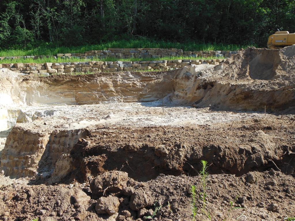

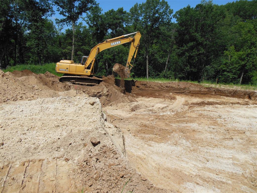

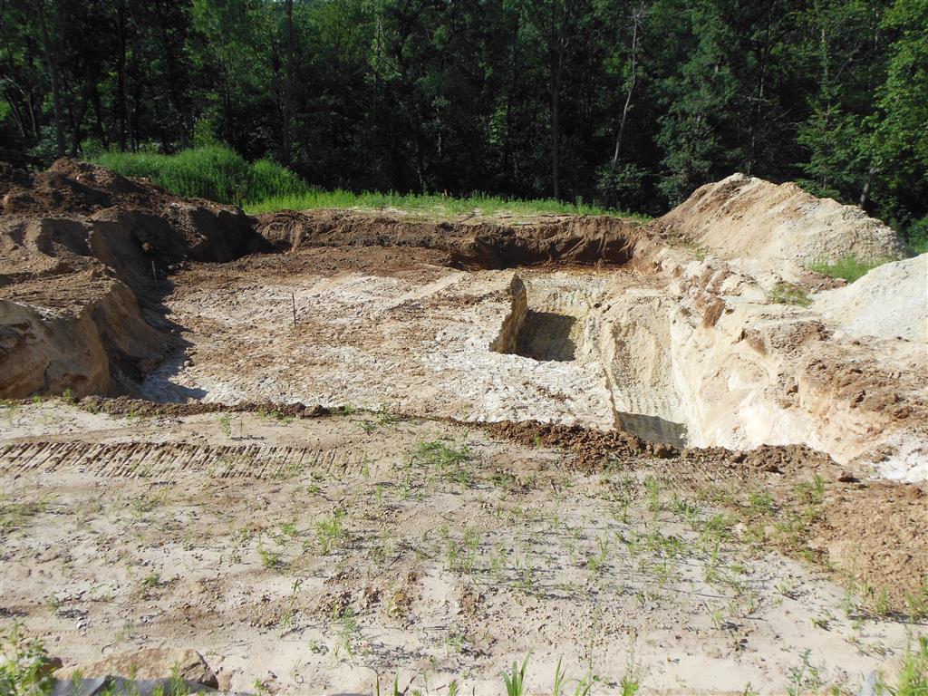

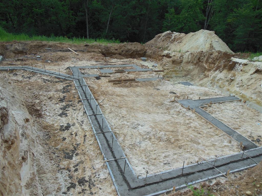

So while I've been spending most of my time working on the shop building, the house site got started somewhat. I had the excavator dig the foundation pad and then the concrete guys go the footing and foundation walls in. Here's a few shots of it.
Digging the foundation

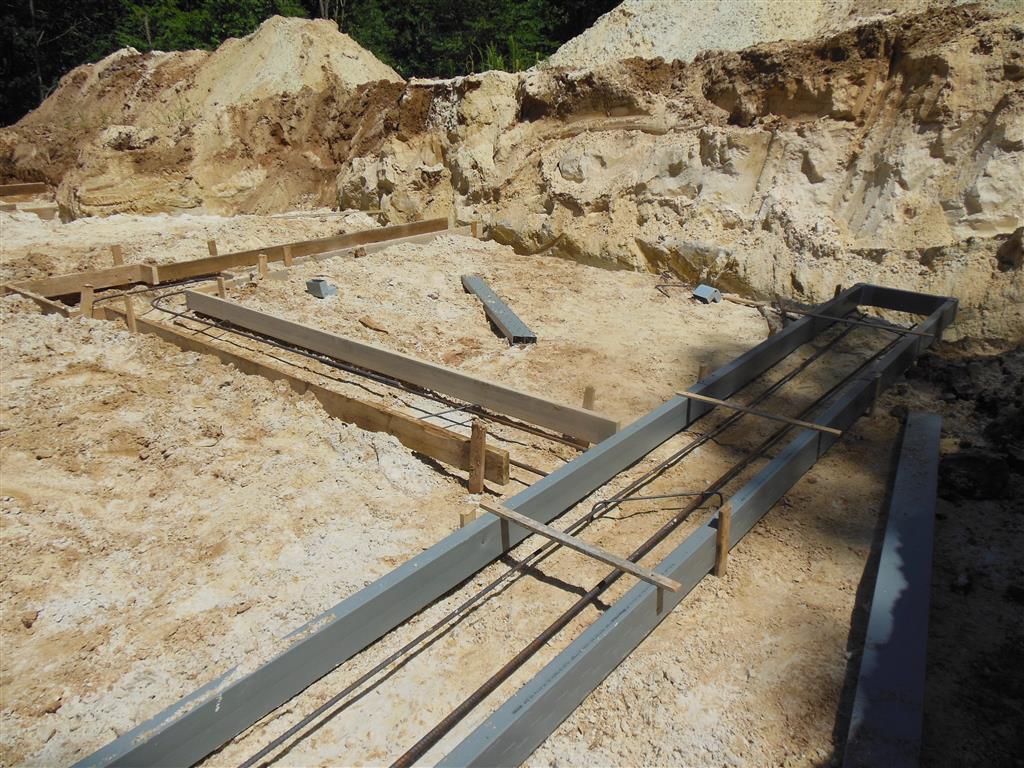

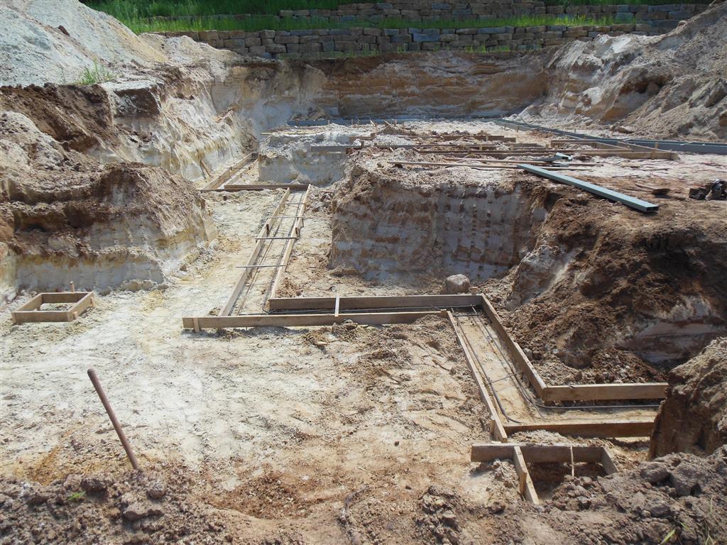

Footing Forms

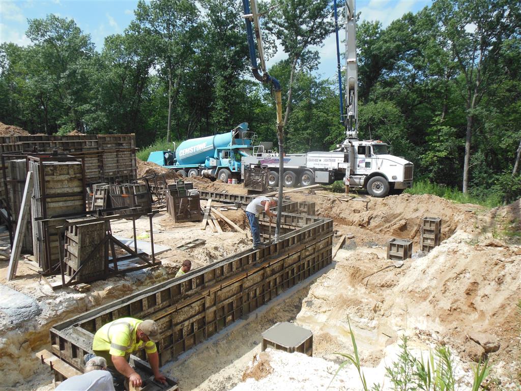

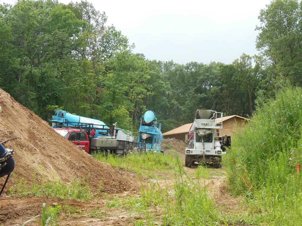

Pouring the footings
2 different concrete companies on the same site!! Fight! Fight! Fight! :laughing:

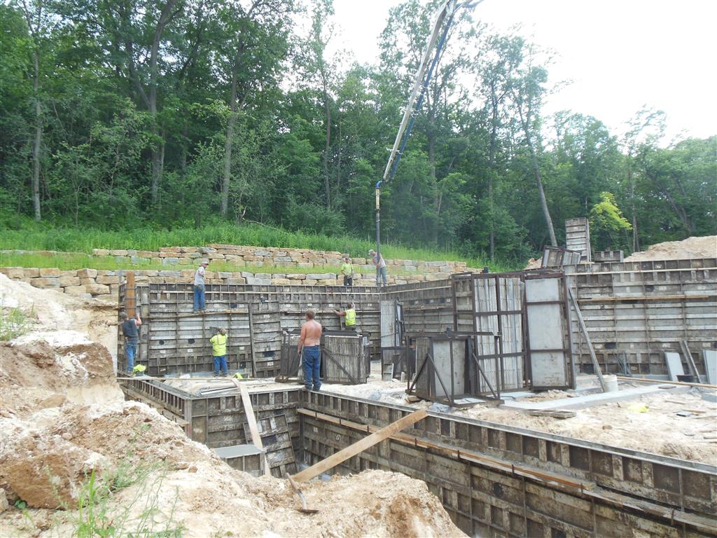

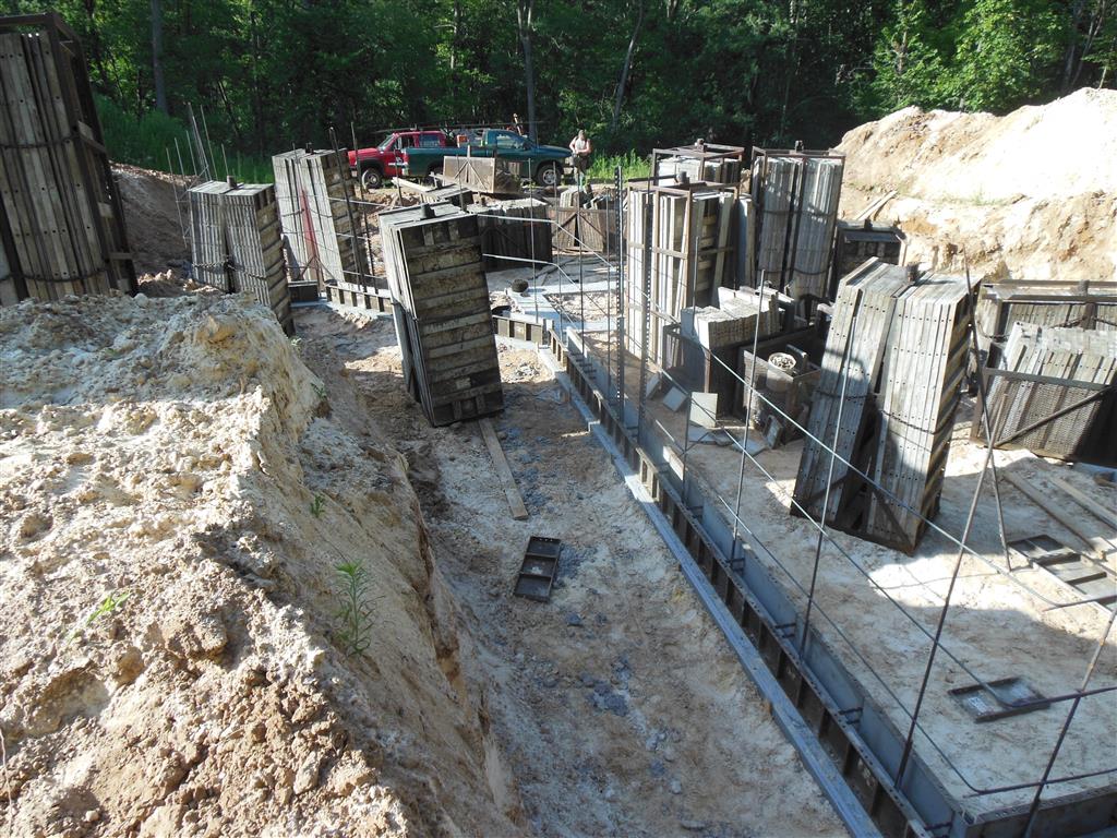

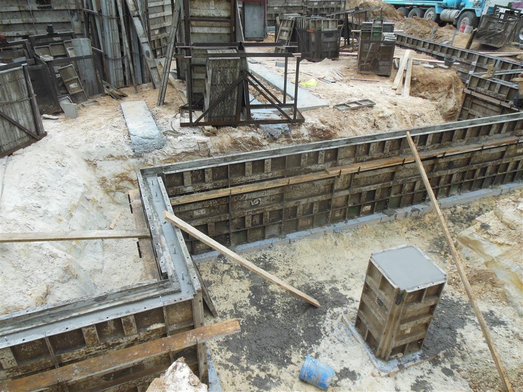

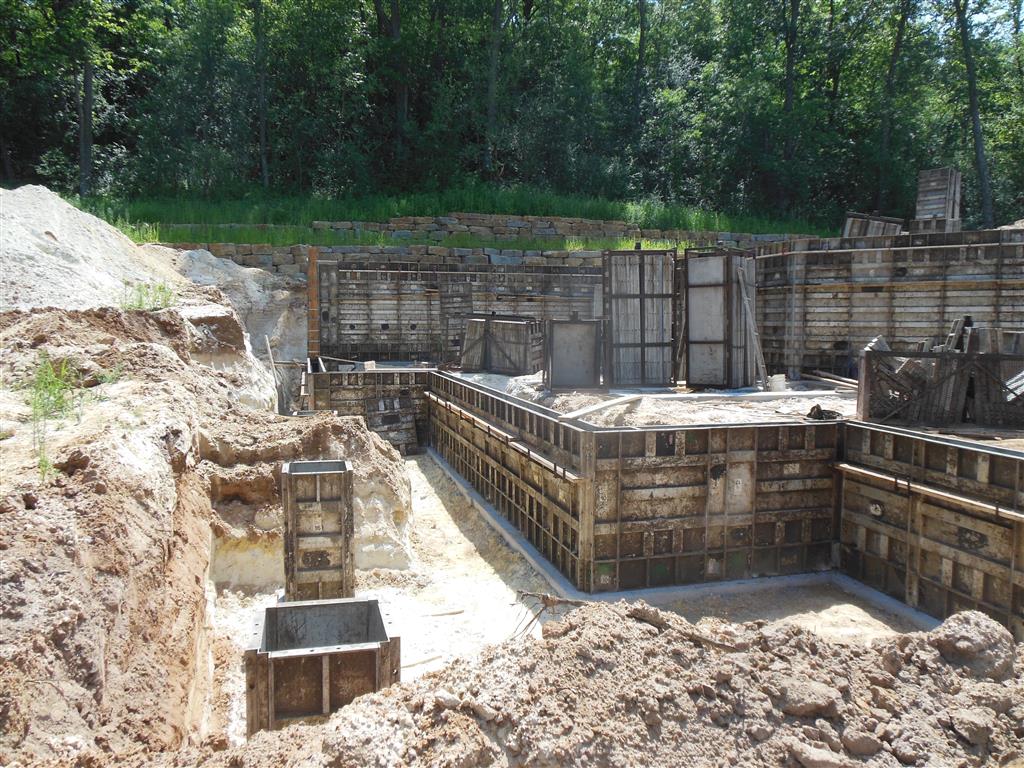

And then the walls. This is about 50% walkout, so half of the walls are just frost footings below grade.
Forms out the wazoo!
All ready to pour. Minor detail here in that I showed up a bit late and there were concrete trucks already on site. I asked the crew where the step (essentially a brick ledge) in the footings were. Got the blanks stare and then the foreman went "oh SHEET!" and they had to scramble to get that in place while the trucks were waiting. They were about 10 seconds from starting the pour when I asked that. Just in time!

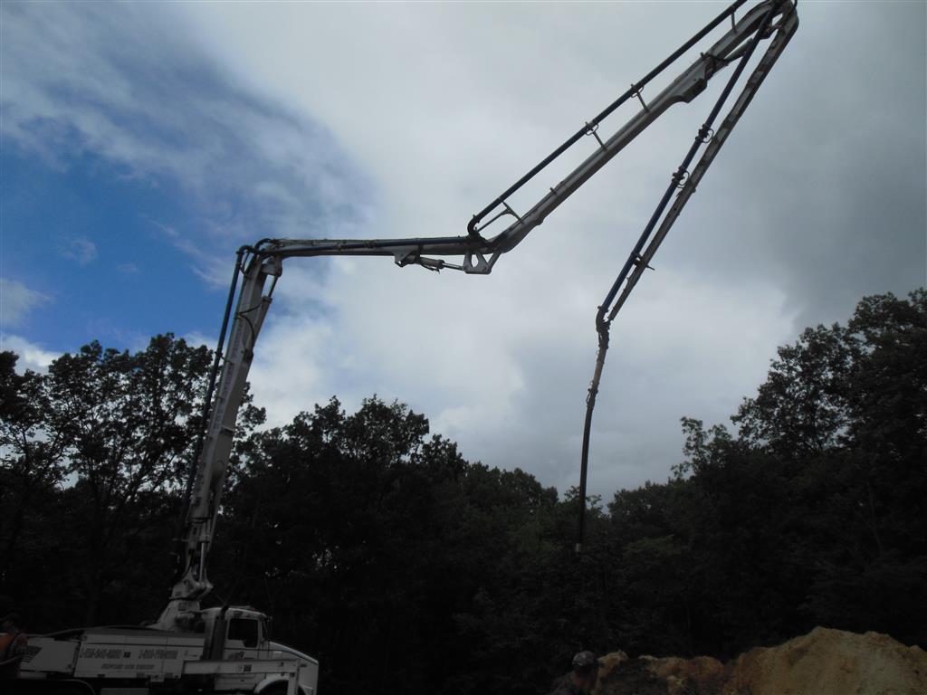

And the pouring with the pumper truck again. They prefer to use that for just about everything they do as it saves a ton of time, so they actually split the cost with the customer.
That's about it for now. Working on drywall on the shop now that we passed rough electric and framing on that building. Trying to wrap up drywall in the next couple weeks. SIPs panels for the house have been delayed so we have been waiting for those to show up. It looks like we may get them finally on Aug 30, so we can start moving forward with that, hopefully in time to get it enclosed before the snow flies....
