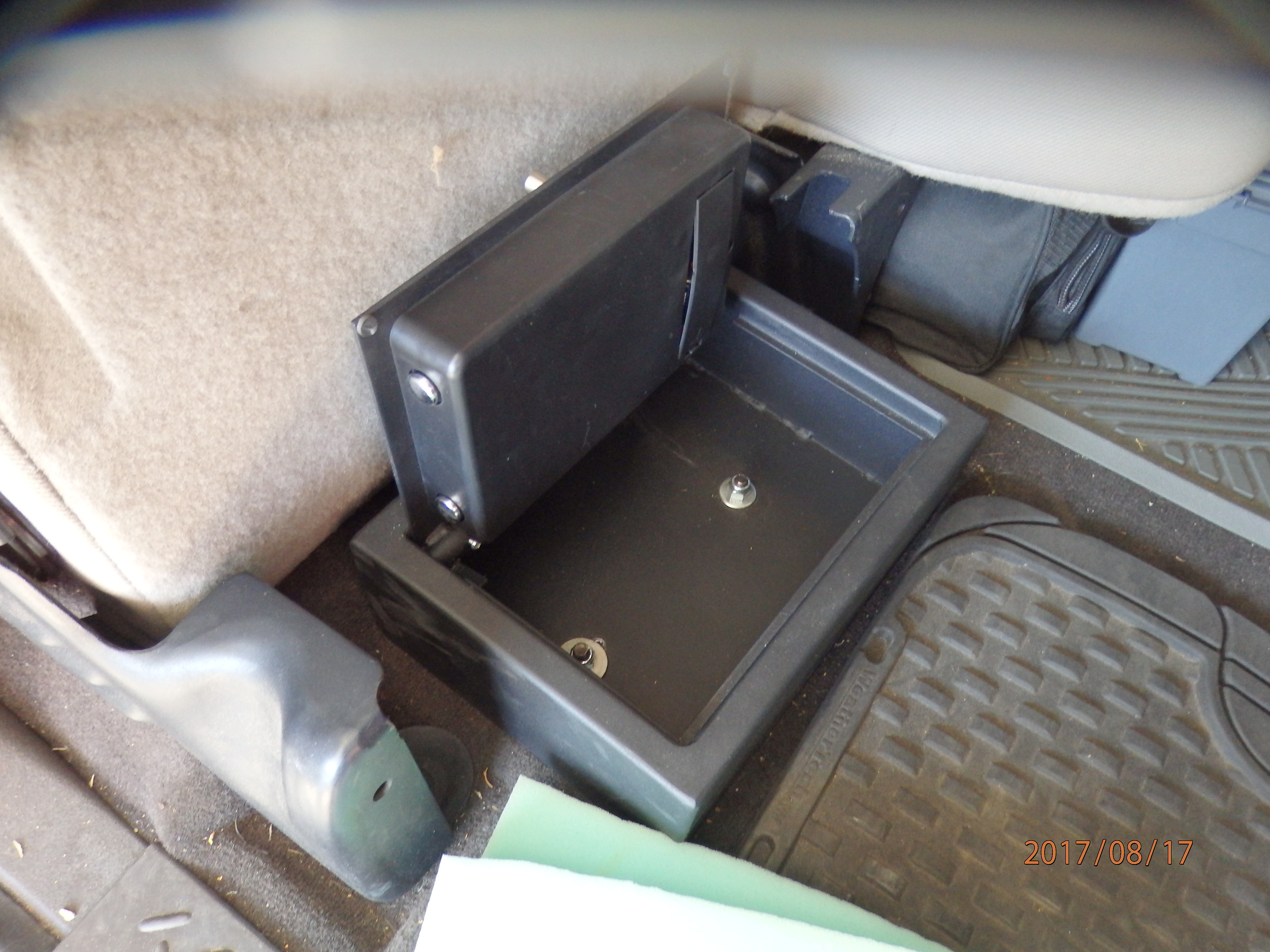

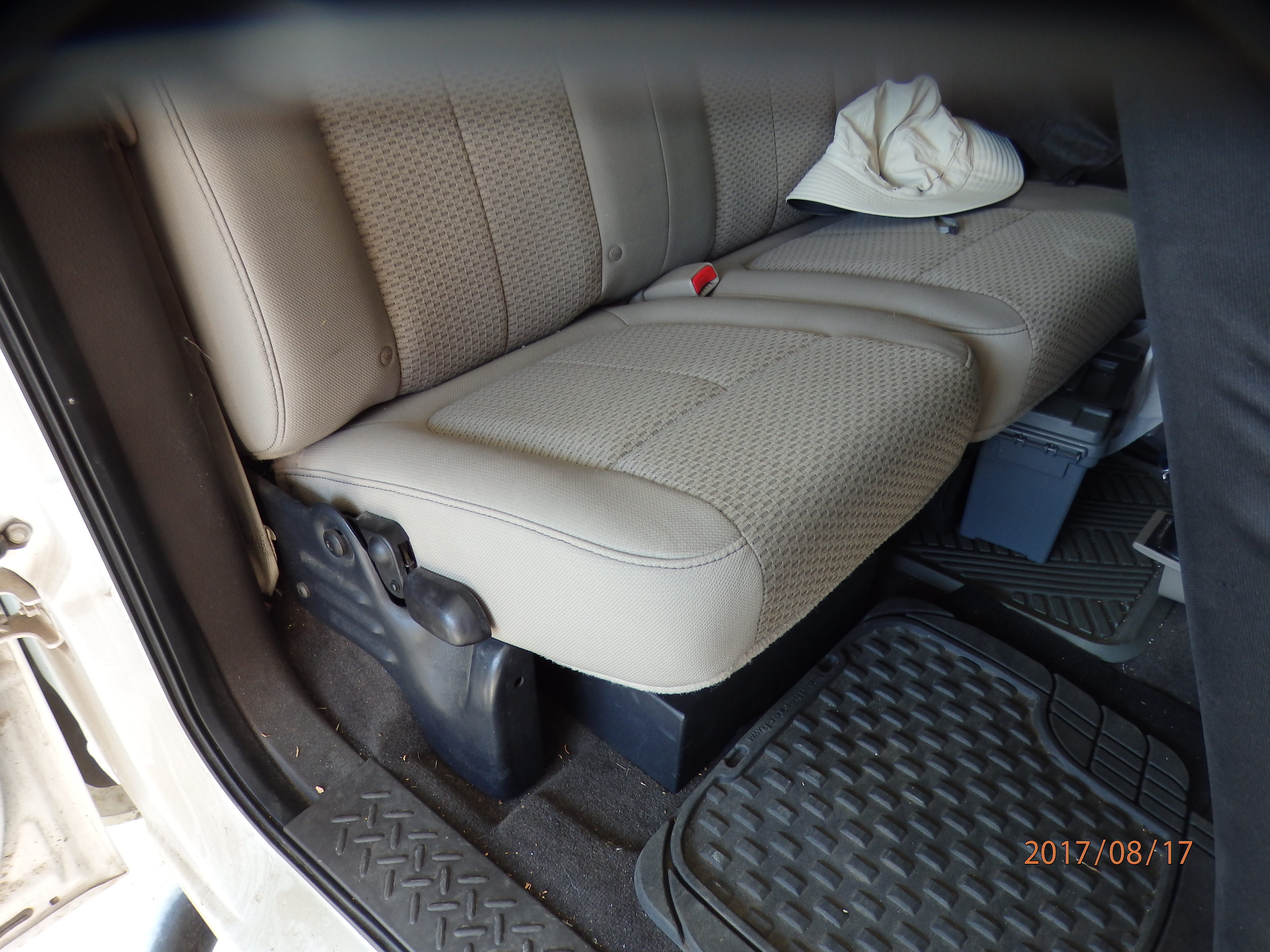

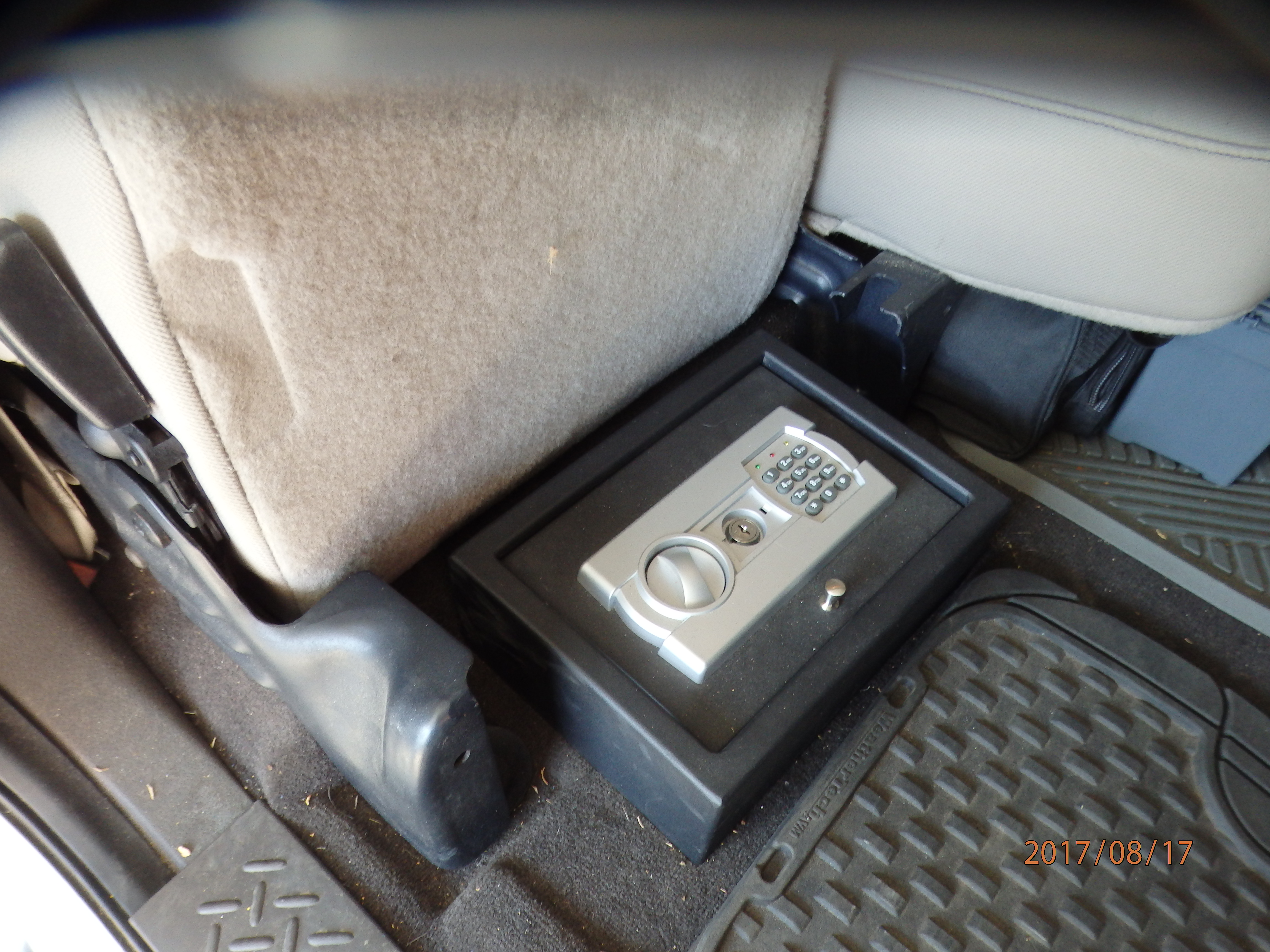

I like it. I am also interested in your mount under the rear seat of you're F150. While I use the center console and the rear seat is not easily accessible, still would like to know your method.
Okay, I took a few photos and will try to attach here. First, I have an extended cab. The safe was not made for installing in a vehicle, but is doable. The safe is mounted under the narrower of the two rear seats, each of which lifts up. The safe had two holes in the bottom for mounting. After marking two holes underneath the rear seat using the safe as a templet, and after carefully checking to see drilling there would not cause any issues and that I would have sufficient access to push bolts up from the underneath for small bolts, I drilled two holes. I stuck carriage bolts in thru the underside and into the cab - using large washers on the underside to fit over and handle the square part of the carriage bolt just below the round head. I used duct tape to hold the bolts in place while I went into the cab to stick the safe over the two bolts. Then, used lock washers and nuts I tightened the bolts up and the safe was secure. I use a couple pieces of foam to protect contents from the bolt heads which protrude a bit into the save - could also use acorn nuts as well.
It would take a very ambitious thief to try to pry it out from the inside, or try to unbolt the round headed carriage bolts from underneath. Also, I cover the safe with a bit of black trunk liner fabric so the safe is not readily visible even if you lift the seat.
This is used when I need to leave the gun, or anything else (if small) of value for a short time. When I am in the car and carrying, I keep the gun on me, concealed.

Very nice installation.

Thanks for sharing... looks like a nice solution and install.
