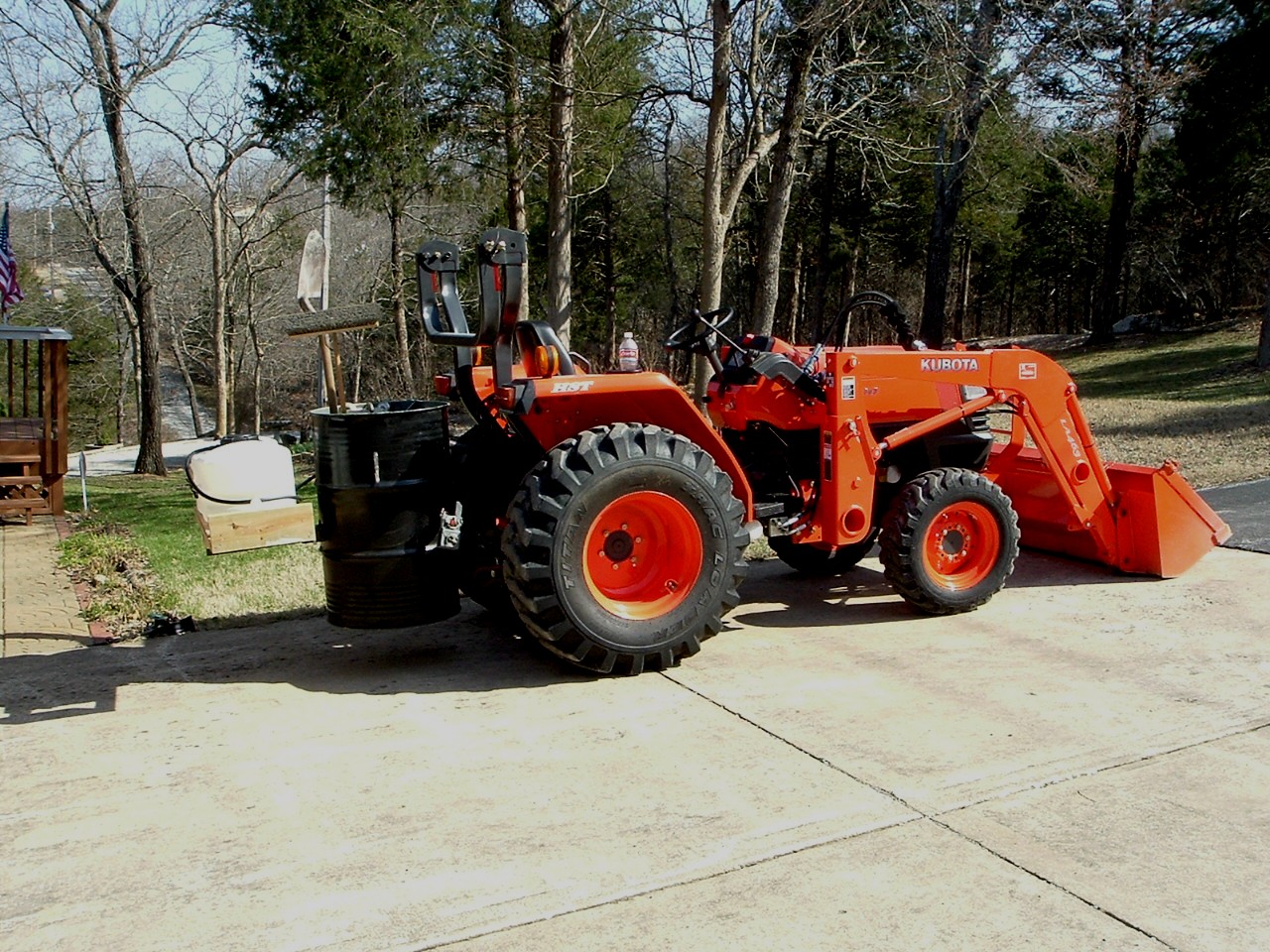

A cheap three point counterweight for my tractor I made consists of a plastic 50 gallon drum, with a piece of all 3/4 inch all-thread run horizontally through two sway bars running vertically purchased at TSC ,and then the drum filled with concrete. Works great!

what is the height from the bottom of the drum to the ground w/3PT all the way raised?

Why do you have the top link so high? Looks like it well do some bending when you go up with it.

The drum works fine with no bending. The metal bars already had pre-drilled holes and I went with them since I did not own any metal bits that large, they certainly could be lower. I first began by placing the empty drum flat on the ground and then backing tractor up with the lower hitch sides level and centered on drum and then marked holes. I then drilled holes and ran all-thread through first hole and then through both sway bars and then out the other hole. I then fixed the top bar of the hitch and verified that it worked. Filled with mortar (less weight than concrete) and presto a counter weight was born for under $50.

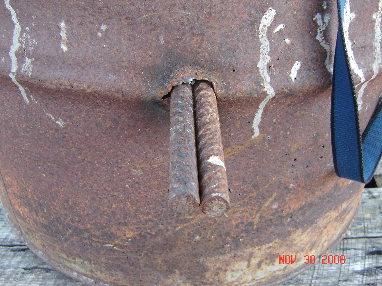

Mine weighs about 800lbs

I cut an old steel drum in two halves. Inserted two #5 rebars and filled the halves with concrete leftover from pouring some piers. I hang them from the 3-point after retracting the drawbar. I weighed the 1/2 drums and each one weighs 590 lbs. Usually I use just one, but I could stack them on my heavy duty 3-pt carrier if I needed 1180# of counterweight.

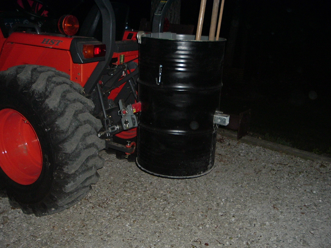

Here is mine, about 750 lbs with a 2 inch receiver in the back, and 2 inch PVC tubes cast in the concrete for handle tools. and lots of room for chains and other things in the top.

Got more photos??? Interested in how you did the Toplink... I'm going back and forth from 55 gal. drum to a loaded pallet.
