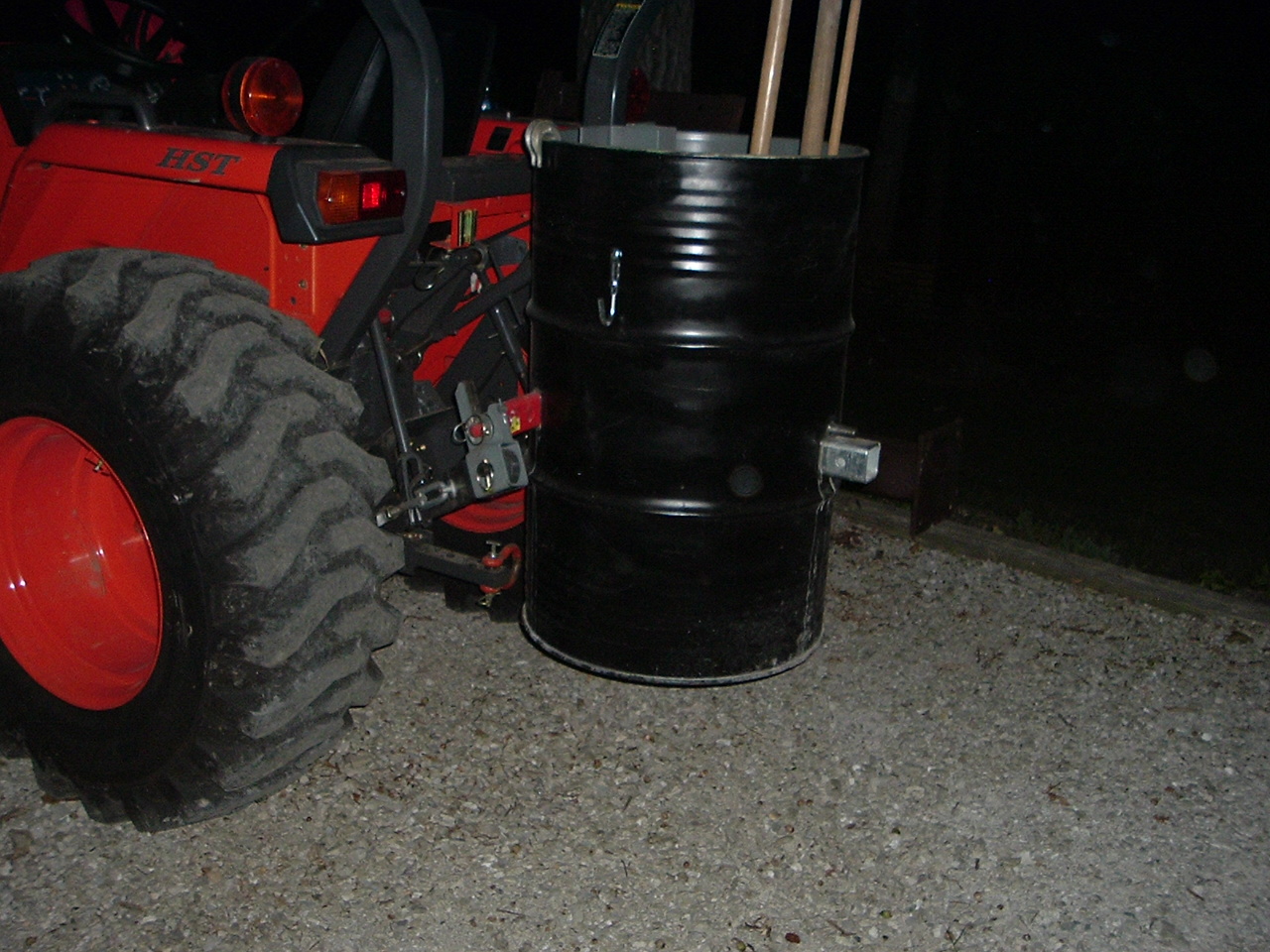

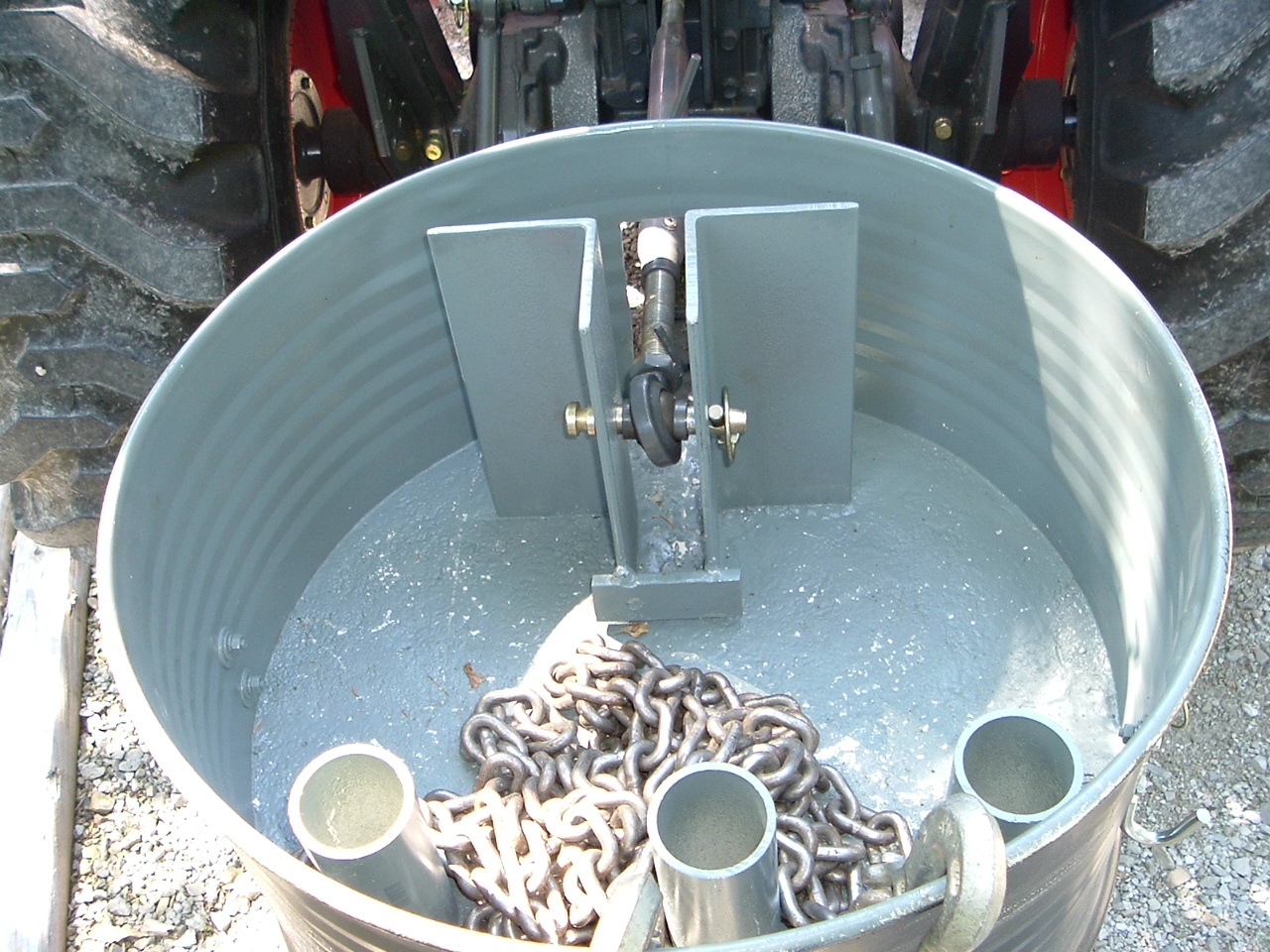

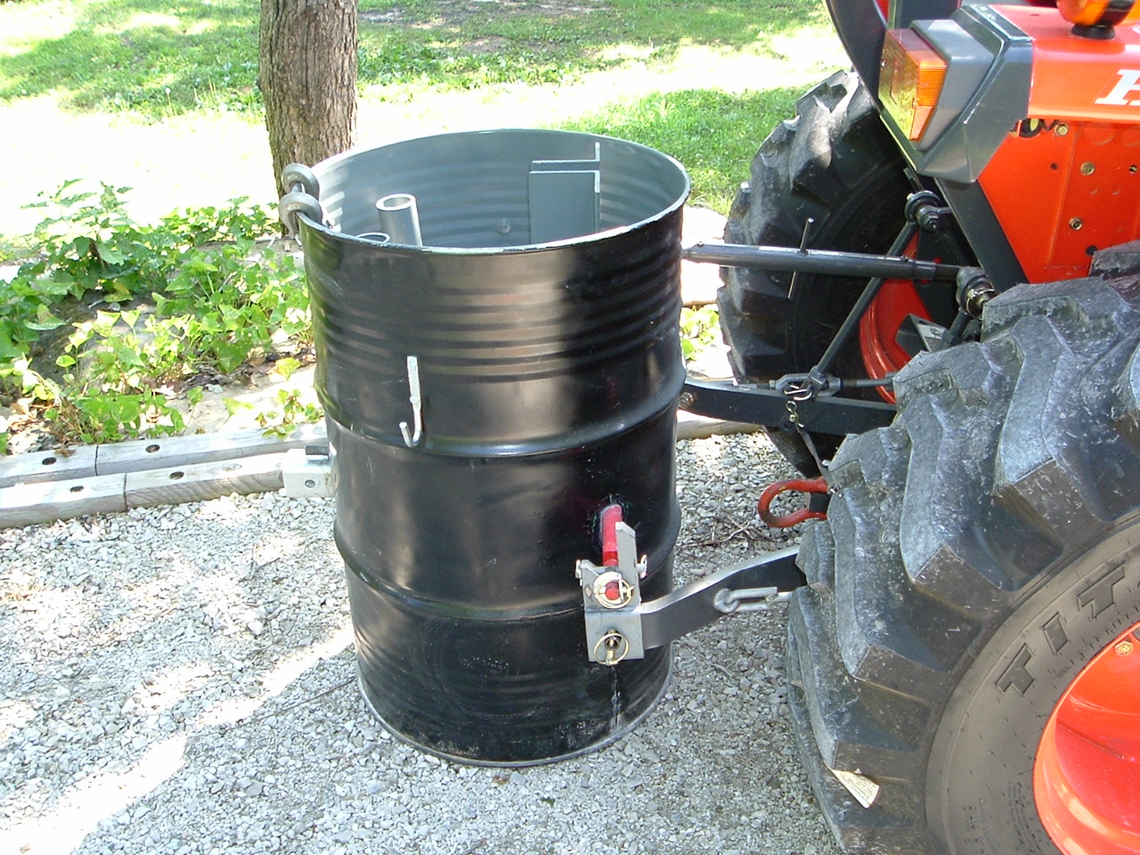

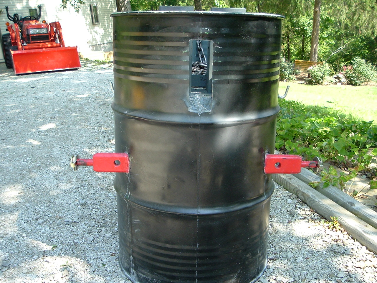

I did the 55 gallon drum too. I used a set of 7/8 pins from TSC for the lower arms and just used some scrap steel to make a top clevis. I put the lower pins in the center of the barrel so it doesn't stick out too far. The pins are threaded and came with nuts. I welded the nuts to a section of pipe and placed it inside then filled the whole thing full of cement. I did have a bunch of bags of cement that had set up before being used that got tossed in.
/ A simple three point counterweight #22
Got more photos??? Interested in how you did the Toplink... I'm going back and forth from 55 gal. drum to a loaded pallet.
Here you go, let me know if you need any more. the 4x4 steel angle go all the way to the embeded drawbar and fasten in with large bolts, the 2 inch fastens to the drawbar with a long 3/4 inch all thread, and welded to the 2 inch receiver, and then rebar welded at an angle on each side to the drawbar and the side of the 2 inch reciever for side to side stabilization.

Thanks, yep it makes a world of difference, and the storage for handle tools, and chains is very handy. I have started to use the 2 inch receiver, for the sprayer, after getting 12Volts on the back of the tractor. It was a fun build, all except the welding with my head inside the barrel. The temp was in the 90's when I did that, and keeping the helmet on with all the sweat, leaning over into the barrel was a challenge.

Thanks for all the kind words.
I wired the 2 inch PVC to the rebar,for stability and put about 2 inches of 2 inch rock in the bottom before putting in the concrete. Don't know that it was necessary but was thinking it would allow any water to evaporate out thru the tubes. I mixed the concrete by putting in 2 sacks first then a little water and mixing with a bar of steel, repeat, procedure. I only used 8 sacks for 640 lbs. and the barrel weighed at least 100 lbs with all the steel, and rocks in the bottom. I understand that most of the water weight stays in the concrete as a hydrate. I wanted plenty of space in the top for storage, and it has been very handy for all sorts of tools, clothing and stuff. The hooks on the side are highly recommended also, as a place to hook your chains when still hooked to the drawbar on the tractor, and you are moving to your next tree, this keeps me from having to constantly bend over and unhook the chain. Also great place to hang buckets.

I did not put the weep holes, I though about it, and actually planned on doing it, but decided that the tubes vented it enough. No it is stored indoors, but i do have caps for the tubes in case caught out in the rain until I can get to the barn, or do have to store it out because something else is on the 3pt. The top will not hold water, it just drains out the top-link hole. I have also put 6 inch PVC in one front "corner" for chain managment, and put 1/2 moon holes for water drainage. Not only will it weigh the 960 lbs with 12 bags, but will weigh more as the water will be "locked" up as a hydrate compound from the reaction with the concrete, or so I am told.
