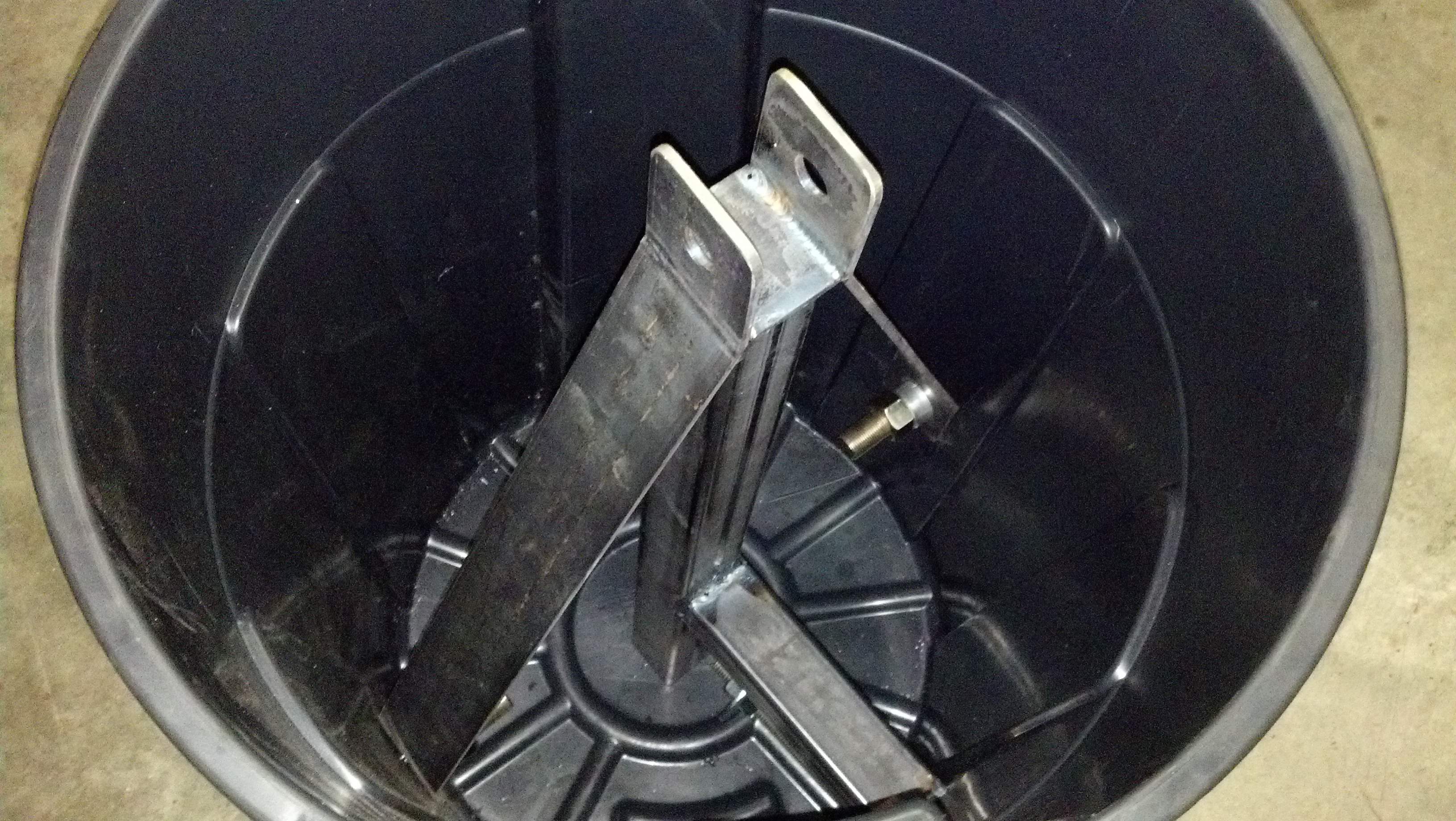

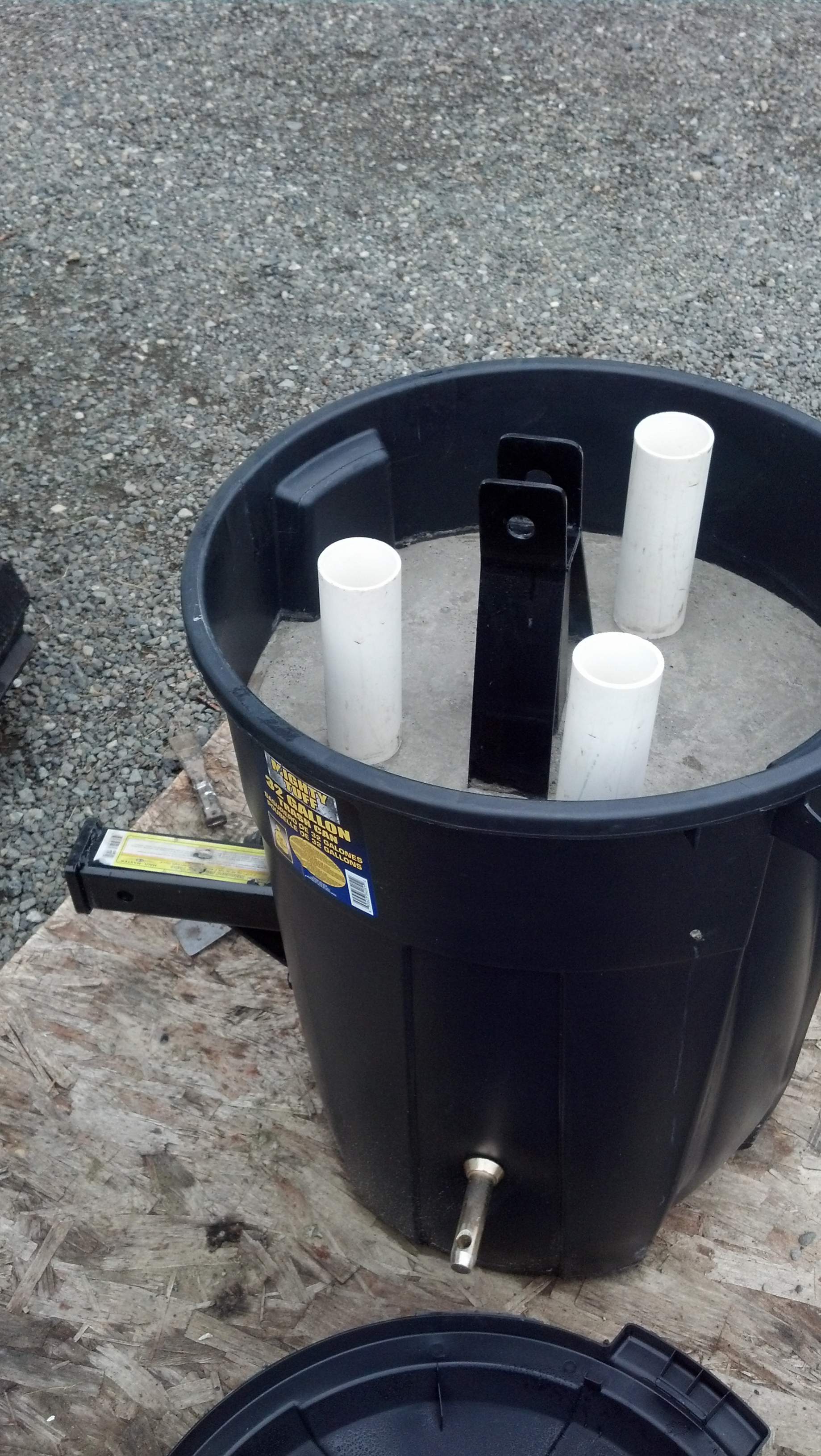

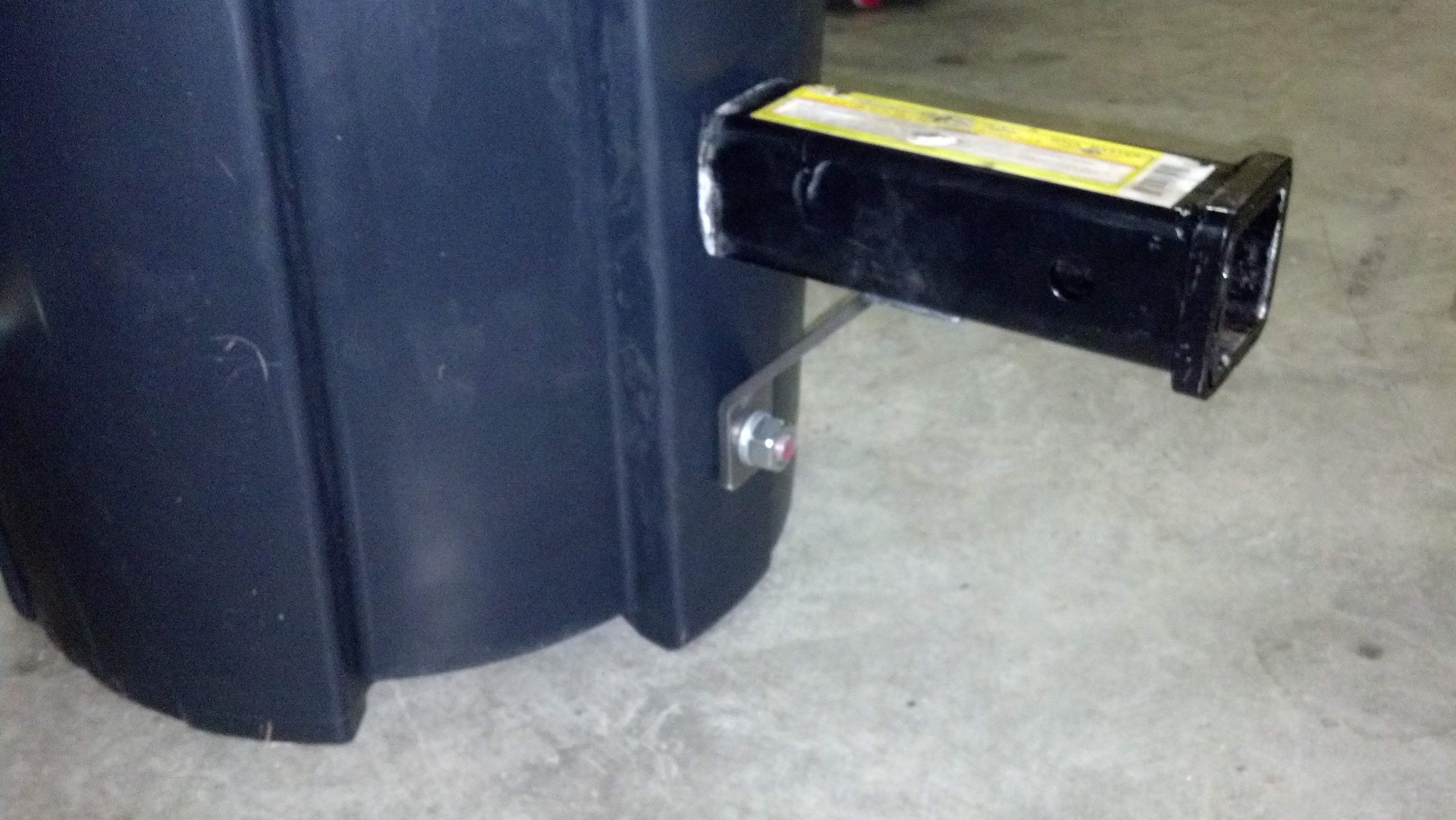

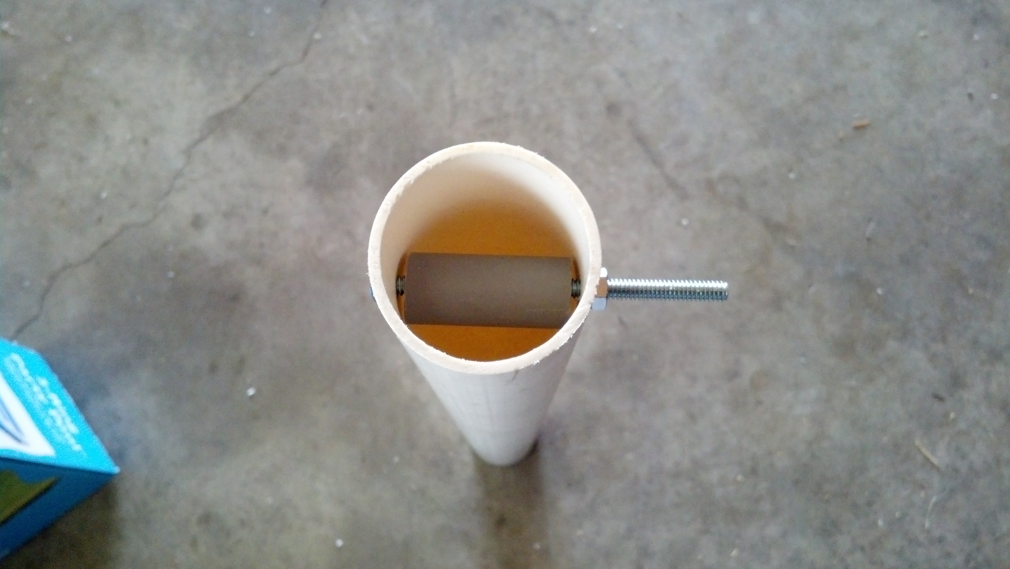

This thread has been very helpful, glad I found it before making my counterweight. I fabricated the frame with 3/16" flat stock and 2x2 box tube. I used a trash can so I could put the lid on it when storing outside. In hind sight I wish I'd have used a 55 gal size barrel due to now having to adjust the sway bars on the tractor. I used threaded pins to bolt through the side of the barrel and lubed them up so if they break or bend I should be able to unscrew them and replace, (in theory anyway). 084.jpg077.jpg081.jpg074.jpgI also picked up a cheap receiver from Harbor Freight and mounted it off the back. The pvc pipes have a screw through them to hold shovels etc as I'll be drilling out the bottom for drainage. I used six sixty lb bags of Quick Crete and combined with the frame the overall weight should be approx 400lbs. That is what my tractor manual recommended for max weight. I might have to cut a slot in the barrel for the stabilizer bar when it's raised. Just letting the concrete harden for a few days before I try it out

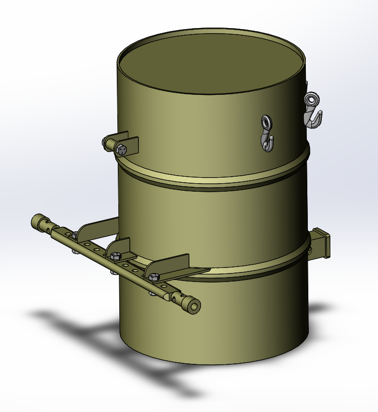

My counterweight is coming along, finally.........
The design:
The build (it's upside down).
This is the back side. It's the "tail" of the center angle iron (that's tied into the drawbar). The reese receiver will be welded under it (or on top, as shown---upside down).
Everything is only tacked in place. Need to verify QH compatibility, probably this weekend. Also needs the receiver welded on and to be filled with rerod. Naturally, concrete will come after all that. We take it to the concrete place and say "when you come back with some extra, fill this up" and they do for cheap (or even free, I think).

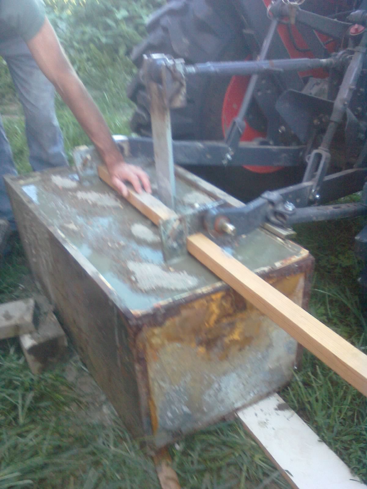

My ballast box is made from an old dorm refrigerator for the form and utilized parts just laying around.
The pic was in the concrete adding stage with various braces for stability. It has worked out ok but I've learned since that it needs to be stored with a board on the ground to tilt it forward a little for ease of re-attachment.
I guess the wt at a little under 500lbs and tractor has tire fluid.

won't the weight hitting your lift arms bind with the 3rd point if you lift it high?
