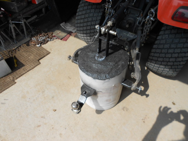

Here you go, let me know if you need any more. the 4x4 steel angle go all the way to the embeded drawbar and fasten in with large bolts, the 2 inch fastens to the drawbar with a long 3/4 inch all thread, and welded to the 2 inch receiver, and then rebar welded at an angle on each side to the drawbar and the side of the 2 inch reciever for side to side stabilization.
James K0UA
This looks like what I need except for the receiver hitch which I don't really need.

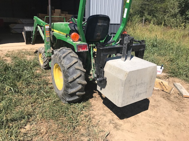

This what i eventually plan on doing. use a 55 gallon plastic drum and design it so i can attach to my quick hitch.
   / A simple three point counterweight #84
assuming I already posted, but that's what I did. Put in rerod. My dad had one (in a barrel) split in half after a few years. Mine is QH compatible. I forget the weight, but it seems like it was maybe 1400#. I'd have to find/open the CAD to tell exactly.
Anyway.....
Tractor - Counterweight - Album on Imgur

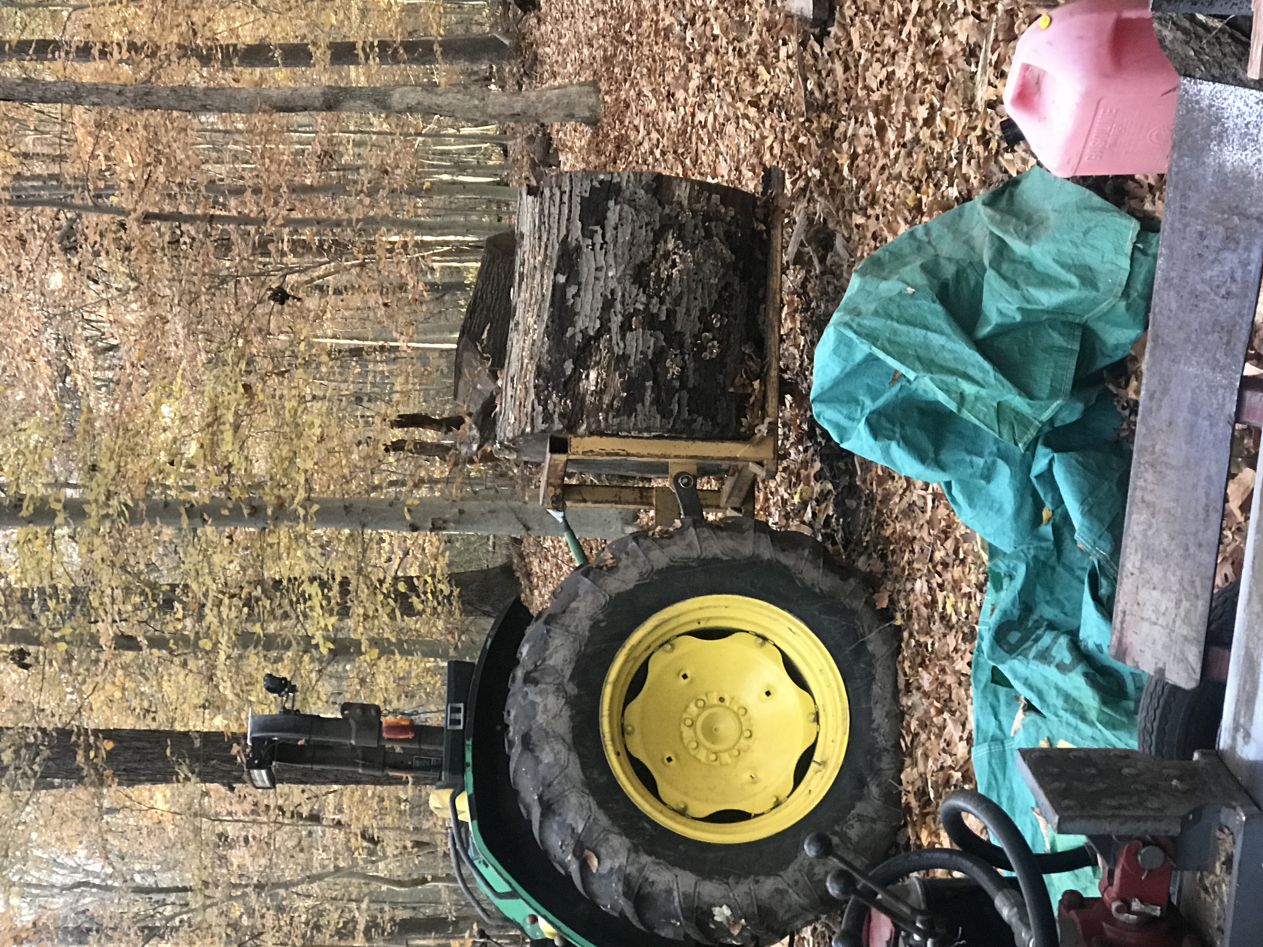

This is as simple as it gets - install rear pallet forks - back up to big ol chunk of oak - watch tractor squat !
   / A simple three point counterweight #86
Might want to check the air pressure in those tires!!! :D :D :D

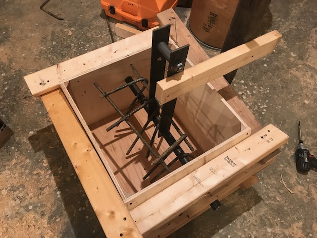

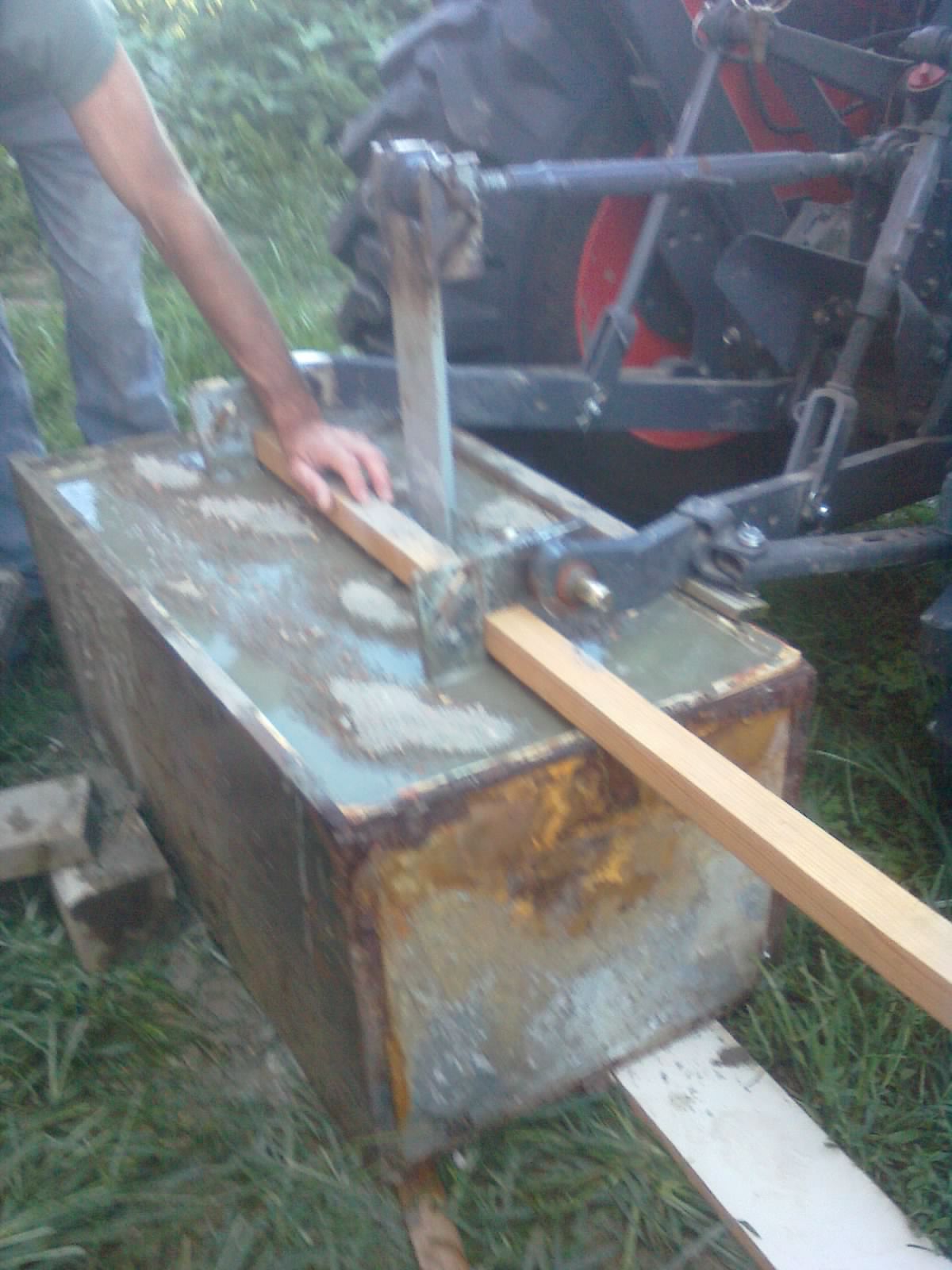

I've browsed this forum a bunch while figuring out how to design a ballast box. I thought I'd add pictures of mine.
I couldn't make myself pay $200+ for a ballast box when I knew I could build one for about $25. I grew up pouring concrete with my Dad's construction company so building the box was a no-brainer.
James K0UA
Hi James,
I am in the process of copying your design - thanks for sharing.
For the holes in the angle for the pin for the toplink, how critical is sizing? I have an MX5100, which is a Cat-2. I have a 1" hole saw, which basically creates a zero-clearance hole for the 1" pin. I am worried that this could be problematic when trying to attach the ballast. The next size up hole-saw I have is 32mm (1.26"). This would allow easy insertion of the 1" pin. Would the 1/4" of 'oversize' be a problem?
Another option is to drill smaller holes - I may have a suitable drill bit or may be able to borrow one - and use the Cat-1 pin.
All opinions and advice will be appreciated.
Ken

I would use the 1" hole saw and ream the holes out with a file or burring tool or similar until you get the pin clearance you want.

It would probably rattle a bit with the larger hole. I would drill the 1 inch hole and then take a rat tail file or in my case a dremel tool and a stone and open it up for easy clearance. This should only take a few minutes.

I use the hole saws a lot when making pin attachments and they work just fine. If your concerned about it, take a piece of scrap steel, drill a test hole and see how the pin fits.

As if your 1" hole saw runs true enough to not create an oversized hole anyway....

Thanks, guys.
I drilled a test hole in some ply and the pin is a snug fit. Interestingly, the hole saw, a Makita brand, is marked 25mm. 1" is 25.4mm, so theoretically the hole should have been 0.4mm undersize. Adding to the 'confusion' is the fact that diameter of the teeth on the saw measure at 24.7mm.
So, it looks like hole saws are more of an approximate starting point than anything one can use for accurately sized holes.
I'll drill the holes with the 25mm hole saw and adjust with the Dremel or a file if/as required.
