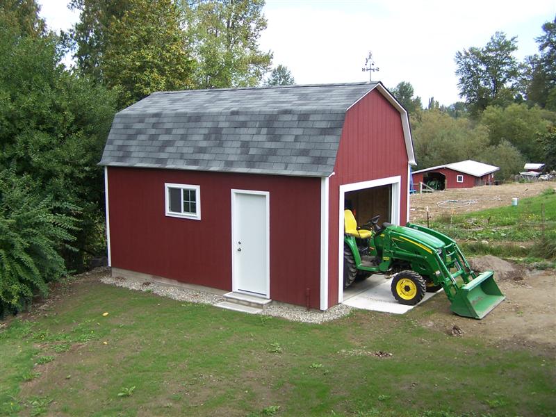

Don't know?? :confused: :confused: :confused: I'm enjoying reading the thread as I just finished my own tractor shed. A pole building would have been much cheaper in my case.

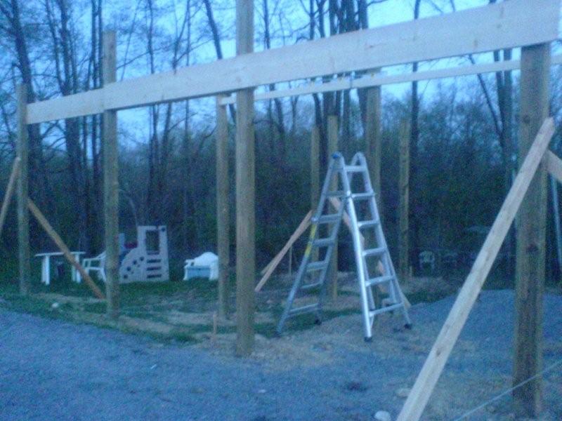

Progress! :D
OK, I finished my re-positioning have all the posts where they will be staying. Out of the 13 there are three that I couldn't position where they should be due to the holes being off because of rock or root.
The posts affected will not throw anything off, for example one of the exposed "porch" posts is off about 4 inches but it's in line with the header. For some it may be a noticable thing that would drive them nuts... for me, I probably will forget about it before the summers up.
I then put up two of the 16' 2x12 headers and 1 of the 16' 2x4 girts.
He's a poor camera phone photo I forgot to take until the sun had started to set.
If you look carefully above the ladder you'll see the 4' level I have bungee corded to the girt.:p
