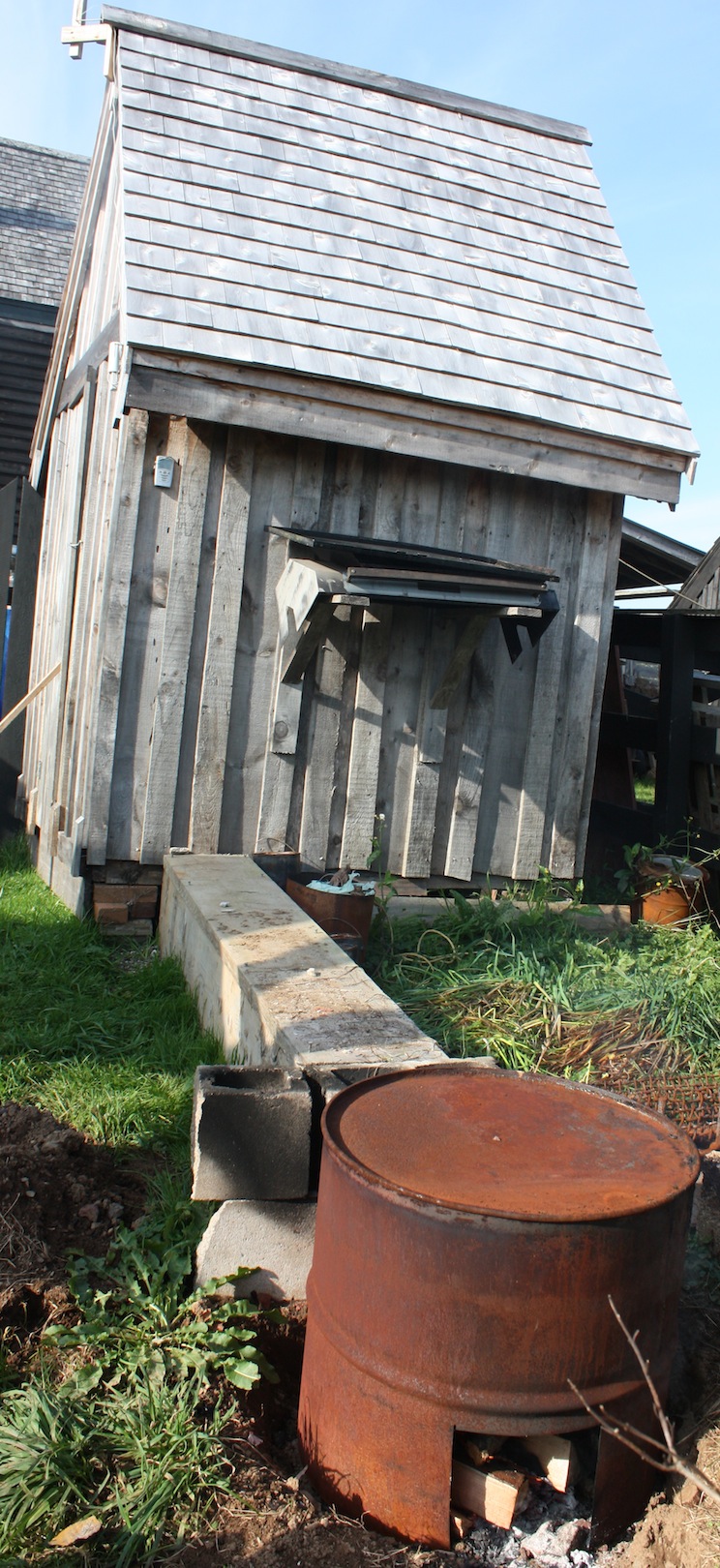

New function on the farm... smokehouse.
Any advice would be greatly appreciated and recipes too!

That smokehouse looks great, but is that little-bitty burner outside going to supply enough smoke to the meat? Not only am I not expert, but I know less than nothing about how much smoke and how long it takes to fully smoke the meat. Someone is gonna have to be there to keep that fire going. How tight is the smokehouse, Lloyd? Does smoke leak out? In your photo of the open door, the smoke looks pretty concentrated.

Lloyd, how is the "smoke channel" connected to the 55 gallon drum fireplace?

I think bacon is "cold smoked" (you don't want to cook it in the smoking process). "Good Eats" had a show years ago utilizing a gang of 3 school lockers. Wood in bay one, piped into the middle bay with flexible duct to allow it to cool before entering bay 3 where the meat was hanging.
Absent that, I think the experts use really green/wet wood that only produces smoke, not a lot of heat and the bellies are hung as far away as possible. You might want to think about injecting a brine.

Thanks all... actually I eat very little bacon - give most of it away. I did a lot of research on the web, bought a few books and asked around.
One of the challenges, for me, is to avoid nitrates. Most commercial products you buy, Salt 1 or 2, Prague salt etc. contain it and it is nasty stuff. Used in small amounts it does its job but it is deadly. My challenge is to not use it. I use a recipe of 1/3 salt, 1/3 brown sugar and 1/3 maple syrup. I brine the portions in zip-locked bags for a week, turning them over daily. From research, you can freeze the end smoked product for about 6 months, but you must consume the bacon in 2-3 weeks when stored in the fridge... not an issue. The cold smoke system allows you to control smoke and temp over 2-5 days. The building is not air-tight. Some buildings have controlled vents. I left the eves open and enough cracks to let the smoke through. **** Remember this is all new to me and a huge learning curve.*** The fire box is 8-10 feet away from the house. Mostly 6 inch ss pipe. I use apple wood and pruned branches from my trees but I do have access to pear trees, cherry and plum on my land - so over time I may try them all. Stay away from the coniferous woods. I got the internal temp of the bacon slabs up to 100+ degrees and smoked for about 6-8 hours. Some research info says 80 degrees, some say cook it at 150... I usually take a slice off and try it. If it is not smoked enough you can always continue. So long as there is smoke coming out it is working. Because I gave up salt years ago I do find it a bit salty. I took one piece after smoking and let it sit in water overnight and drained and tried a piece. The sweetness and smoke is there but not the salt - this I prefer but my friends don't mind the salty taste, so I guess you can fine-tune as you go. I will try fish next and some cheese as well. Some people are smoking pepper, salt and other spices for added flavour. A ton of info out there... I did do some hot smoking over the years with great results. I bought a hot smoker from local hardware store... it looks like R2D2. Simple but works. Hopefully I have answered most if not all of your questions. Along with the pizza oven build - this is another thing crossed off my bucket list! Cheers... PS: you all need to do this!!!! And yes to do need to tend the fire.
