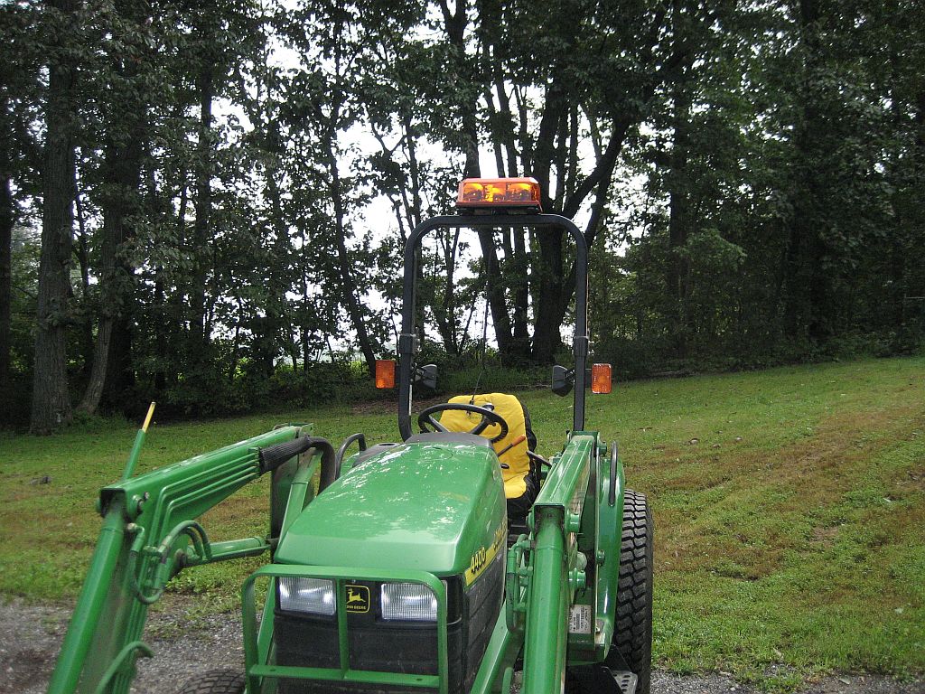

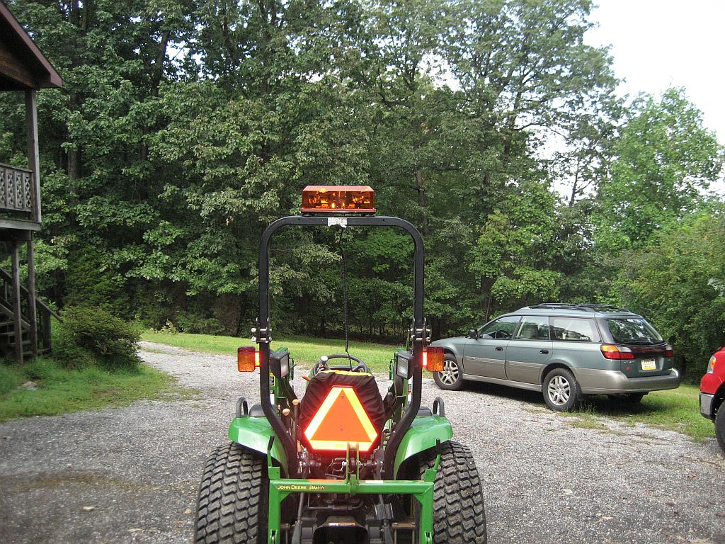

Roy, did you already buy the light? I ended up going with an LED light cause i was worried that the smaller wires prewired into my cigarette lighter wouldnt handle the xenon or halogens. didn't really do much investigating on it though.
I went with the Whelen L31 super led light. it only takes 3.8 amps at full operation. Not cheap though....dang LED's anyways.

Yeah, bought the light a few months ago. There's a couple pictures of a trial fit on this thread's post #39. It's definitely noticable, day time or at night.
All I need now is a sturdy bracket to mount on the ROPS. I'm trying to scrounge up the materials needed without having to spend any money...but I may have to break down and spend a few bucks.
I've worked in a number of fabrication shops...sure wish I had the tools available now! Most were pretty small and, since it's been years since I've worked in one...don't have the contacts I once had.
BTW, that's a magnetic base warning light so I can carry it in my pick up too...
/ Adding a 12volt outlet #69
Yeiks.... i sailed right past those pictures.... nice looking light. A mounting bracket should be no problem. Personally id make one with maybe 1/2" sides so as to give some added protection from the magnetic base moving.
I chose permanent mount base myself, but made a removable base plate so i can remove the entire light in summertime. There was nothing metal up high on my tractor.....

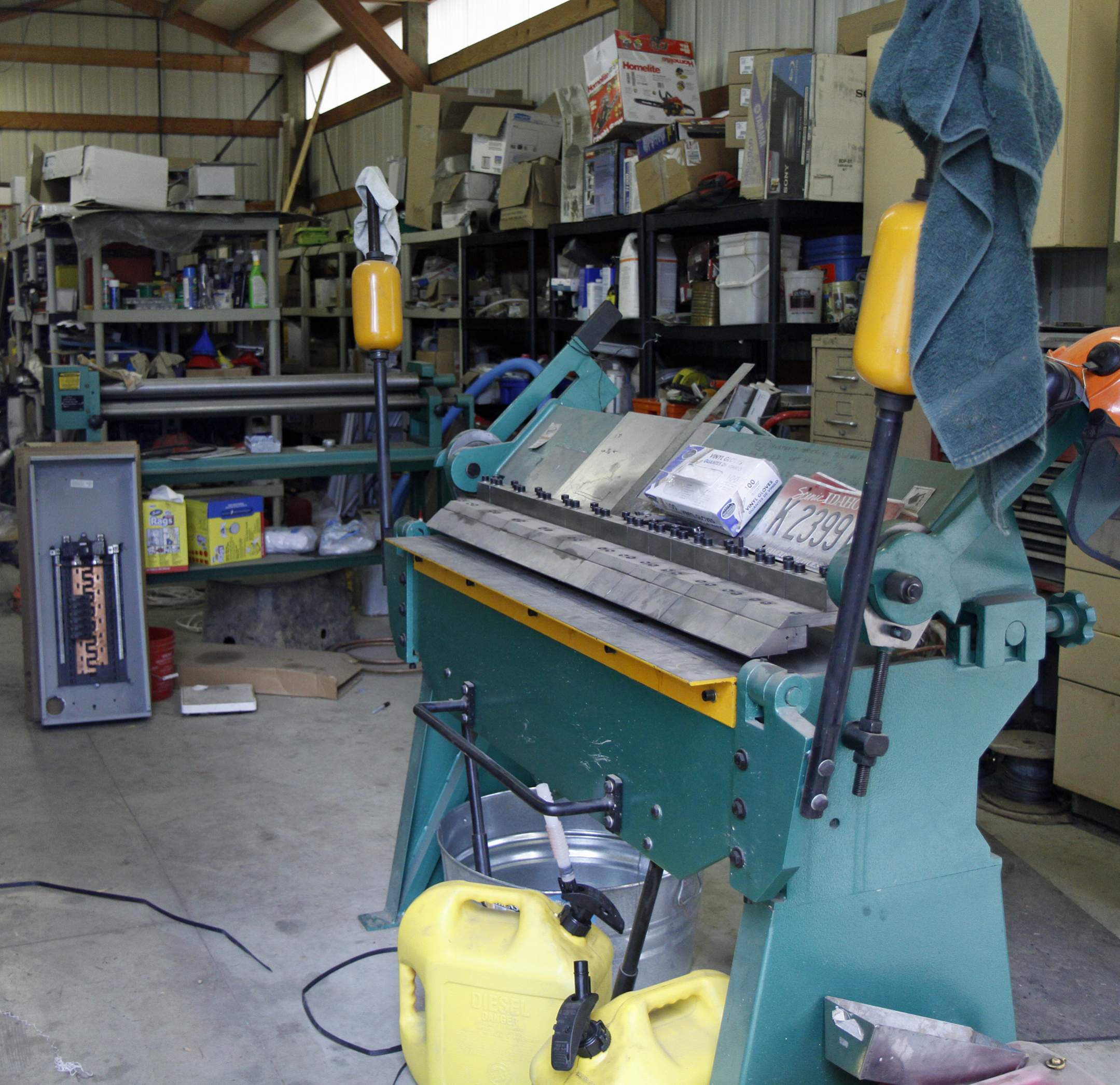

i could make you a 1 piece plate with the plasma cutter out of say 12g steel and roll up a 1/2" - 1" side on all 4 sides . would only need 4 very small welds.
something like this. i have a box brake for the sides
as for mounting? maybe weld 4 bolts to bottom and use a flat plate between a set of bolts around roll bar???
That would work nicely! The welds probably wouldn't be necessary and could act as drains.
Boy, I wish I had a box and pan brake!!!
I'll get the measurements and send them to you...also, send your address (PM or e-mail) and I'll send you the material/shipping costs.

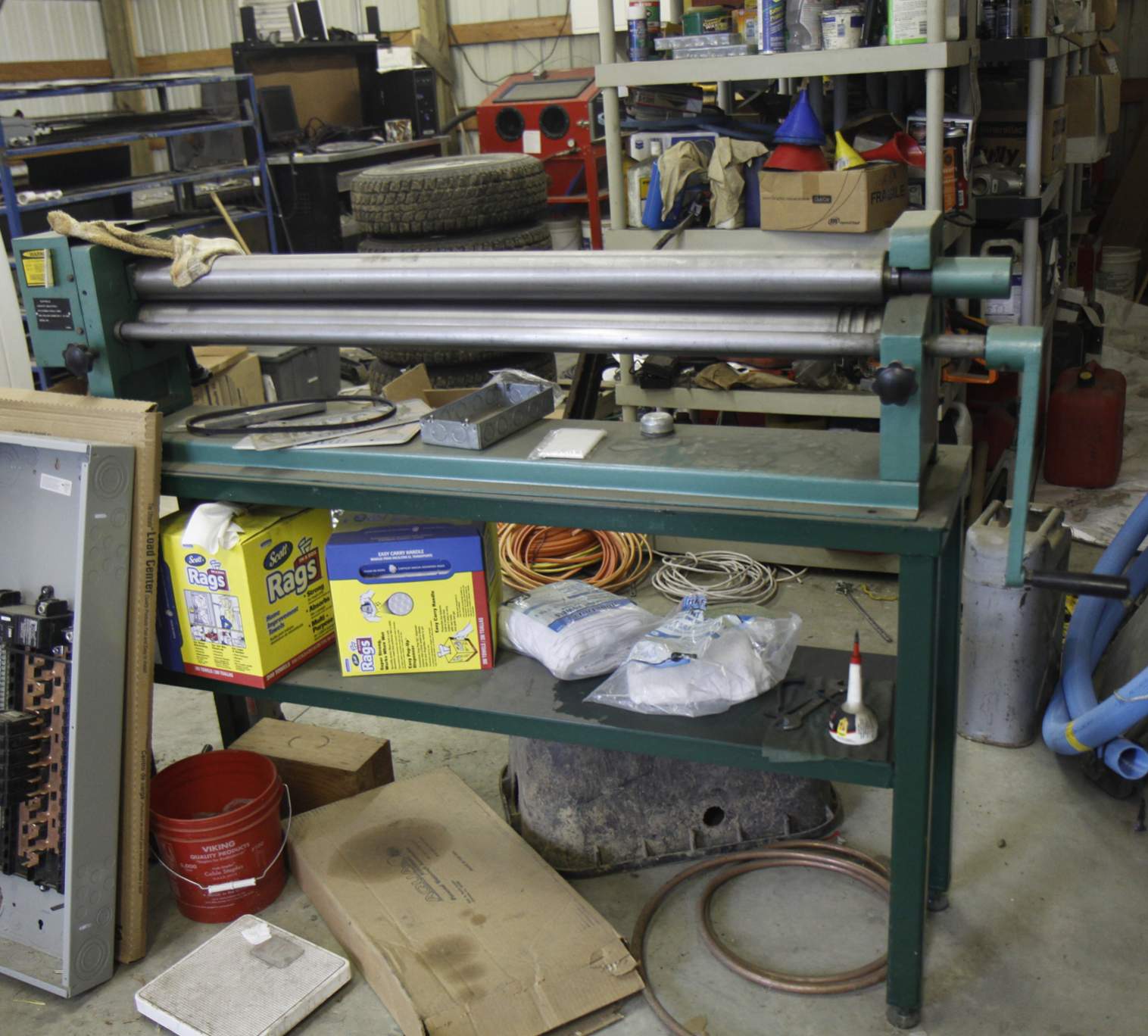

Roy, i shot you a PM. Just get me the dimensions and i can work up a quick drawing. then i have to figure out best way to mount it to the rollcage. I bought my box brake and roller with $$$ made from scrapping copper wire a few years ago... love it.
man, looking at these pics reminds me i really need top CLEAN that shop out.
