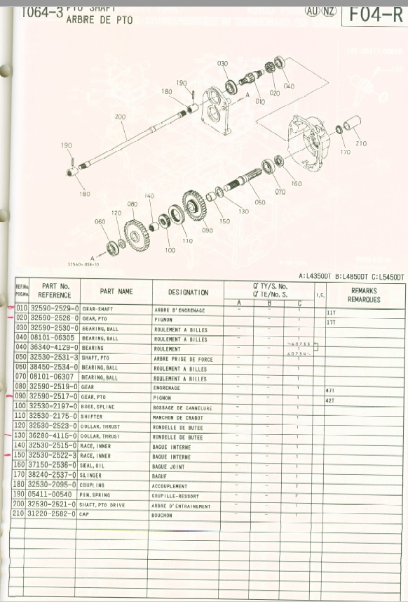

My L4150 had a 2-speed pto, 540 and 750, which was very handy - often I could save fuel, noise and engine wear by running the higher pto speed but with the engine at around 1800. Also, I could run my snowblower up a little to get better throw distance.
My L5450 only has single-speed 540 pto. So I run the engine at 2300 rpm or even higher, but would like a faster pto gear like I had before.
In going over the 5450 parts list, it shows that the tractors in this series made for Australia and New Zealand have 2-speed pto. I've compared the lists and by replacing 2 parts and adding three new ones, my rig will have both 540 and 900 (approx) pto speeds. The parts show as available so they were ordered today. We'll see if this works out.
Anyone have any experience with this? Kubmech?
1-21-02 update - the NZ gears give 900 rpm, and the Aussie gears give 750 (same as my 4150 had) so I'm going Aussie.

Hi Ekster,
Looking at post #19 (page 2) the two being REPLACED are the original upper pinion gear shaft and the dummy spacer on the lower shaft. The 3 ADDED parts in post #18 are the new upper pinion shaft, with its removable second pinion, and its mating large gear.
Post #1 focused on the gearing needed for the conversion and didn't include details like the new inner bearing sleeve 32530-25223, new thrust washer 36280-41150 and the gasket. See AU/NZ parts page below - this is what yours should have in it when converted.
Hope this answers your question - take care, Dick

Out of curiosity I priced the 5 parts needed - they still show as available but the current total is $1724. The 42T gear alone is over $900. No longer makes sense unless used L3350, L3750 or L4150 pto parts can be found.
9/8/22 - just noticed online an available complete pto gearbox from a L3750. Whole box, easy bolt-on 2-speed pto conversion for later-model L4350, L4850 or L5450. (notified Brambleberry by pm)
