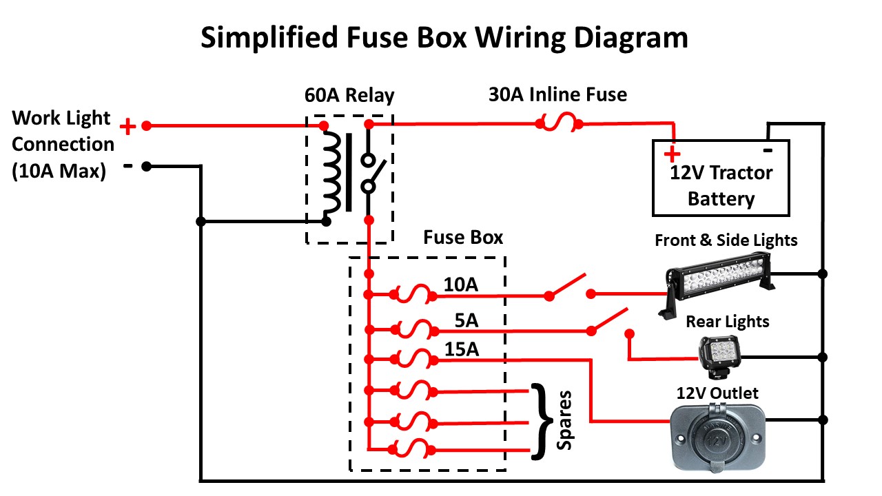

As I understand it, that is what he's doing. He's just looking for a clean way to get key switched power to trigger the relay.
Aaron Z
Yup, pretty much copied http://www.bodenzord.com/archives/579 & put it in the head liner. Have a 60@ relay & fuse block mounted up front. I spaced out the accessory plugs in back, but as I ran smaller wire to run the relay & want to keep it looking nice with all the fuses in one spot. Well 2 if you count the aux fuse box. The 5@ radio circuit fits the bill nicely & my 18 gauge wire wouldn't need another lower fuse.

The relay only needs about 0.0160 amps or 160 milliamperes to "switch" or "excite". Most anything under the dash will work. The accepted way to do it is with one of these-
Quick Splices - 18-14 Gauge
The better way would be to use one of these-
Mini Low Profile Fuse Adapter
To find a switched wire poke around with a test light or volt meter. Just start poking until you find the fuse that does what you want. It should only take a few min to find.

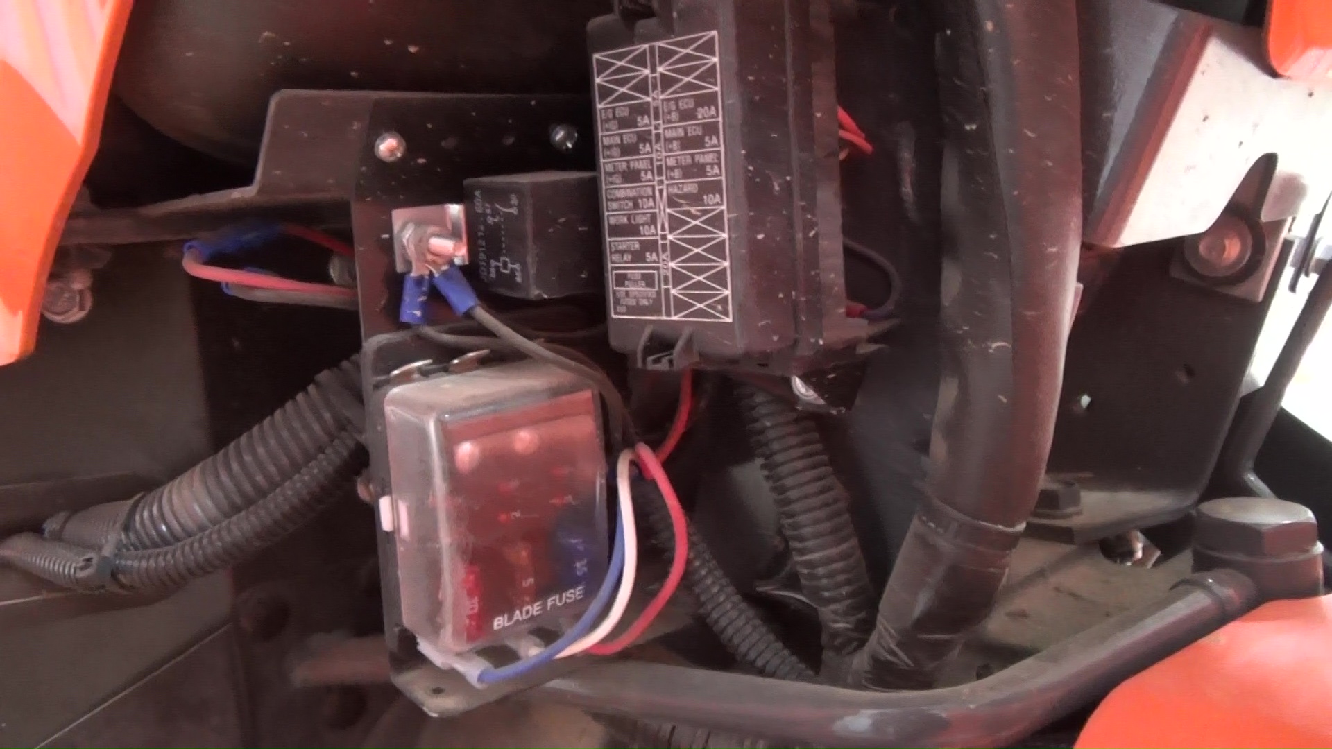

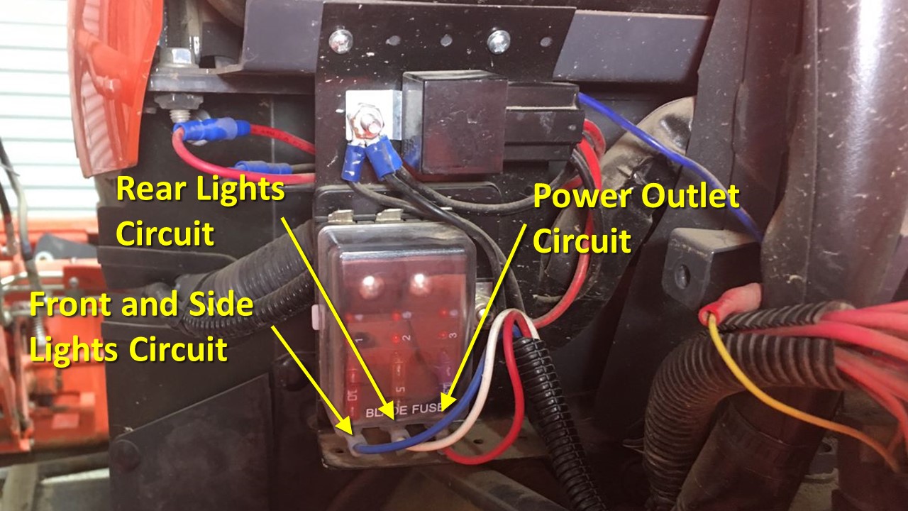

My fuse panel could easily be hooked to a relay to make the entire thing switched. I just didnt see the need, but it installs nice and clean and is weather resistant.Kubota Fuse Panel.jpg
   / Adding a fuse to a Kubota fuse block or other options? #31
Juiced06GTO: I really like your fuse panel. Any issues with heat with the fuse panel being in the "engine compartment"?

For years tractors had fuses along side the engine.
Modern cars have the large fuses in the engine compartment.
In short, no problem

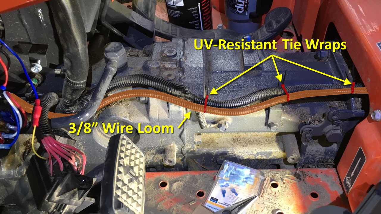

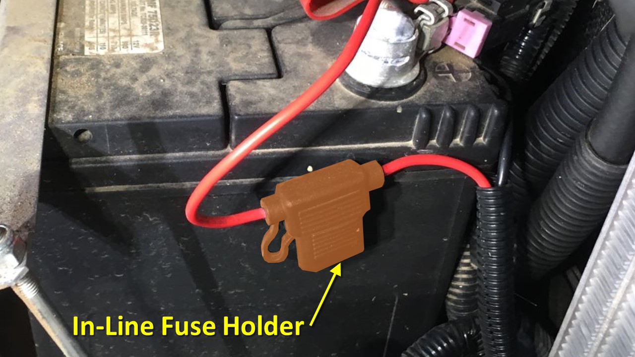

My fuse panel could easily be hooked to a relay to make the entire thing switched. I just didnt see the need, but it installs nice and clean and is weather resistant.View attachment 500438
That looks like the exact same fuse panel I used! Here's a few pics of the install:
I have a video that shows the details of the installation with a link to a materials list:
This setup has really worked well for me.

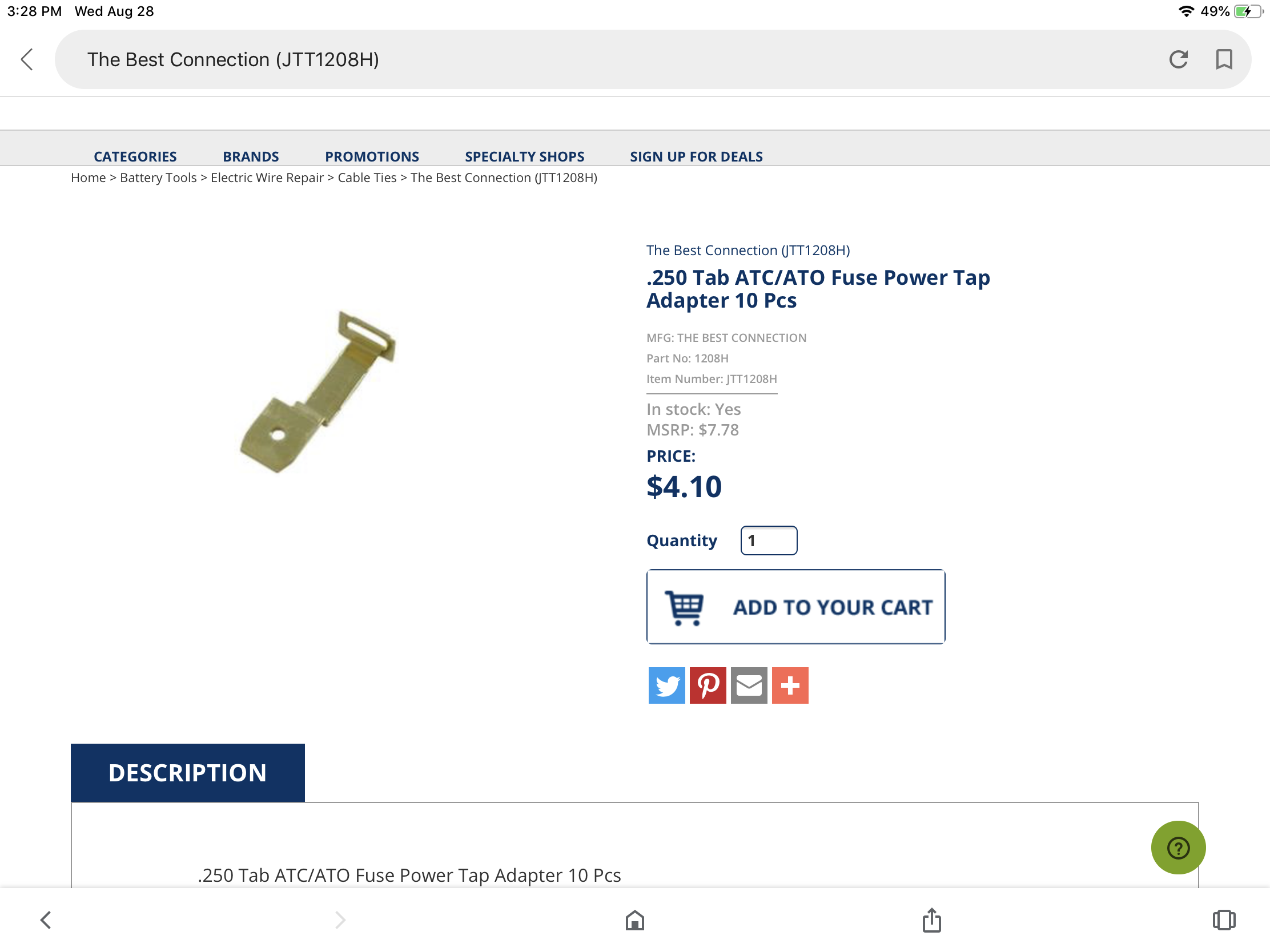

This is what I used in my pickup, just pull the fuse and slide it on and put fuse back in, they make them for the glass fuse also.
   / Adding a fuse to a Kubota fuse block or other options? #37
I realize this is an older thread but thought I would weigh in on what I found. I added two additional fuses to my BX2680 factory fuse box. The box has three empty slots, no connectors, no power. I purchased several different types of connectors before I found one that would work like the factory fuse terminals. Since Kubota likes to use soldered butt splices I didn't feel bad adding another soldered splice from the power wire coming off of the lights fuse. I have noticed that ebay links sometimes die so I will also add the description below. Also if anyone is interested I can sell you some connectors since I had to buy 25 of them to be able to use 4 to hook up my ROPS lights.
