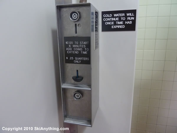

The one I liked best was the coin operated timer, but that'll never get you rich besides you'd simply be increasing their allowances.

Perhaps a few brochures on coin-op showers laying around the house just might do the ticket to get their act together ;-). If I didn't have two tanks, I'd just set a countdown timer in the bathroom. If it goes off, the kids would risk getting a dump of ice water (and their allowance gets donated to charity). Seriously! There's so many creative ways.
