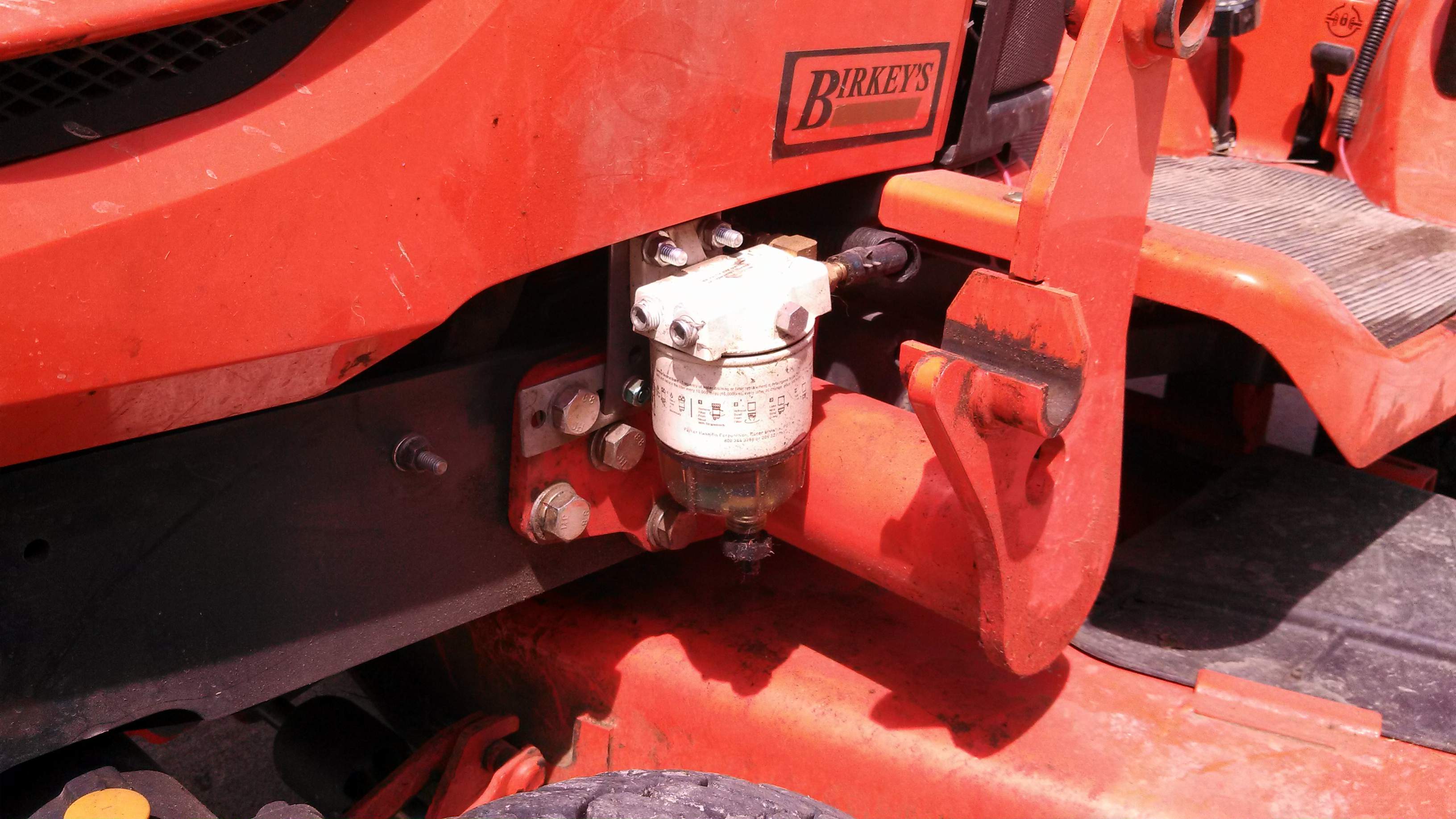

Here is another pic of mine. I used some flat steel with pre drilled holes in it because I don't own a welder. I tried different locations but as far as I know, this is the best place. I've had mine on maybe a year and haven't changed it yet. I do have a spare though. I'm probably going to go 3 years before I swap mine out.
To add a little more about my bracket, I have one piece of the flat steel running horizontal mounted to the loader mount bolts. Then I have two pieces of it running vertical ( you can only see one in the pic but they are side by side), each bolted to the two holes in the filter then bolted to the horizontal piece that's on the loader bracket. It looked awfull when I did it but it has actually worked out really well.

Its working great for me.
Filtered out so much crap and water. I just went and added some valves to the housing so I can shut it off if I have to do maintenance like changing the filter or cleaning the bowl (much easier than using the hose pinchers I have).
No freeze up or reduced performance issues this winter.
