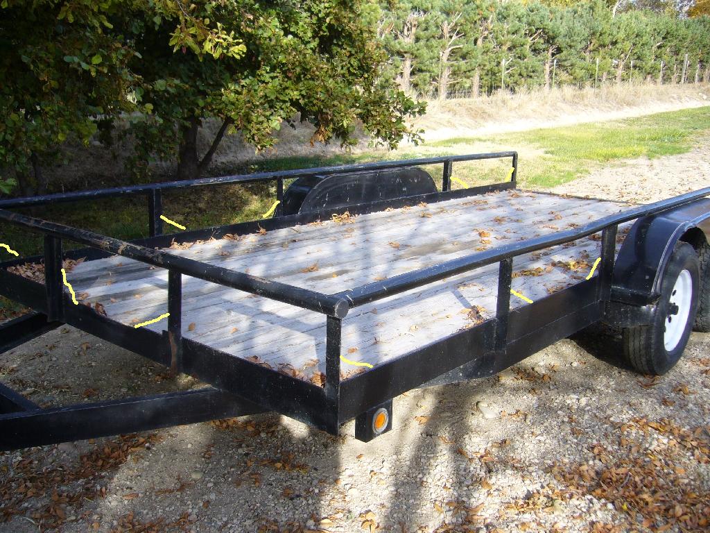

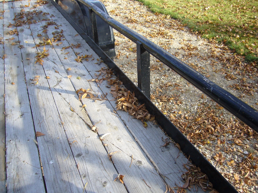

I picked up this trailer last year in a trade. Not exactly what I wanted, I don't like the side rails, but oh well it does have ramps. You can tell by the damage on the rails that at least one of the PO's also wished it had D rings :D
The sides stick up about 3.5 inches above the deck and are 1/4 inch thick. I am thinking of adding weld-on D rings. Since the D rings will need to be up at the edge I am thinking I need to stiffen the sides by adding a 3/16 or 1/4 plate to weld the D ring to. I mostly just haul wood pellets, lumber etc. but would like to have the option of hauling my tractor (b7100) on it as well. Anybody have different ideas or thoughts?
Thanks!

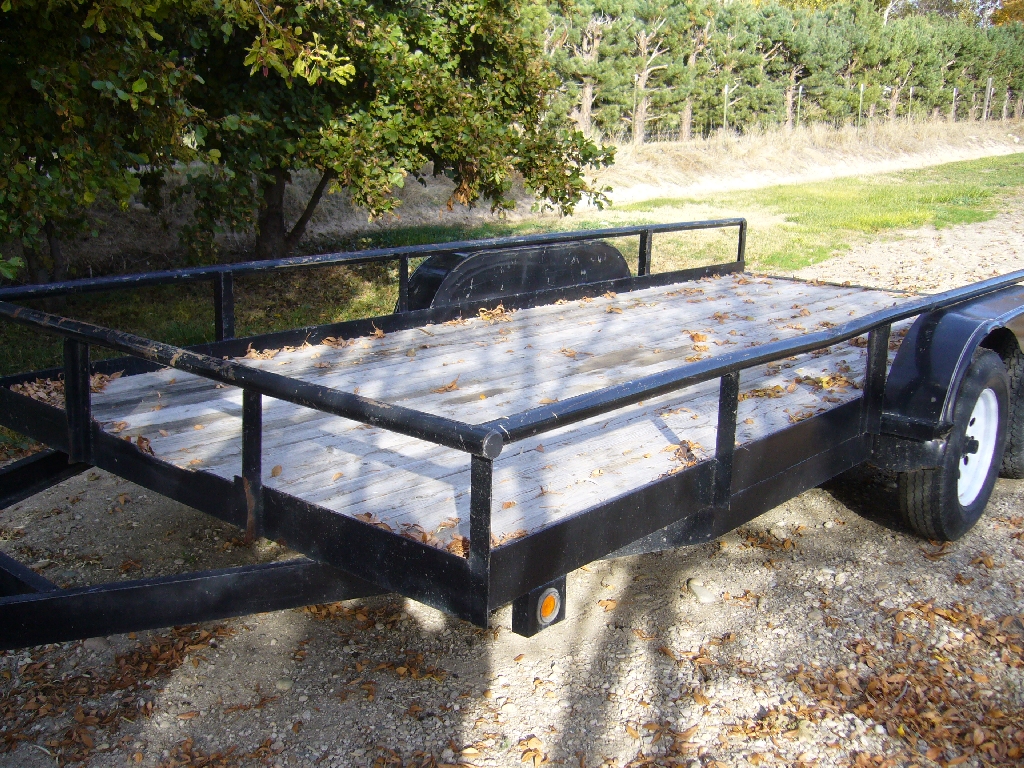

Can't load from the sie with forks Bummer.

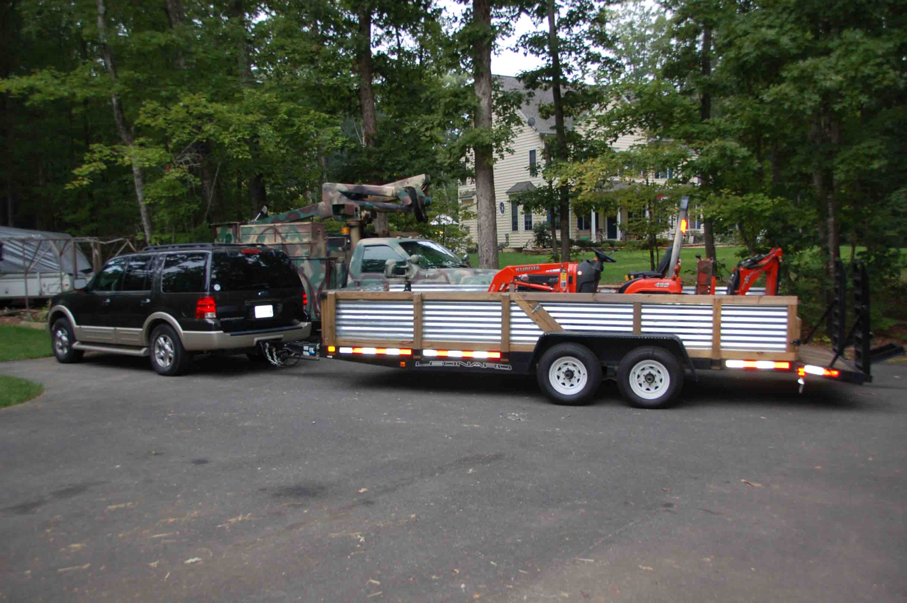

That looks very similar to my Big-Tex, if not the same...I added lots of D-Rings to mine, you can view the pictures in THIS thread. I have towed a lot of stuff and equipment with mine and never had a problem with the way I welded them on.

What we do that is dirt cheap is get some 5/8" round rod from the local supply. About 6' will do. Cut them into 8" lengths and weld them at a 45 between the upright for the rail and the side of the trailer frame. It stiffens up the trailer a lot and gives you a tie down at each upright for about $10.
Like I doctored your picture. Look below, the rods would be what I marked in yellow.

What we do that is dirt cheap is get some 5/8" round rod from the local supply. About 6' will do. Cut them into 8" lengths and weld them at a 45 between the upright for the rail and the side of the trailer frame. It stiffens up the trailer a lot and give you a tie down at each upright for about $10.
Chris
Sorry - :( I am trying to visualize what you trying to say. I understand the cutting m,etal and welding it at 45. But where exactly do you mean? on the inside or outside ? Do you have a picture of ones you have done ?
Yep, there is no manufacture info on the trailer so when I started googling around I found the BigTex trailers. I think mine is a clone as the dimensions are not the same as what BigTex lists on their spec sheets. Construction is similar though.
I hadn't considered putting the D rings on the inside... the trailer _is_ wider than most anything I would slide on there hmmmmm ;)
Diamondpilot's idea is interesting to... especially since I have rod laying around... decisions decisions ;)
Chris
That is an excellent idea. I have chain pockets on my trailer already but those angled rods wold be a very handy addition. Cheap and easy too, just my kind. :D
/ Adding D rings to this trailer #10
Check the picture on my post. I used paint to mark the placement in yellow. I have not done this to my trailer but to about a dozen customers trailers. Just make sure you place the so you can run a chain and hook through.

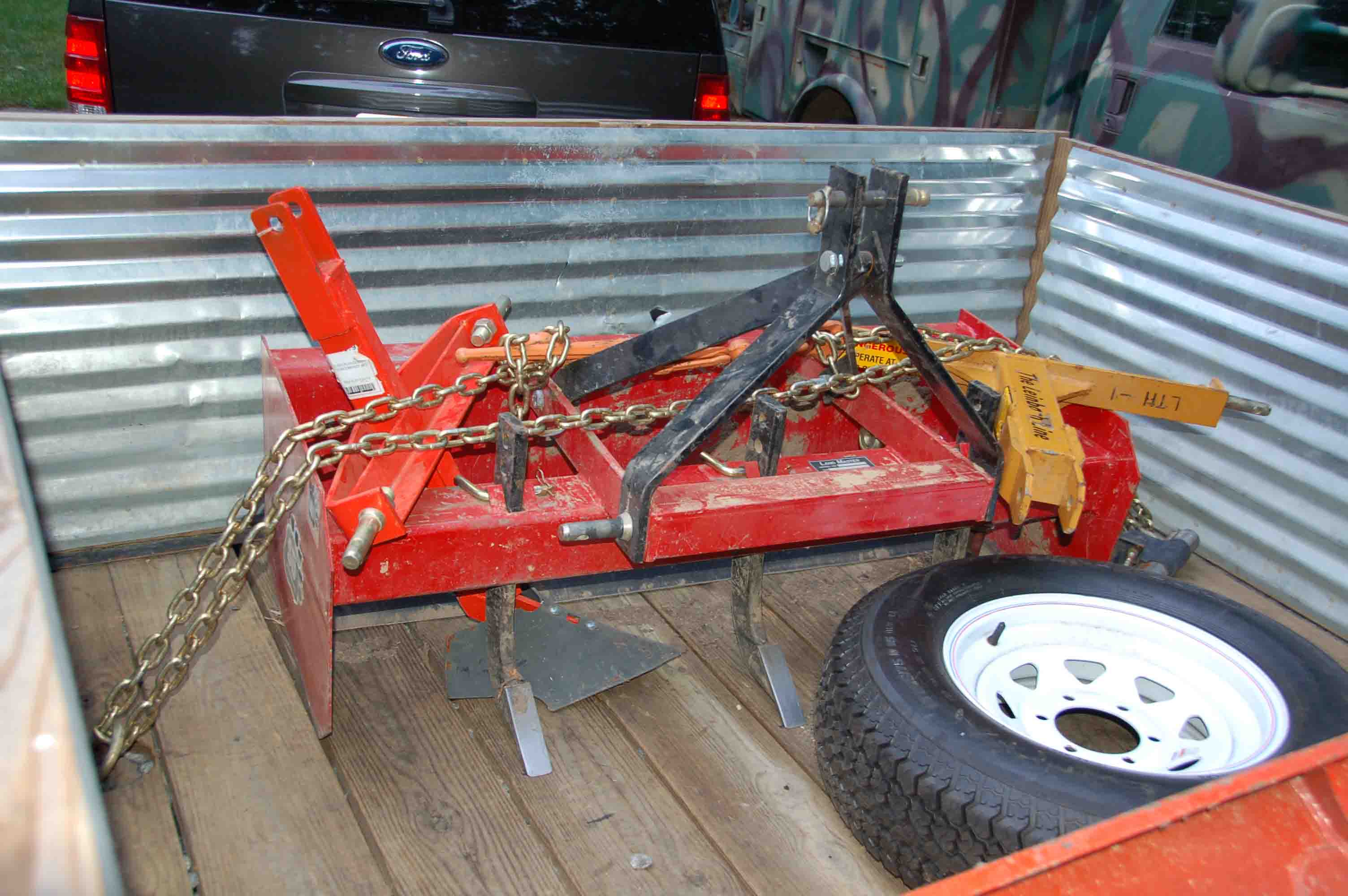

This was my solution. Each D-ring is set into the floor so I can slide the FEL over them if unloading mulch, for example. Even if they get jambed in there with rock or something, a quick pry with a screwdriver and they're back up and ready to go. A shove with the heel and they're flush with the deck.
I have 12 on the trailer, 4 toward the front and 2 toward the back on both sides. They are bolted to the cross-members under the trailer with Grade 8 bolts. Figure if the cross members fail (remember, they're further reinforced by the decking), I have bigger problems on my hands...
If I had a welder, I'd consider welding them to the outside rim of the trailer, but then they'd be clanking around endlessly AND that wouldn't work too well with the stakesides I built...this way I can keep all the chain inside the trailer.
And the larger D-rings have worked very well since I can pass the hook to my 5/16 G70 chain through them without a problem, further increasing tie-down flexibility.
I'll give you 3 guesses on which pictures were taken when new and which were taken after 1.5 years of service.
Chris
OK- :eek: apprantly I didnt click on the picture and look closely - I should have done that. now I see what you mean by that, however looks like it won't work for me since I have 2X12's on the sides to hold in the mulch, stones, firewood. However I like keithinspace idea- recess it in the floor decking right over the frame members for holding strength.
Keith- did you make a template for your router to shape that quickly for the d rings ? looks nice and neat.
/ Adding D rings to this trailer #20
No, I just traced around the D-rings onto the wood deck, then "freehanded" with the router and a 3/4" flat bottom bit with 1/2" shank. Not exactly the quality of an Amish artisan...there are a couple of minor "drifts" if you look really close, but it is amply sufficient for the intended use. I found that they're more difficult to use if the tolerance is too close. When I replace the planks, I'm probably going to leave yet another 1/4" around each ring so I don't need a screwdriver to get them up (they can get a little jammed up with stone).
Originally, I set the router deeper for the mounting strap and had the cut a smidge shallower for the rest of the pocket. After I installed the first one, I realized that when you squished the wood during the mounting procedure, it made the ring pop up. I went back and cut all the pockets full depth and it has worked famously. I've unloaded many, many loads of mulch and stone from this trailer with my machine and haven't had any issues with 'snagging' a D-ring.
The two issues I DO have which I need to address:
1) The metal strap going the width of the trailer between the two 9' long runs of wood...my FEL always gets hung up on that. I need to fashion a "ramp" or otherwise nest it into the deck wood when I replace the planks.
2) The corrugated metal that makes up the front stakeside is insufficient structurally to push against and get that last bit of mulch or stone. I need to replace it with heavier metal or just strips of wood.
