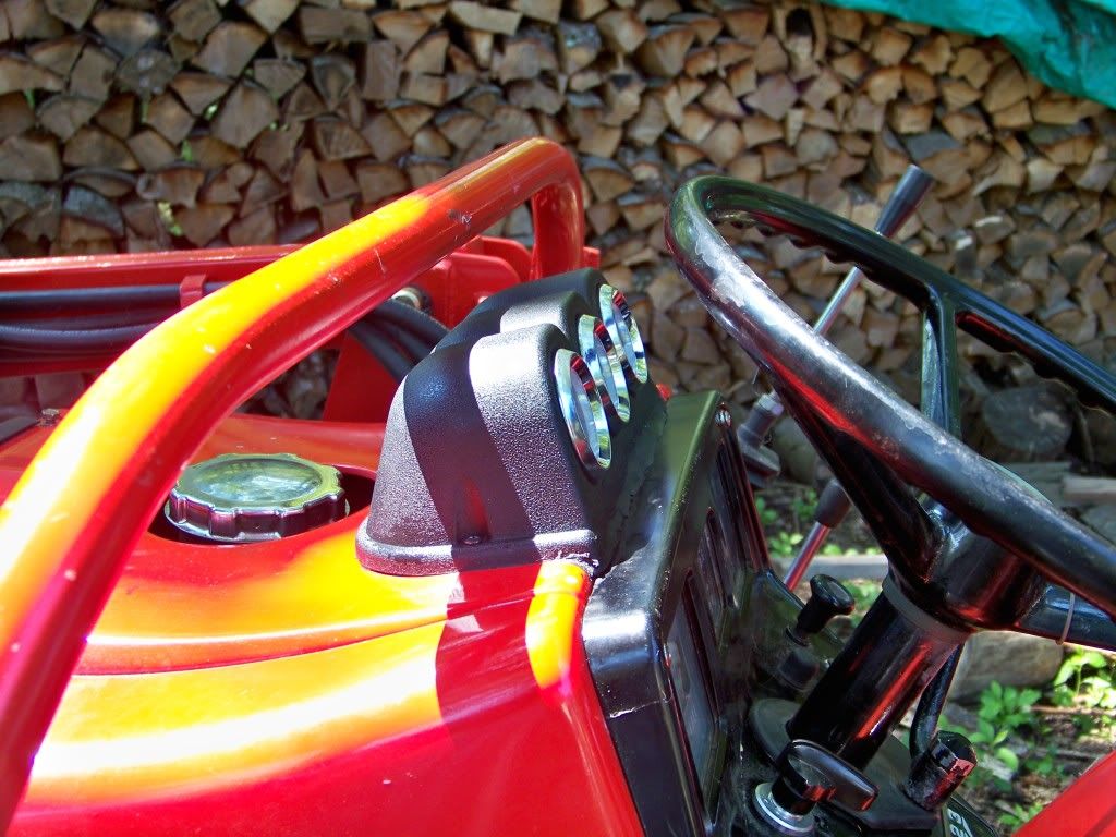

The family has recently purchased a SC2450, i'm the one doing all the maintenance actions. I'm trying to educate everyone operating it on the easy pitfalls to avoid, low oil and overheating mostly. I'd like to add oil pressure, oil temperature, hydro/gear fluid temperature, water temperature and an ammeter. Perhaps an air restriction, a hydro fluid filter restriction gauge or even a hydraulic pressure gauge, but those are more my business and not critical to daily operation.
The engine is a 3TNV, and from what I can tell, has all the sending units already. They're just hooked to dummy lights in the dash. I'm thinking I can mount the gauges on the grab loop in front of the steering wheel. It's very solid, large and hollow. I figure i'll drill holes, mount the gauges vertically, then make a small sheet metal shield behind them to protect from branches and the like.

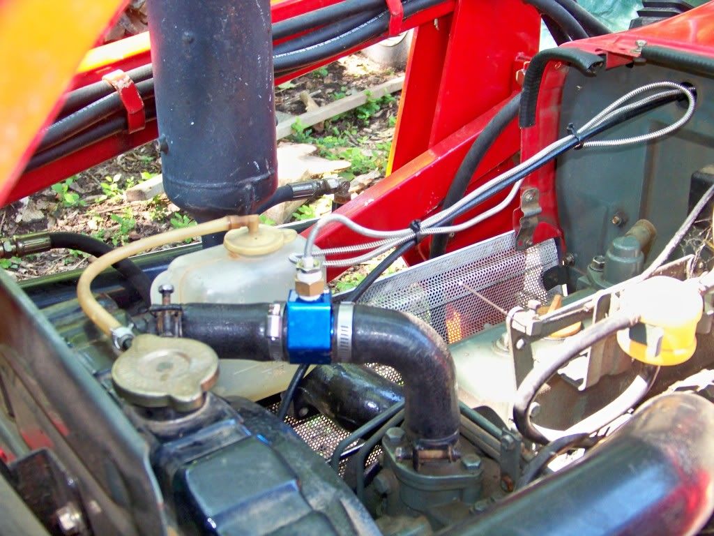

You can T them in and reuse the light senders all except the temp gage and it will need plumbed into the coolant to read right it can be tee'd in also but dont count on it being accurate.
Look at this thread closer because Scotty Dive found a collar with a pipe threaded hole in that goes into the upper rad hose that will allow both to be used.
btdt on mine and ended up getting rid of the light sender and running the gage sender right into the old hole in the water pump housing and it reads right now.

FYI....I have an extra 30 mm and 32mm adaptor that installes in the upper radiator hose for an external temp gauge. Paid $20 each....make me an offer via pm and I can ship them out to you.

Scotty, That is one gorgeous tractor. I have a 2210d that I am going to add guages to. Happy tractoring.
