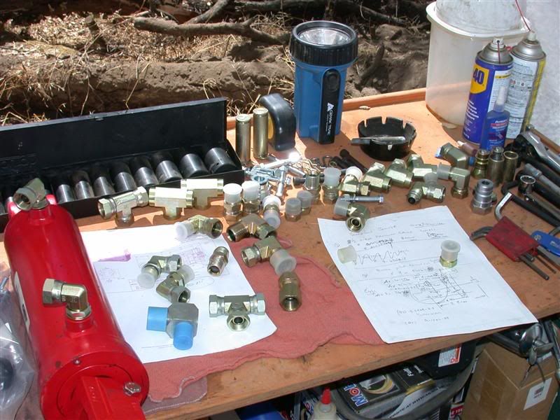

I needed them because I was not sure how it was going to turn out. Especially mounting...hard plumbing the double pilot operated check valves I bought from Surplus Center. I had machined some various nipple lengths in order to get the spacing correct for the hard plumbing. After trying it several times, I finally got the right combination and made a good plumbing job of it. I used pipe joint compound for the NPT fittings. The others were SAE and JIC fittings.
Here's what the cylinder looks like with the check valve mounted. It was a lot harder than I thought but came out just fine. One thing for sure, the Surplus Center DPOCV is a lot bigger than the CCM one on my top link cylinder.
Then I took the cylinder assembly and mounted it to the tractor. I had previously re-attached the top lift arms and lower drag links to be certain I had them in the correct position. The top lift arms are splined so you can set on the tractor at different positions. So I had to check the full movement of the arms to see if there would be any binding or interference. I also checked the to see where the full length and shortened length of the cylinder would position the lower drag arms.
Anyway, this is how the cylinder looks when in position.

When considering how to plumb the tractor, I had decided earlier on that I would use the new 3 spool valve to control the top link and also the hydraulic rippers on my box blade. It will also give me one more set of remotes for whatever else I come up with? That meant making a new Quick dis-connect bracket and having all the hoses go there. Unfortunately, I didn't have time to install the new valve. We were planning on dove hunting and also going up to Sequoia to see the giant Redwoods. Another thing I had to do was trench some deep holes for the solar guy. They are for the solar trackers and had to be 4' x 4' x 5' deep!!.
So I hooked up the new side cylinders to the old valve that ran the rear remotes. In fact, it made good sense since it's levers were next to each other, left and right. So it was easy to tell which lever runs which. That way the 3pt system was in tact and ready to use. I also got some metric adapters (22mm x 1.5 pitch) to make the connections to the Chinese threads.
After getting everything screwed together and trying them out, I had to be certain none of the hose interfered with the 3pt system and that they had enough room and play regardless of what I hooked up...including the PTO pump for the backhoe.
So this is what that turned out like. No leaks and everything fits, works and is tucked away nicely. To my surprise, even the big check valves look decent.
