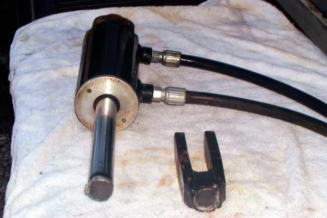

Looks fantastic ! But I'd expect no less. I'll be content when i do my remote install if it comes out half as professional looking. Just curious...... do you have a crimper to make your own hydraulic hoses? Or did you actually measure, then order them over the phone and have them the correct length the first time? I've had hoses made in the $90 range (obviously much longer)... so it wouldn't take much mis measuring to waste alot of money.
Nice work Rob ! Now we need some action pictures.
Ductape my buddy....Hahaha action pictures yes. I forgot all about taking a video. The wife and I were Dove hunting in between this installation so we were anxious to get out in the field.
As far as the hoses, here's what I did. I measured (best I could) how long each hose run needed to be and wrote that down. I also made a note of what kind of fitting either end needed so that length and fitting end were for that hose only. Then I looked up either at Surplus Center or Agri-Supply for the least expensive hose that would work, being the correct length too. So on MOST of the connections, I went with Agri-Supply and figured on cutting off one end only to have the special fitting put on, and the other remaining the swivel male NPT. I got connector fittings to go from NPT to whatever and save a ton on making hoses up. I have a hydraulic store who then crimps on the other end for the JIC, Metric or SAE as needed. Many hoses I bought long enough (figured it out in advance) so that when I cut them on my abrasive wheel it made two hoses...each needing only one end put on, reducing waste.
Hope that helps.
   / Adding Hydraulic Side Links #42
The best way to measure for hoses is to get an old garden hose and use it as a template. It can be routed easily to find the final resting position and cut to the desired length. Measure the length and determine your end fittings. I always have my hoses made with swivel ends of the desired type. It makes installing them much easier.
Once you have the proper length and end fittings determined, call Discount Hydraulic Hose and order the hoses. They have supplied several of us here and give good service. Mention TBN when you talk to them as they are quite aware we exist.
Make sure that you get 2-wire hoses (aka R2). You will probably use either 1/4" or 3/8" hose. STAY AWAY FROM ANY 1-WIRE HOSE purchased from places like TSC, Surplus Center, and others. They are not as strong and will not last as long or take much abuse.
Good luck and have fun.

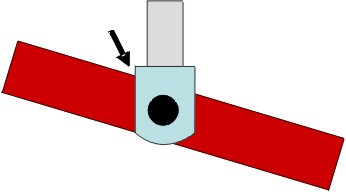

I know there was some concern about the clearance of the clevis ends on the hydraulic cylinders when severely tilted. I realized I had not posted any photos of the box blade mounted but only with the lower arms extended and retracted. This weekend I was able to take a few pictures so you could see the amount of tilt I can get on the box blade and no binding in the clevis mounts.
Here is the first one.
