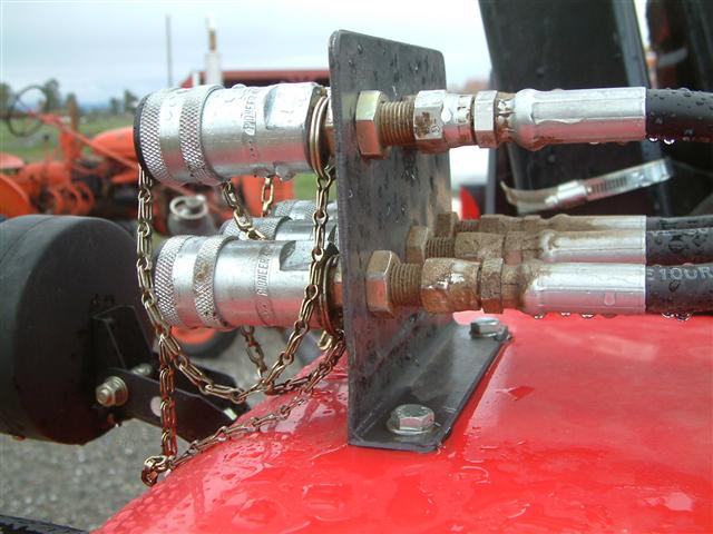

Judging from the Surplus Center pic, it's all set up for power beyond, just plumb the power beyond, inlet, and tank ports.
Run the working port hoses to a plate with bulkhead fittings that tighten to holes in the plate, and attach your quick connects to the other side of the bulkhead fittings.

If you look at the last picture Flusher's nice dealer installed setup the bulkhead bracket looks like a piece of 3/16 plate welded to a piece of angle iron. Not a mass produced item. The $1000 factory kit might come with a nice bracket. A bi-metal hole saw will put holes in plate if you want to make it yourself. A friendly shop with an ironworker machine can make one to your sketch pretty quickly.

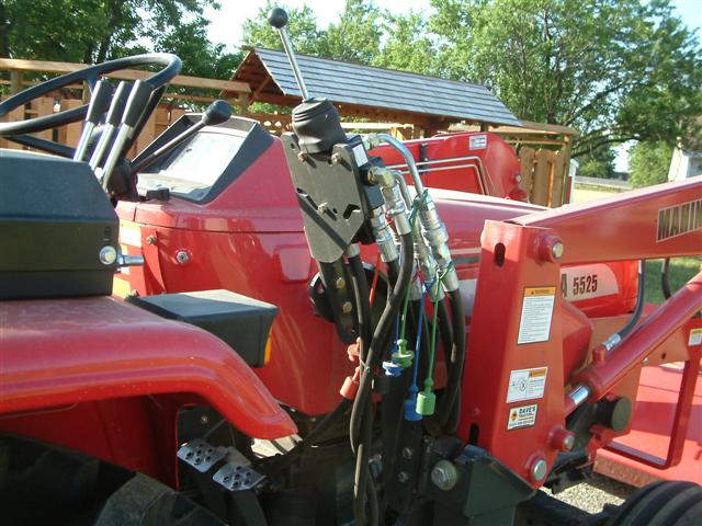

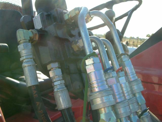

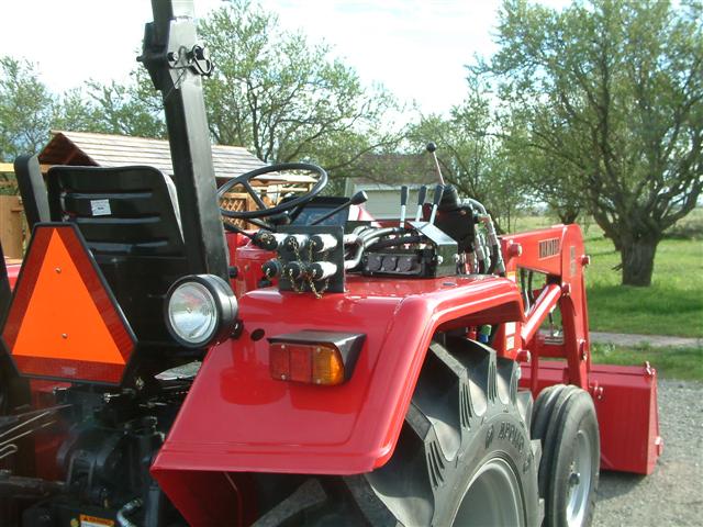

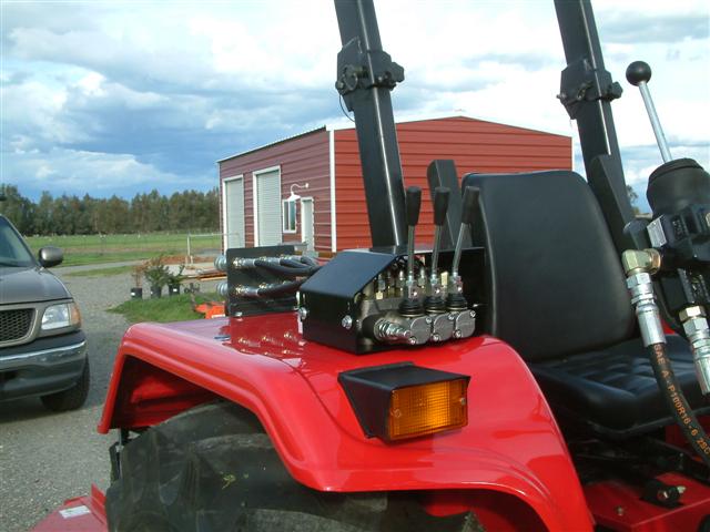

I also made my own rear remotes. It was really simple, much like the ones on the Mahindra.
I simply came out of my FEL valve's PB port, about $30 for the fitting. I then got a two spool valve. Something like this.Prince Two-Spool Control Valve, Model# RD522GCGA5A4B1 | Control Valves | Northern Tool + Equipment I paid less than $200
The rest was just the fittings, hoses, and some steel to make the brackets. I mounted it on the fender also. I had about $200 more in just the 6 hoses. The feed and return were about 8' long and the 4 work hoses were about 3' each. I branched off via a "T" on the return line prior to the system filter. Works great. Probably got close to $600 in it. Just no way to do it cheap and have it work the way I wanted.
As for using the FEL valve that is one way of doing it but the worst solution in my eyes. I love having both working for dirt work and snow removal.
