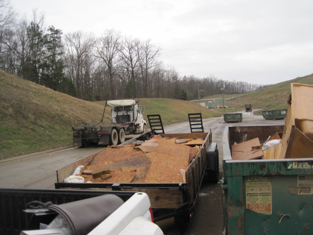

I use my 16' to haul firewood & sawdust mulch a lot. Sides are 3 treated 1x6's with an angle iron on the top edge to protect the wood. Sides are in two pieces (7' & 9') to make them easier to handle, using metal corners & center couplers from Northern. The back endgate can be moved to the center, boxing in the front 7'. The endgate has 3/8 steel pins on the bottom to hold it in place, along with a ratchet strap when used at the center. ~~ grnspot

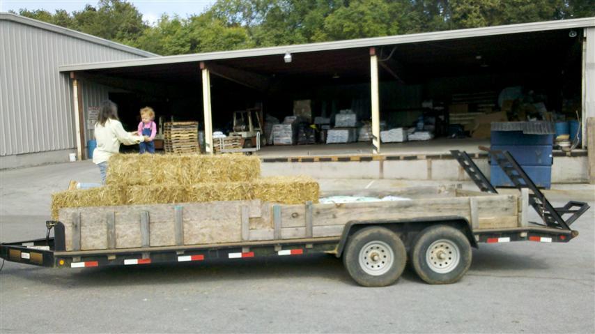

Paul,
Here's a picture of our trailer. We made trailer sides using scraps of 2Xs and OSB (not even plywood). It looks Jethro Bodine style but works great and didn't cost us anything for the materials. We didn't paint or do anything. I wouldn't be surprised if these junk sides last for 10 years.
Adding the sides to the trailer really increased the functionality. Until we added the sides, hauling stuff other than the tractor was much harder.
