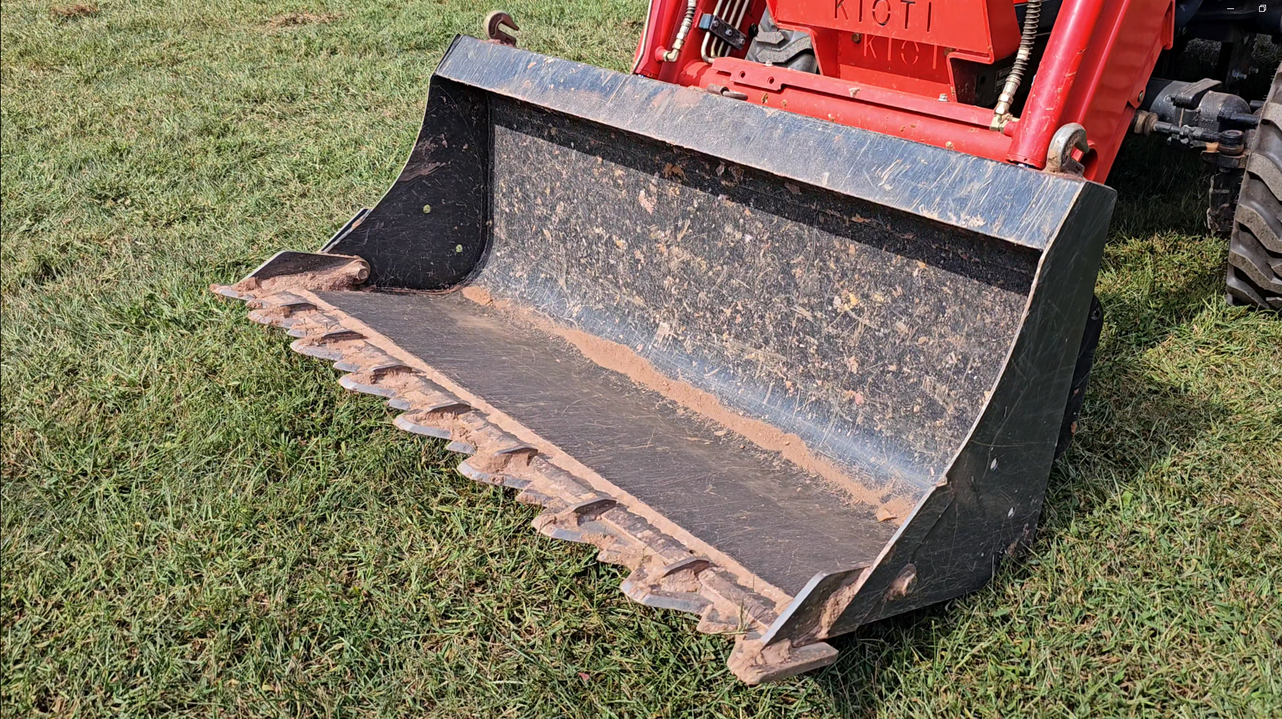

Tooth bar with shanks is better for busting dirt, serrated small tooth bar like a Piranha is good for both busting dirt and still being able to scrape flat ground clean.
As "old and tired" said, it will give the bucket strength along the leading edge and help with preventing it from bowing down. I have a BXpanded Piranha tooth bar and am happy with it.

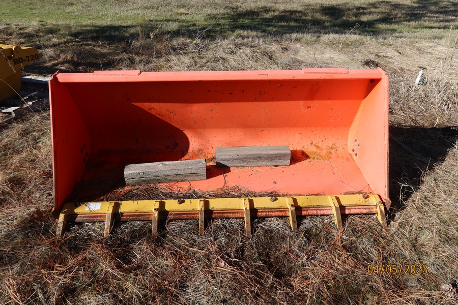

My tooth bar hooks under the lip and is bolted directly onto the bucket. It's not intended to be removed. Definitely adds strength to the lip.

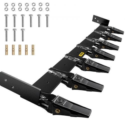

Would the cheap vevor be worth trying?
/ Adding teeth to a bucket
#9
This one:
/ Adding teeth to a bucket #12
This is for your Massey Ferguson 231? 38hp? It's fine if you are digging in sand or mulch... if you want to try clay and rocks, who knows, it might work. The first comment I read on their website was, "Do you sell replacement teeth?" Answer was, "No".

oosik that's not a tooth bar them are FANGS:ROFLMAO:
willy

By golly Willy - you B right. I accidentally walked/tripped/stumbled into those "fangs" - just once. I have a nice scar on my right shin.
