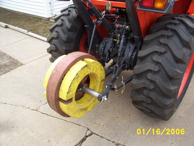

Or hang some old wheel weights on your 3 point /forums/images/graemlins/smile.gif .
