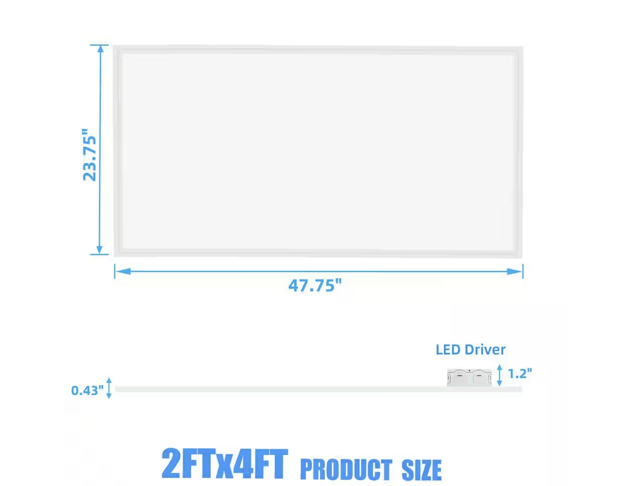

I used some LED troffer panels (drop ceiling) from Home Depot, but they are easily suspended. Lots of light and very low cost to run.
https://www.homedepot.com/p/2-ft-x-...eiling-Light-4-Pieces-panel-4pack-B/321758847
