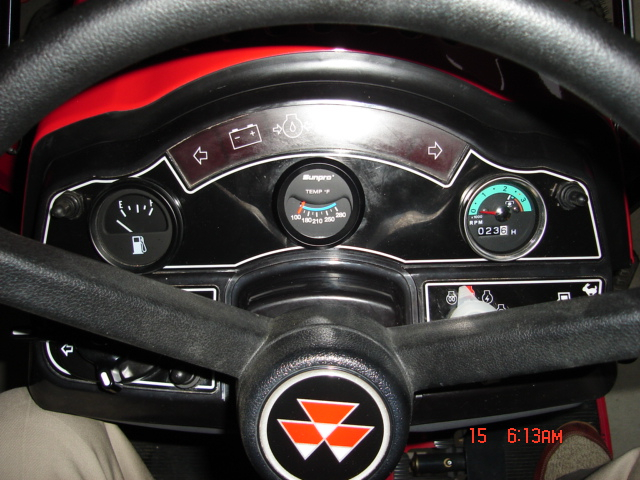

I put an aftermarket temp gauge on mine, a typical car version with a 2" bezel. On the 2300, there's actually a hole already there, in the center of the instrument panel, just covered by the stick-on plastic cover. Was it the 2400-series that had a completely new instrument panel? (And didn't they come with a temp gauge?)
That was a number of years ago, however, and the gauge eventually quit - there was moisture under the glass, as it wasn't really designed for mounting in an exposed location-- but installation was straightforward. One of these days I'll replace it, I guess.
See if you can find my post on that.
