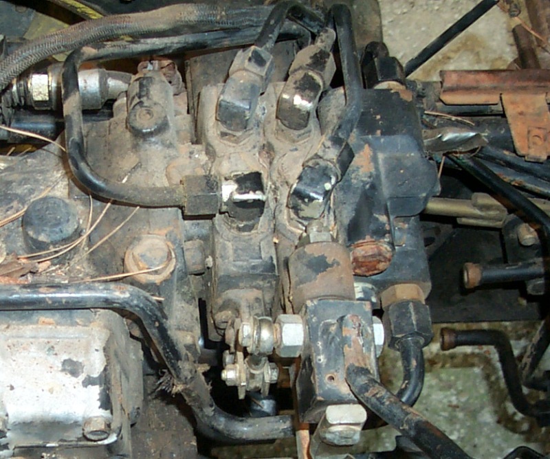

Here is a picture of the existing SCV's on my 955.
From right to left, Flow Divider, Regenerative valve, Float valve, Rockshaft cylinder head. I have the SCV's off of another tractor and was wondering... can additional SCV's be stacked onto the current configuration (either between the Rockshaft head and float valve or between the flow divider and regen valve)? I realize that modifications to some of the hard lines would need to be made which reduces the practability of doing so, but in theory, would it work?
That may work. But, wouldn't you have some clearance issues with
the sheet metal that goes below the front of the seat? You would also
have to fabricate a control lever and be able to fit it and the linkage
into that tight area.

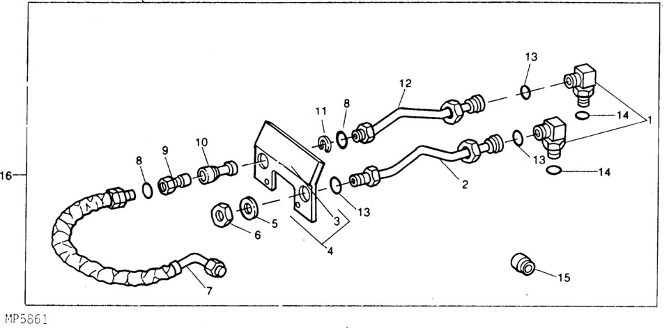

It is quite easy to get the diverter plug and set up a power beyond loop
for additional valves. Here is a diagram of the OEM kit. I only bought
the plug (#15) from JD, and used standard fittings and hoses to hook up a
2-spool AUX valve and backhoe.
the sheet metal that goes below the front of the seat?...
What sheet metal? :laughing:
You would also
Yes, that would have to be done. As stated, it's not very practical, was more of a "can it be done, in theory" question.
I'm assuming you just used an open-center 2-spool valve and Tee'd the return line back into the sump? Just where, exactly, does the plug get installed? Thanks...

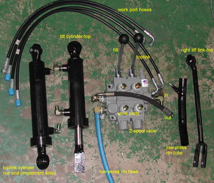

I made a TnT kit for a guy who had one of my 955 refurbs. I used
a Prince 2-spool valve with PB, and a low press rtn that T-ed into the
return pipe on the back. You can see the fitting I welded into the OEM
pipe at the right in this photo. I installed the valve on the LEFT fender as
there was no room on the right.
