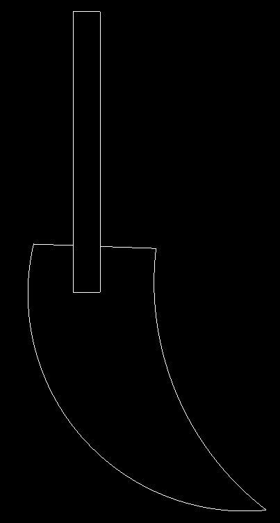

I assume it will look something like this? You can make nice fillet welds on both sides of the plate and the strength should be fine. The 308l rod I've used makes a nice weld. Position the piece so you are welding in the flat.
Yes....like that, except that the rudder itself is rectangular. The stainless is 316 (super corrosion-proof) and so I'm using 316 rod.
