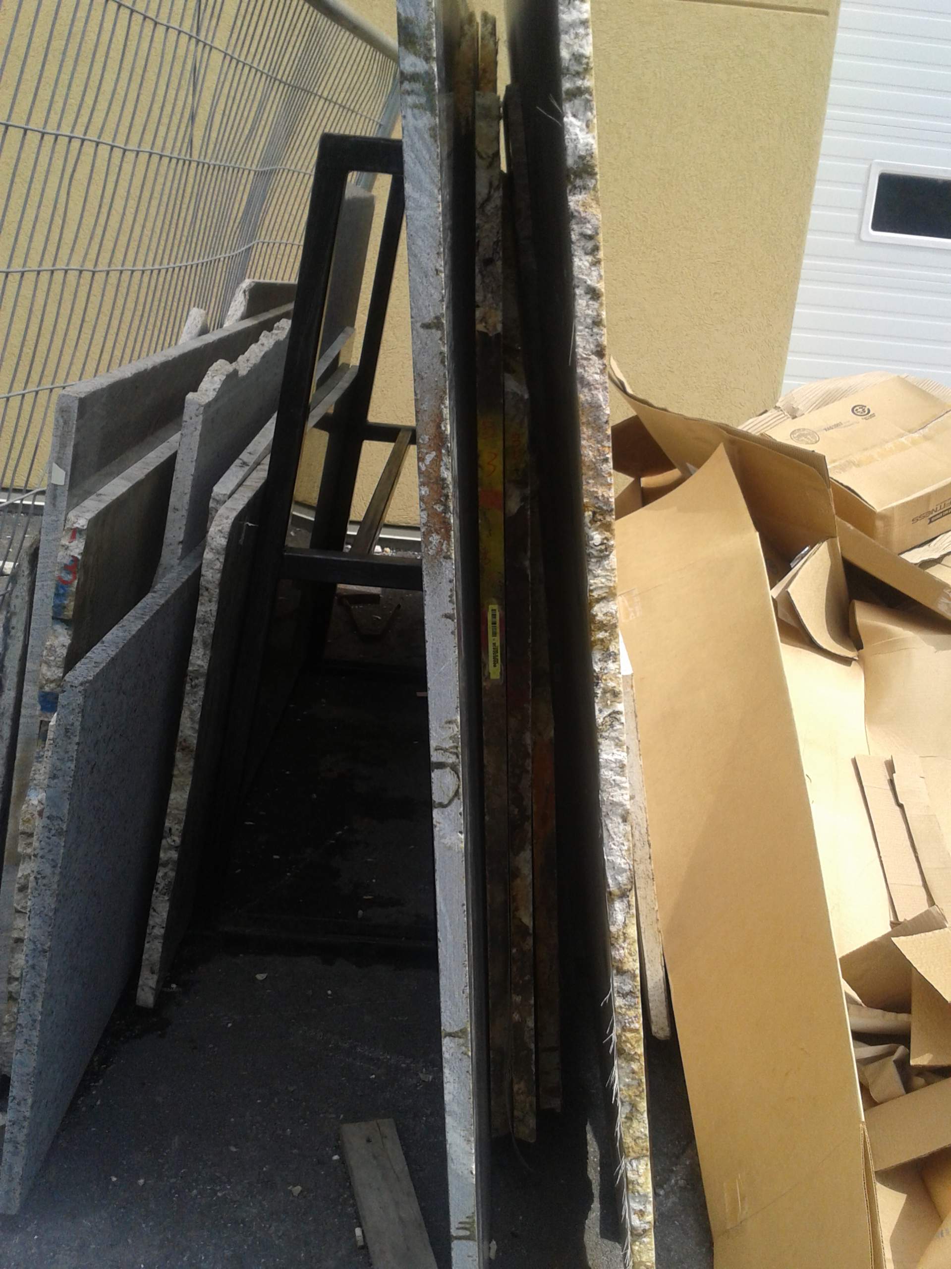

OK, you're all right about this. I've looked into a U-haul truck/trailer with a 6K# capacity and can get one on Sunday for under $100. Since I have to take my tractor to load (the building owner is not willing to load for me), pulling my friends trailer with my tractor and having my wife drive the U-haul would get it done in one load.
I don't think I'm going to go that way. Here's my current plan (all thoughts are welcome but I already know I'm nuts). Granite is very easy to weigh, you just take the sq/ft and multiply by 18 (for 1.25" granite). That will let me load the trailer fairly precisely to 5000#. At that point, I'll make a judgement call. If the pile is almost gone, I'll load 1000-2000# on to my pallet forks and take it extra slow and easy. I would stack the rest on a pallet and come back with the trailer and my van and ask the owner to load the rest for me. He really wants it all gone (that was part of the deal) and at that point, I'll have 20X the granite I'll ever use, so I have no problem walking away if he refuses. If I load 5000# and the pile is only half done, I'll make two trips, which I expect would make it a 10hr day at the minimum.
"Sounds like you are getting $10K worth of granite for free, so a couple hundred for a truck/trailer is a no brainer." - at the prices I just paid for granite for my kitchen, I'm getting about $28000 worth of granite for $200 :thumbsup: Of course, that was cut and the edges were finished, but I love learning new tricks. The reason NOBODY else has taken this is that there isn't a full slab left. One is 6'X10', but has a crack at the top edge, none of the others are full slabs, some are close. Granite guys only want full slabs and preferably two from the same lot to do a full kitchen. Our kitchen was 2 slabs and they were able to match all the seams in the stone because they were consecutive pieces from the same block.

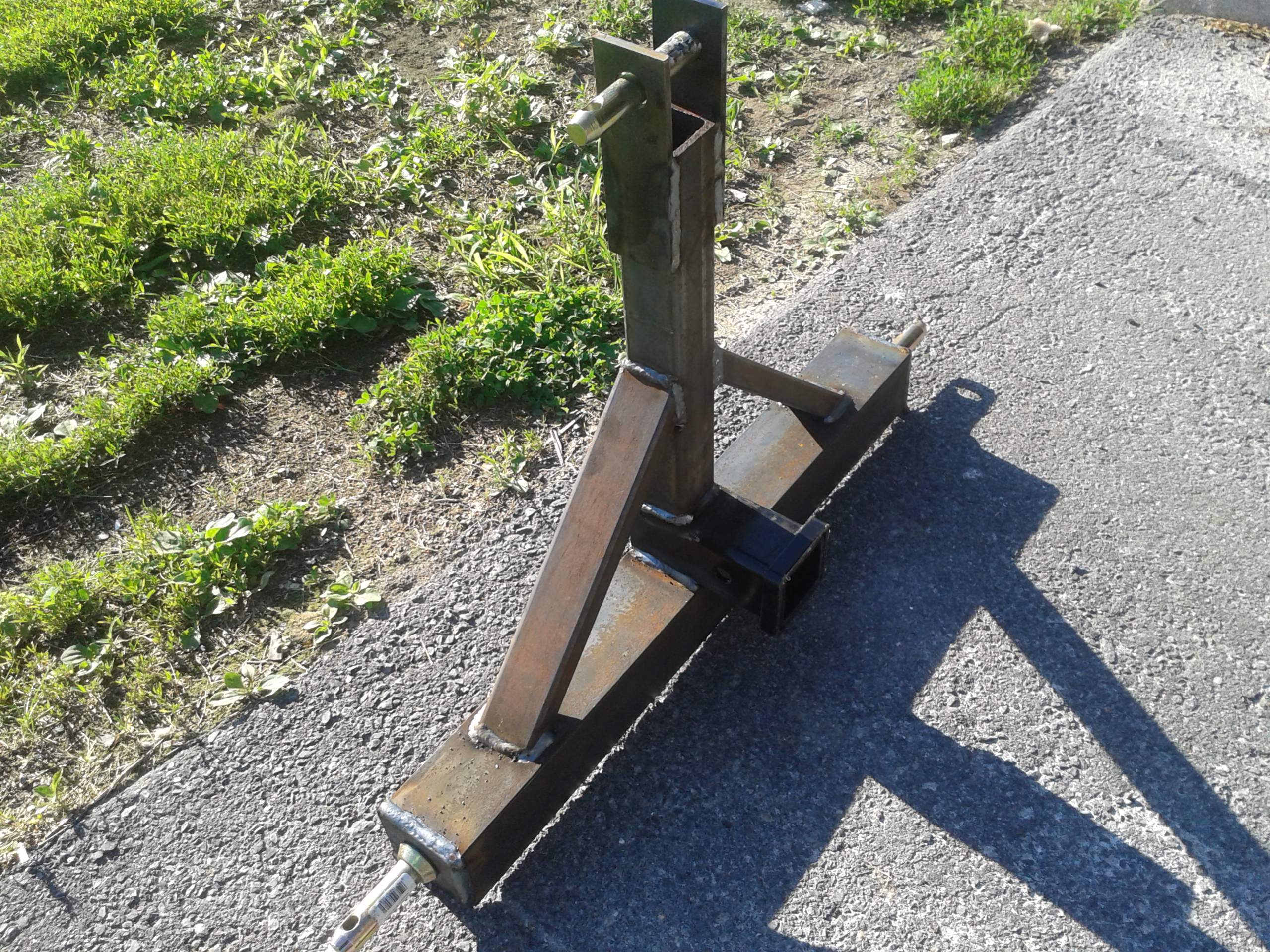

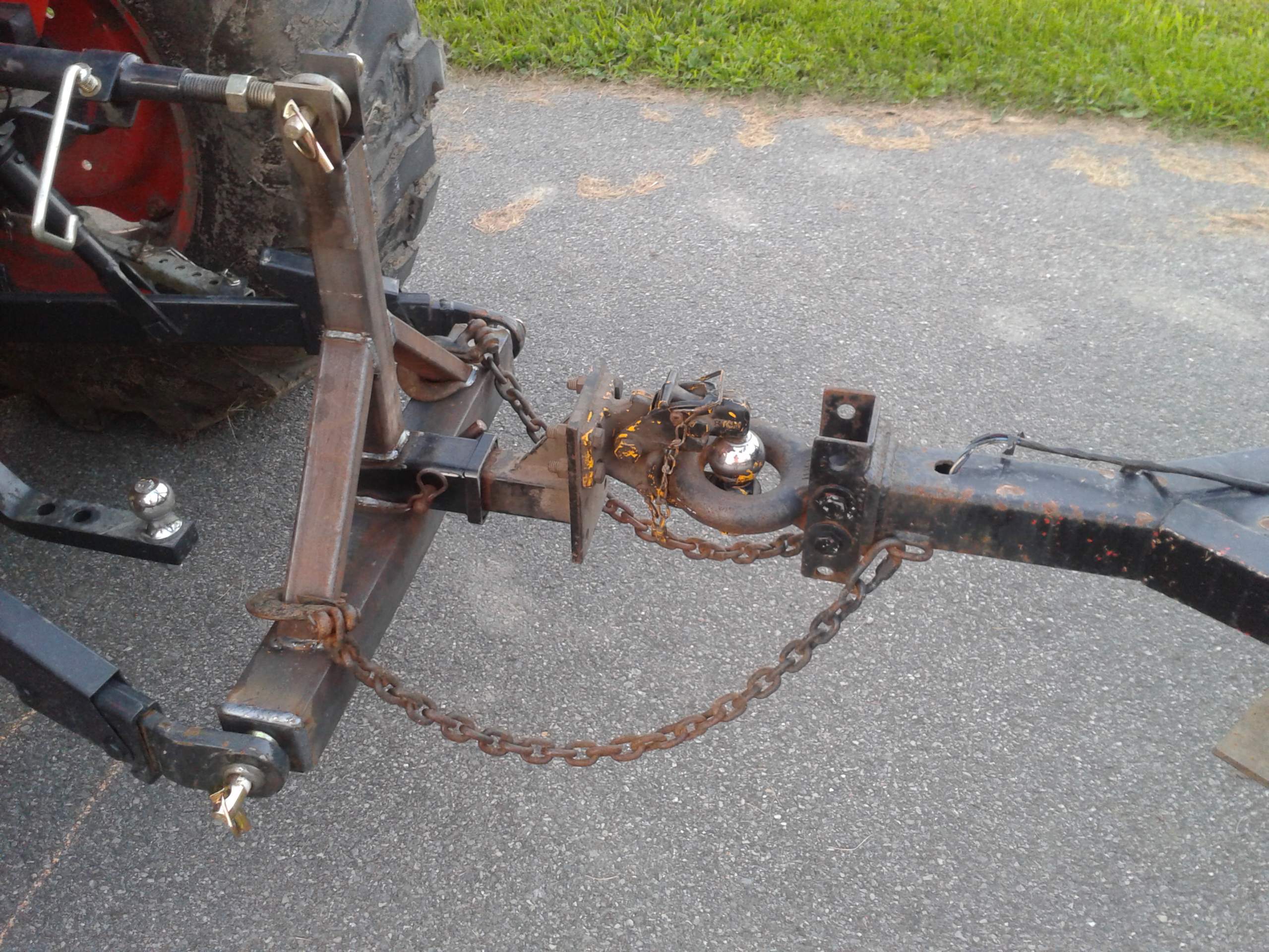

I finished step one last night. I finally got around to building a 3pt hitch receiver. Been done a million times here on TBN, but here's my version. May actually get some paint on it when all this is over.
Also, here's a pic of the granite. It doesn't really show how much is actually there and there's more lying on the ground.

I'm with you, everybody here is chicken to hillbilly engineer stuff. My only comment is that I think I would try to bolt the ball hitch right to the drawbar if possible. I'd be a little concerned about the 3 point. But you do have to report in how this went. The best stories come when you almost kill yourself but survive (and get the granite home)

If you do use the drawbar or the three-point, for goodness's sake, look up the max tongue weight/three-point weight and see if you're exceeding it, okay? Heck, for all we know, your tractor has a tow rating.

Well, the trailer has a pintle hitch so I have to use my friends hitch and a receiver on my 3pt hitch, there's no way to bolt it to the draw bar and that would set the trailer far to low.

Run a chain from the drawbar to the top of your 3 point hitch.
It is the law here (and a good idea) that the safety chains must be crossed under the tongue.
