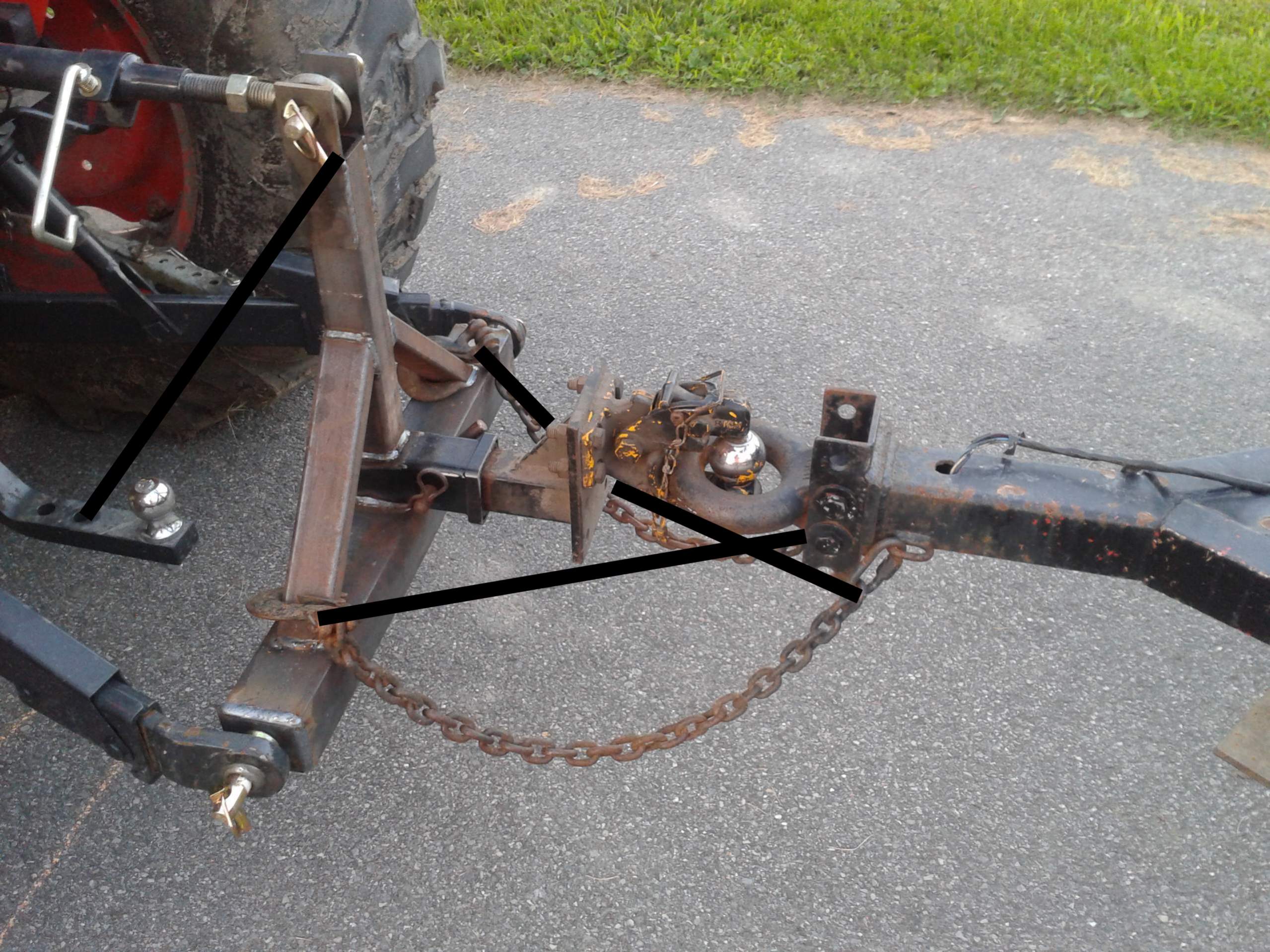

Run a chain from the drawbar to the top of your 3 point hitch.
It is the law here (and a good idea) that the safety chains must be crossed under the tongue.
I just noticed the safety chains not crossed when I posted the pic, my neighbour put them on when I picked the trailer up last night. I was going to weld a bracket onto the top of the hitch receiver to run a chain down to the draw bar, but forgot to do it when I built it. It's too late now, I have to much on the go tonight, but I will rig something up to run between the top link pin and the draw bar.

If you go for it, chain the hitch down like has been mentioned.

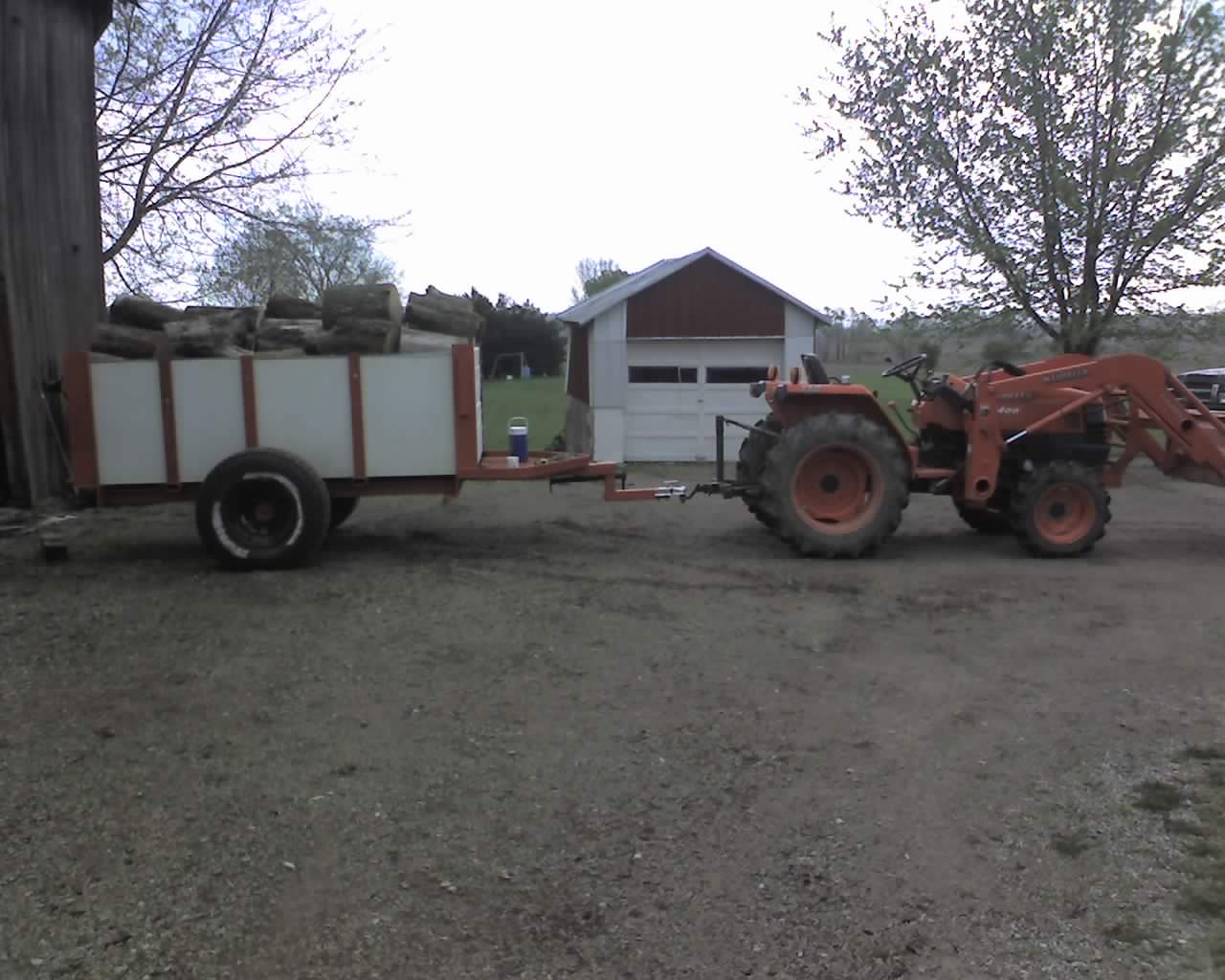

Wow, thanks, it's really good to here some real world experience. I guess you have a point that the trailer is designed to weigh 7000# and driven at 60 mph so a total of 9000# @ 16 mph shouldn't be an issue. Still, it's not my trailer, and by no means new, I'm nervous overloading it and since I haven't been able to get a tow rating for my tractor, unsure how much is safe on the tractor side, especially pulling from the 3pt.
I am going to avoid the hill so it's almost perfectly level road the entire way. It's actually shorter (who knew) but a 2 or even 3 lane road most of the way. I'll be leaving at 5am if all goes to plan so hopefully the drunks are safely in bed by then and I have the road mostly to myself. The advantage is I can stay in a lane without blocking traffic. The disadvantage is the posted limit is 80 KM/H (50 MPH) and most people do 100 KM/H during the day. I have a smv sign on my tractor and I'm putting another on the end of the trailer. I'll have the rear work lights on as well as my hazards. I sure would feel better with a set up like 4shorts!

I just got off the phone with my dealer. He said he'd have no concern what so ever with 3.5 ton. I then mentioned that I'd be drawing from the 3pt instead of the draw bar and he immediately said that was a bad idea because there's no down force as you guys have pointed out. I told him I was planning on loading a little front heavy and using a chain from the pin to the draw bar. He advises against loading too front heavy but agrees with the chain. He laughed and said "goodness no, you wont hurt it" when I asked about it being to much weight to pull from the 3pt, he was only concerned about it flying up.
