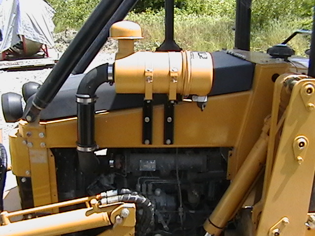

Nope. There are no domestic suppliers for an exact replacement, although there are some that will fit with a little modification. You will find that this is the only bulldozer on the entire planet that has the engine air intake in the direct path of the cooling fan. Perhaps an oversight or sheer stupidity. If you operate in very dusty conditions you will plug up that filter in a day, I've done it. I remote mounted a Donaldson air filter on mine.

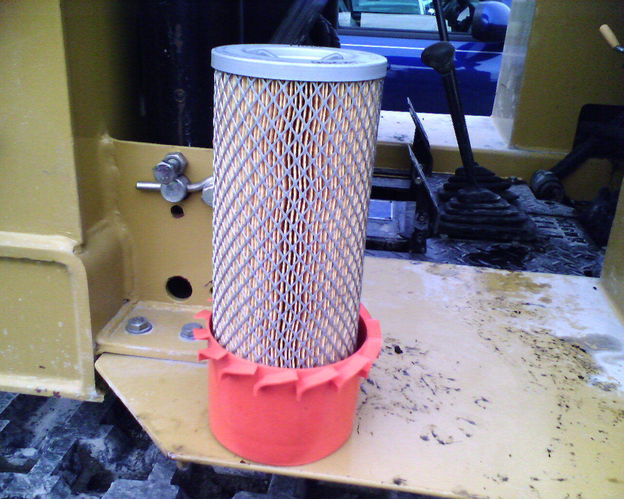

Maybe I am missing something or maybe my filter setup has been altered...
But I have a standard "round" air filter under the hood....
   / Advice on potential purchase (Nortrack 3500B) #28
Bob,

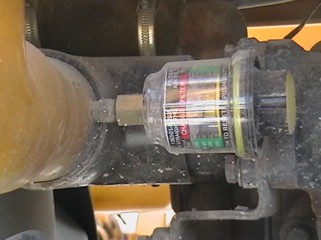

Yes, that's the stock filter arrangement. It requires a round filter that has a closed metal top attached to it. This will have to be checked daily under extremely dusty conditions or where you are doing brush hogging and stirring up a lot of flax. Consider installing a furnace filter in front of your radiator, it's an idea that I got from the wheelie tractor guys and it works great - keeps the radiator from plugging to and overheating the engine. The high end tractors will have a pusher fan to counter this issue. Another item to consider is an air restriction indicator - a nicetie that tells you when your air filter needs changing.

Ok got it!
I will first and foremost just replace the filter with something that can be easily modded to fit.
From there I will look into a true permanent solution as you have mentioned.
