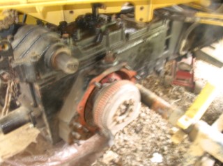

Plan on this.
   / Advice on potential purchase (Nortrack 3500B) #49
You may not have to pull it down that far if the problem is in the final drive. For now you don't have to block the dozer. Let me know when you're ready to start.

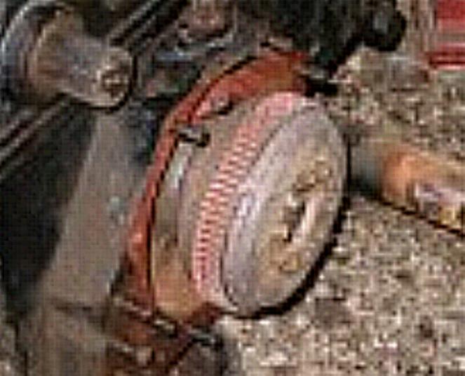

#50
Ok well the dozer is def getting power to both tracks.
The pendulum design picture of the steering pedal system doesnt apply to my dozer but I would imagine the linkage connections are the same.
Meaning the lever and rod below the deck is for brake application and the lever and rod next to my left foot is for the steering clutch? correct?
