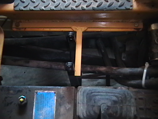

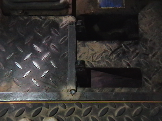

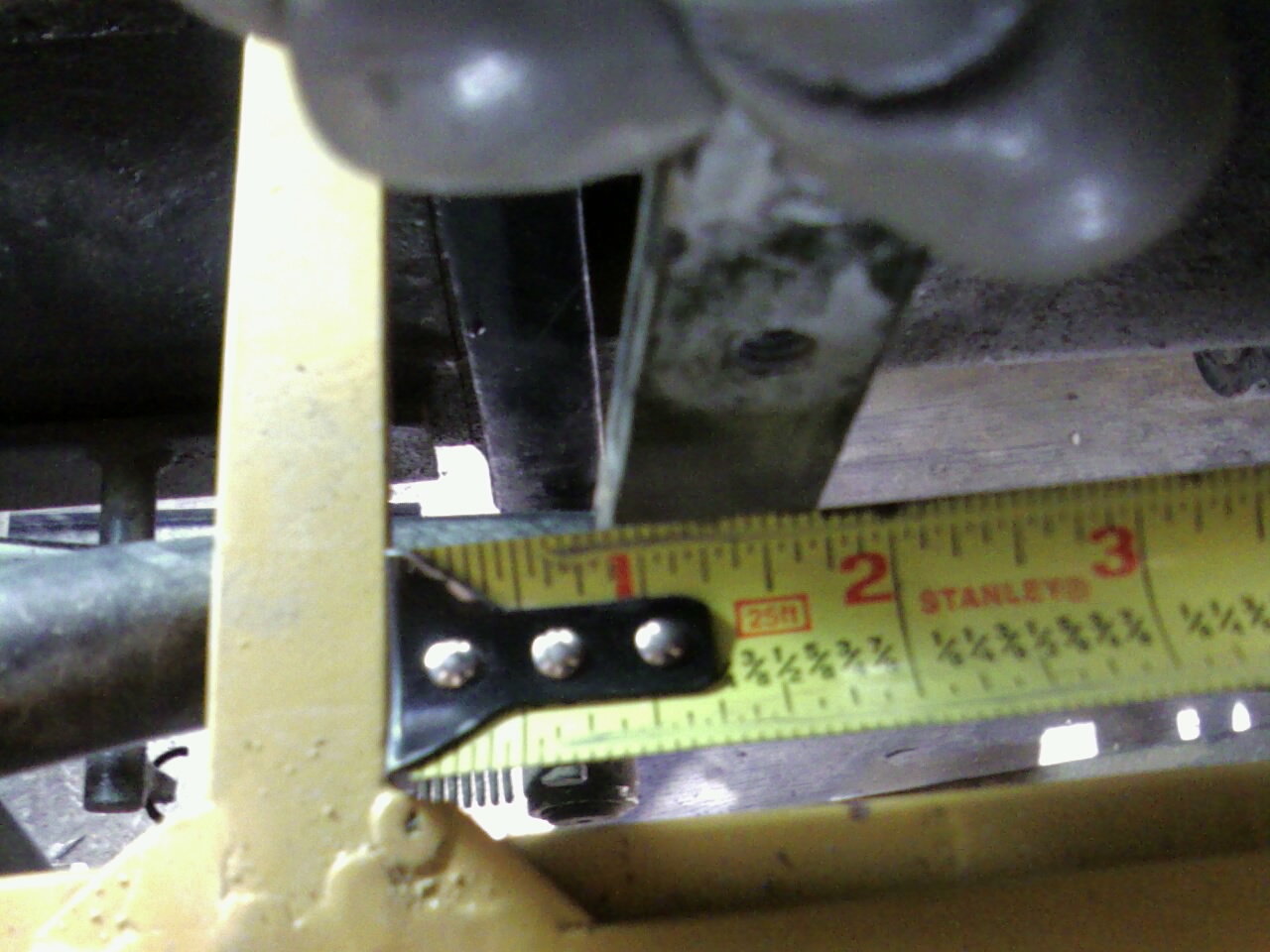

In the manual it shows brake and clutch adjustments for each side. I made a tool for making those adjustments with the floorboards removed. I think it's the only way I think it can be done. The tool is also used to adjust the main clutch on the left side.
