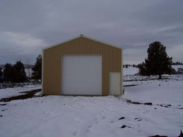

My shop is 24x48, with 14 foot sidewalls, 12x12 rollup door, a loft and an office...
And it's full.
Go BIG !

bajabum: That is a nice building, about the size I plan to build. Did you buy a Kit, or make your own plans? I do not think I have seen a truss layout like that. Looks like 2 trusses next to each other then a long distance, maybe 10' to the next. Sure looks like a nice layout.

Kingrace,
I had a local contractor do it, from scratch, just him and his son.
The rafters are indeed doubled, 12 foot on center.
The building is solid, but he could have done a better job on the floor, not a single expansion joint...
I'm planning on adding wings later.
Like I said, It's full already!
