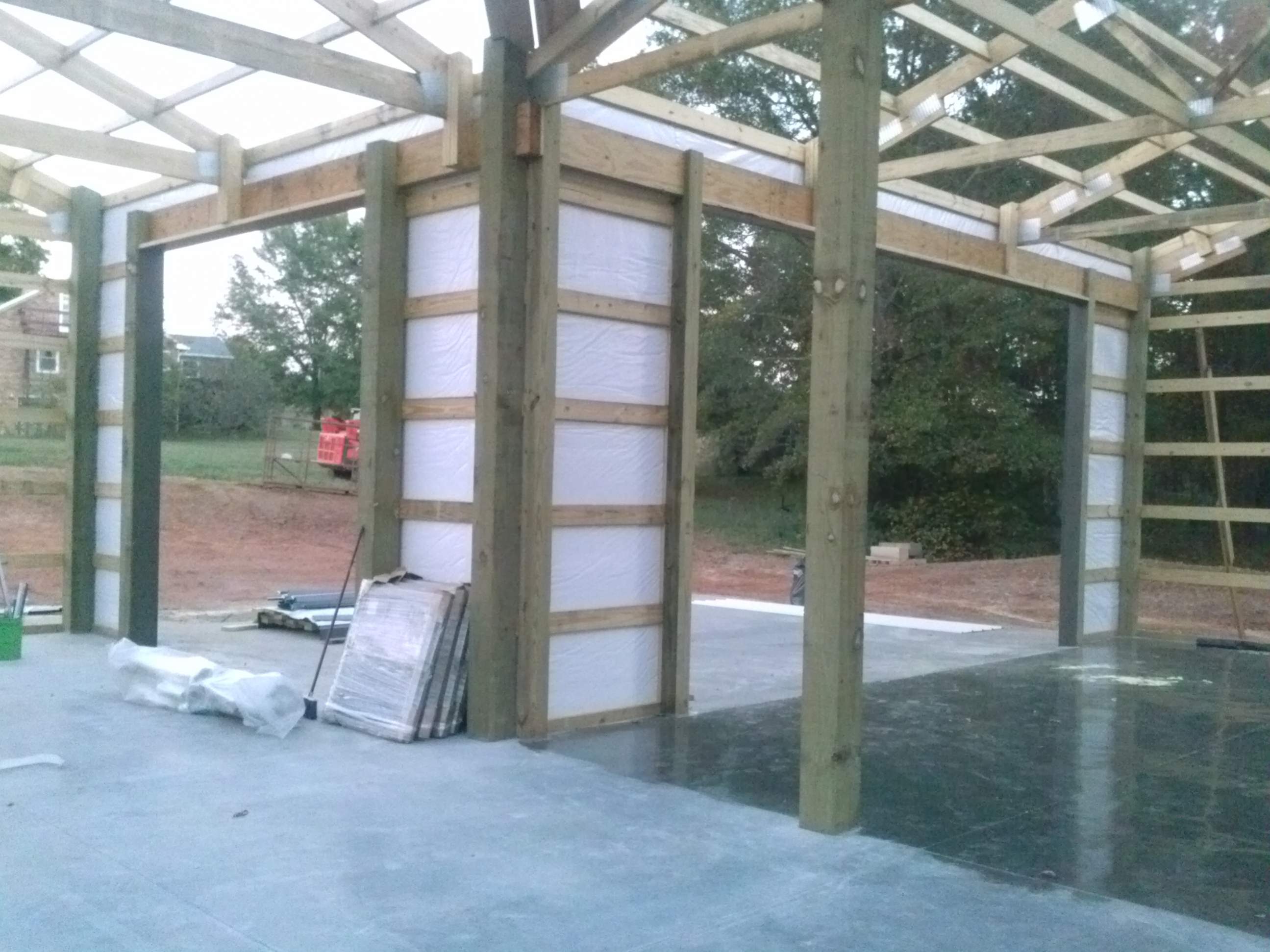

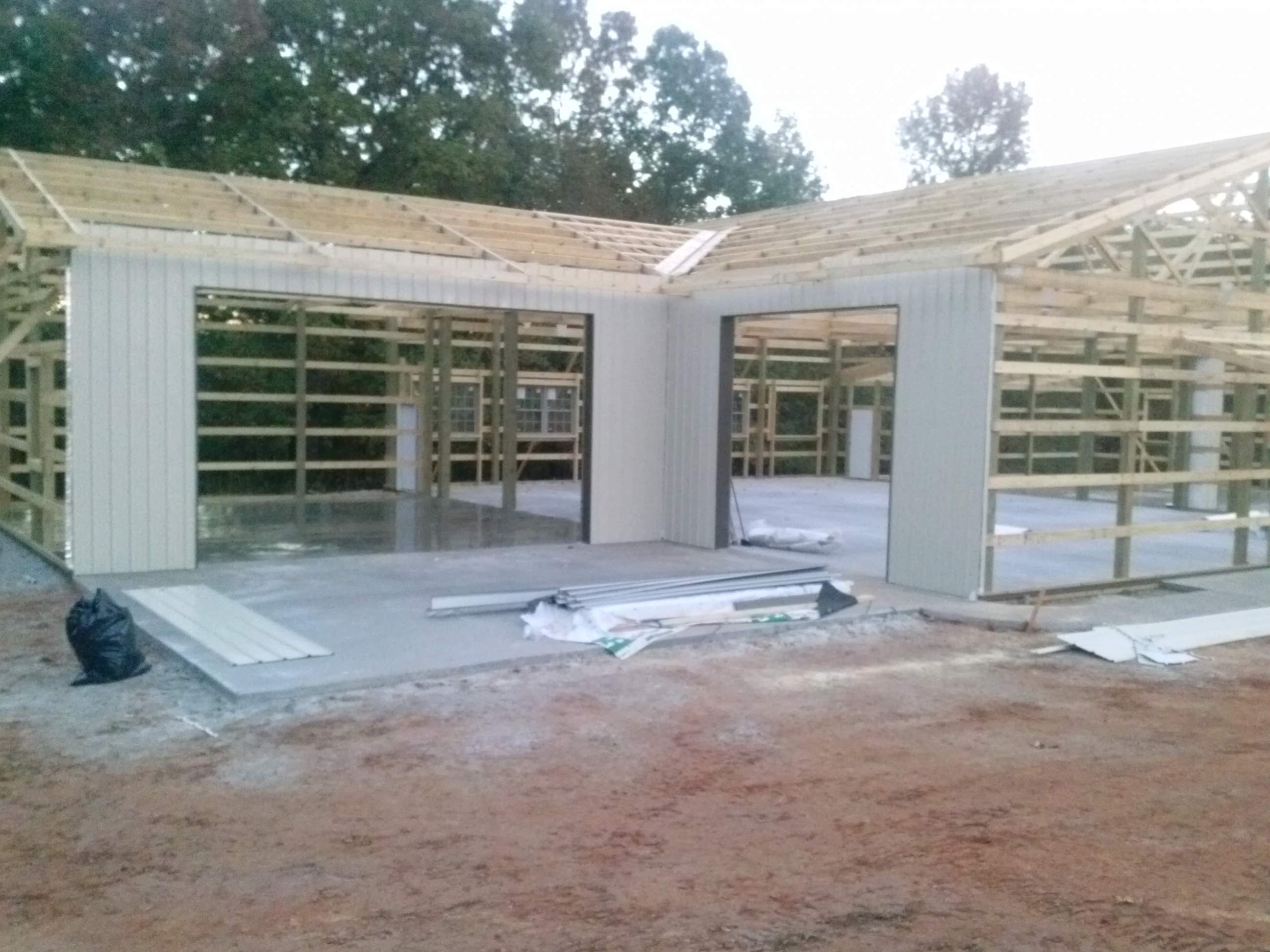

Eddie - I'll definitely post a response after the inspector comes through. I will ask him specifically about the purlins and how they are attached. Attaching a couple more pics with progress. CAM00206.jpgCAM00207.jpg
   / Advise on new metal barn #33
3 things, as BAP said, there's no diagonal bracing in this building, the posts should be braced and so should the roof, I disagree with Eddie, sheet metal won't substitute for bracing. What are you enclosing the structure with? I see metal on the outside but is it foam and plastic sheeting against your wall purlins? Are you going to insulate your walls between posts? If so, I wouldn't use plastic sheeting inside that wall structure.

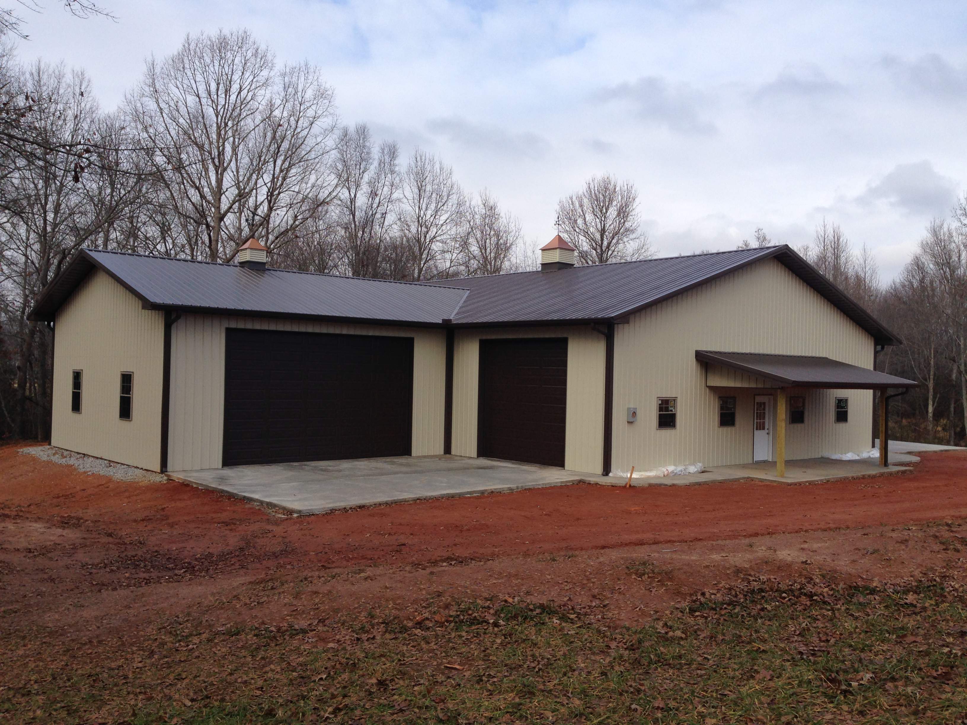

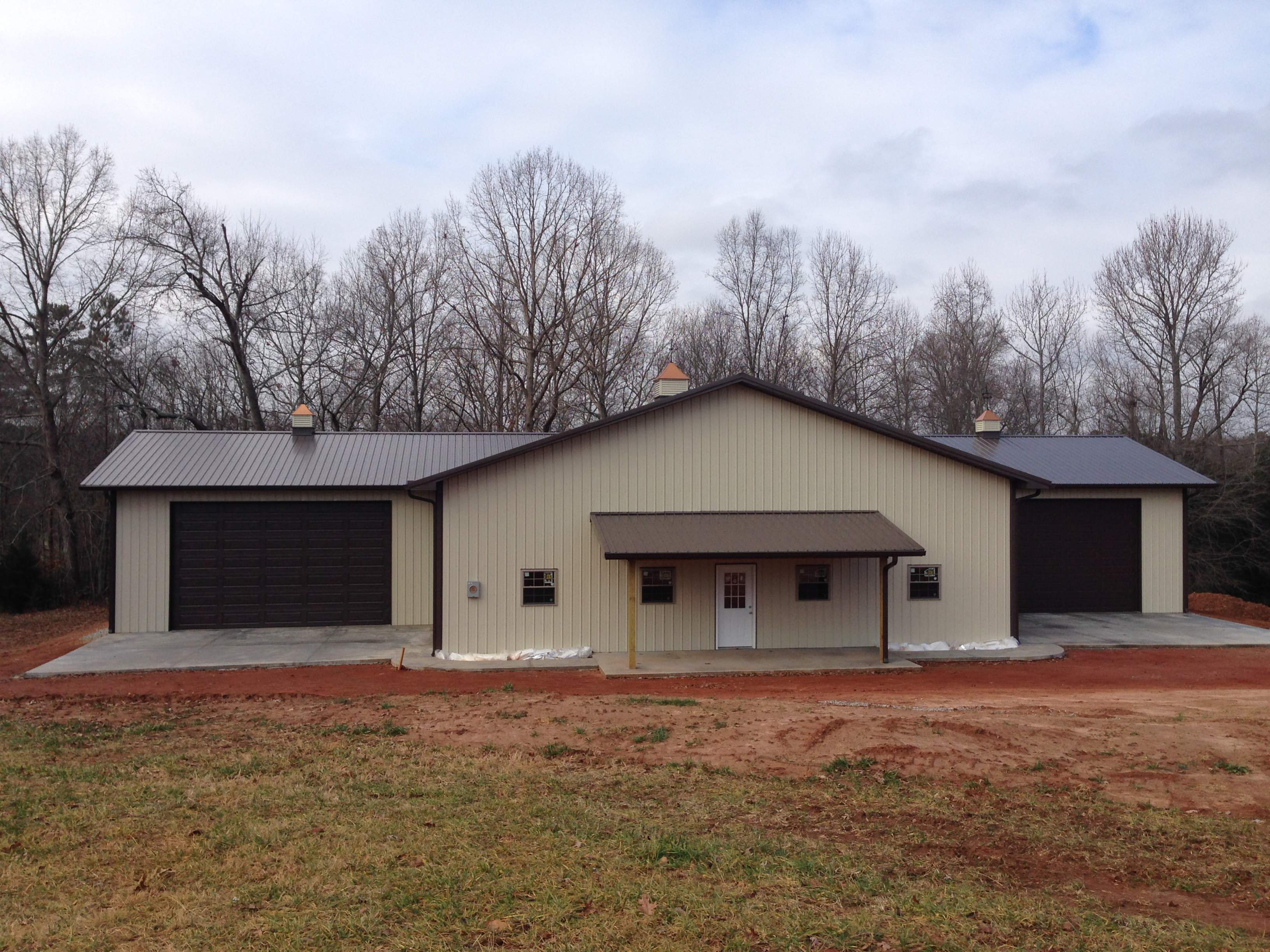

The barn finished up right around Christmas. Attaching a couple pics. Was happy with everything, except there were a few cracks in the cement eminating from around some of the posts. Wondering if they didn't do a great job of compaction after drilling holes and placing posts.barn04.jpgbarn05.jpg
   / Advise on new metal barn #35
The barn finished up right around Christmas. Attaching a couple pics. Was happy with everything, except there were a few cracks in the cement eminating from around some of the posts. Wondering if they didn't do a great job of compaction after drilling holes and placing posts.<img src="http://www.tractorbynet.com/forums/attachment.php?attachmentid=417125"/><img src="http://www.tractorbynet.com/forums/attachment.php?attachmentid=417126"/>
Concrete does 3 things; gets hard, turns grey, and cracks. With enough add mixtures you can prevent #1 and #2, is what they say. In all seriousness, if you can't make a dime stand up in the crack, don't worry. They probably should have cut control joints at the post footers, but all that would do is control the location of the cracks.
Edit: btw it's a nice looking barn

One of the cracks may be approaching dime width, so I'll have to keep an eye on that. Thanks!
