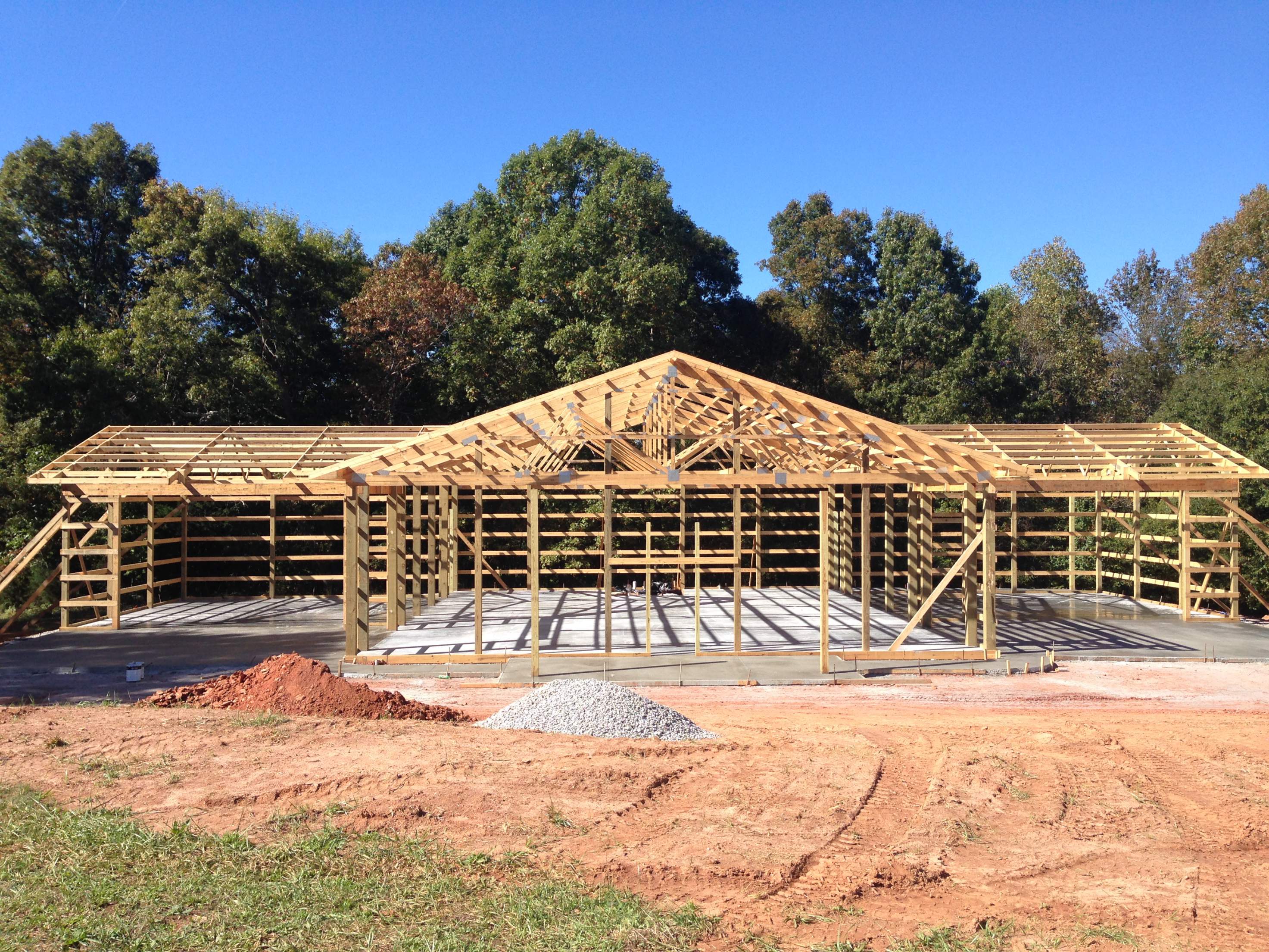

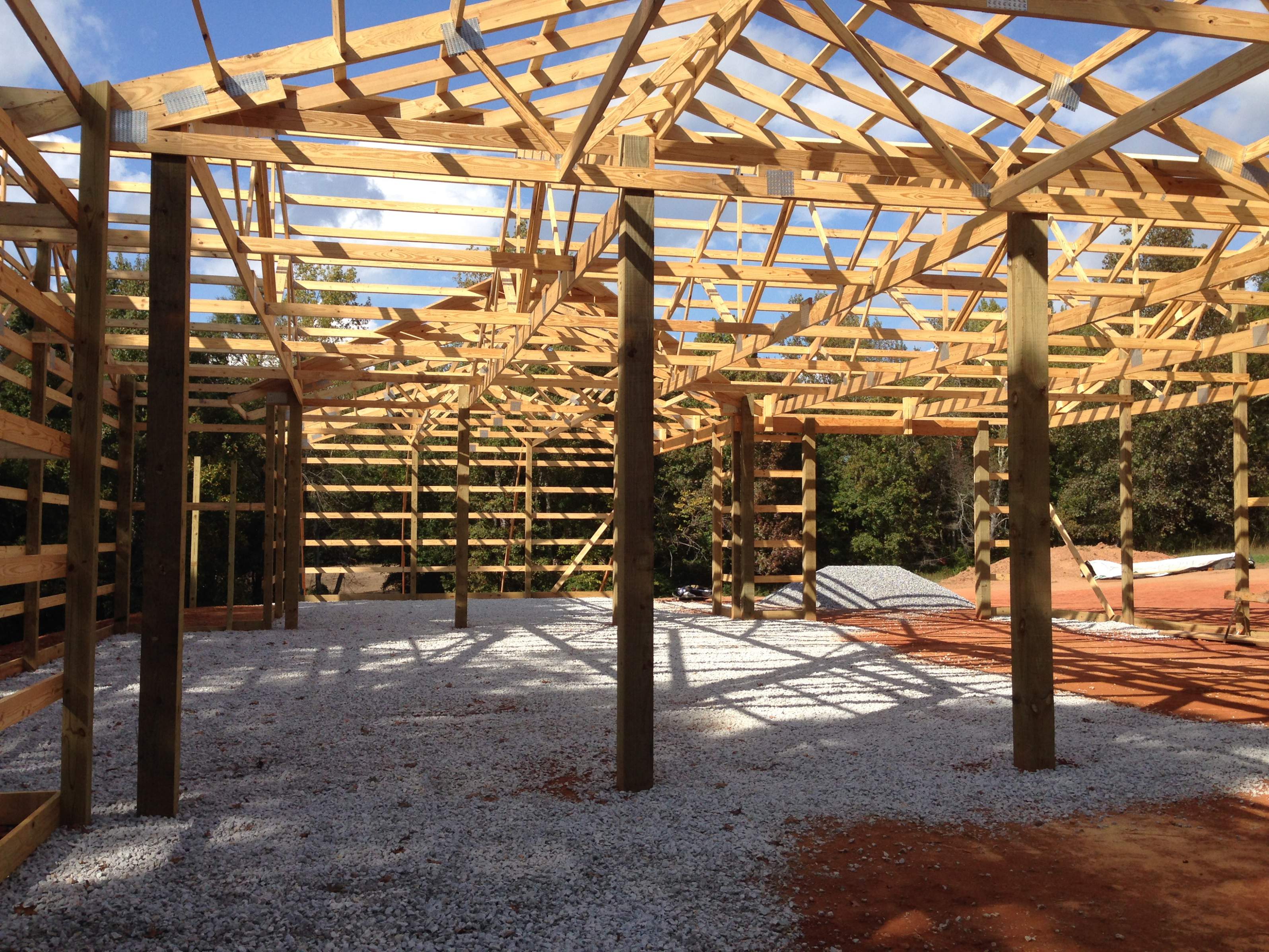

Attaching a couple pics with the construction in progress. I'm getting ready to have power company come out. I'll be having them put in a transformer that will feed the barn as well as a 5500 sq foot house. Any reason to consider more than 200 amp service for the barn or the house?
Thanks

Interesting roof. How far are the trusses spaced and what size lumber are you using for the purlins between the trusses? Did they just nail the purlins to the trusses into the ends of the purlins?
Eddie

The trusses are spaced 10 feet apart. Lumber size for purlins between trusses is 2x6. And I believe they nailed the purlins into the joist hangers on the trusses. Not sure I can have them change anything at this point, but does any of this cause an issue?

I don't know if it's a problem or not. I wouldn't have gone that far with a 2x6. Joist hangers help, but ten feet seems to be pushing it for me. I was thinking of doing something similar, but was hesitant at 8 feet. I'll probably put my purlins on top of the trusses just to make sure.
Thanks
Eddie

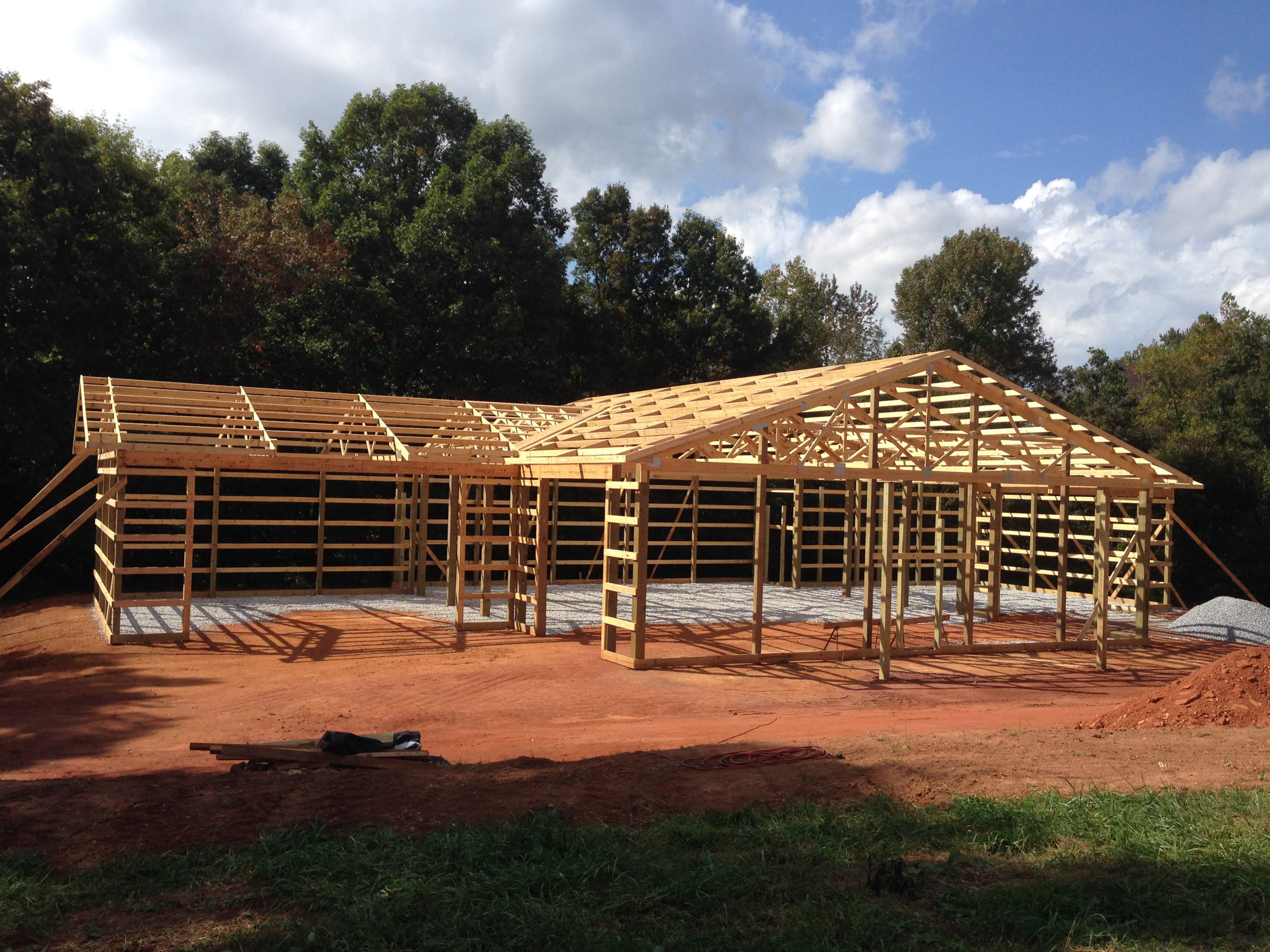

I talked to my builder. He is from Michigan originally and said up there because of the snow potential, they do 8 feet between trusses. He said in SC 10 feet was sufficient. Not sure if that is accurate, but I'm just passing along. They require inspections where I am in SC, so I can runy by the inspector when he shows up as well. Had the concrete poured over the weekend and am attaching a photo. They cut the concrete every 10 feet and unfortunately a hairline crack already appeared in one of the sections. I have a question into the builder on that as it seems unusual, even if only on one small area of the pour. They also appeared to rush at the end as when they cut the concrete it didn't appear that the sealer was fully hardened, so there ended up being a lot of concrete dust infused into the sealer. I may ask them to polish it out and reseal, but not sure they will do as it might be quite a bit of effort. Barn03.jpg

I don't see any diagonal bracing between the post and plate and trusses in your pictures. Also, none in the trusses themselves, How do they keep the build from racking and twisting in heavy wind?

The spacing of the trusses isn't that big of a deal, it's the size of the purlins and how they are attached that makes me nervous. I don't know if it's wrong, it's just not how I would do it. I would really appreciate what your inspector says, especially how the purlins are attached between the trusses with nails into the end grain.
BAP,
The metal sheething on pole barns gives it the sheer strength for racking. The posts in the ground also add a lot of strength to the building. Once the meal all goes on, racking wont be a problem.
Eddie
