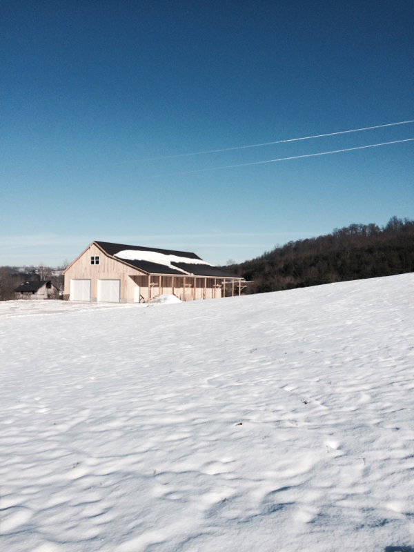

Yes it's the Tulip poplar tree. Grows upwards of 100' tall and is very straight. We have barns that are 100 years old with original siding. Just keep wood off ground where it can drip dry and your golden.

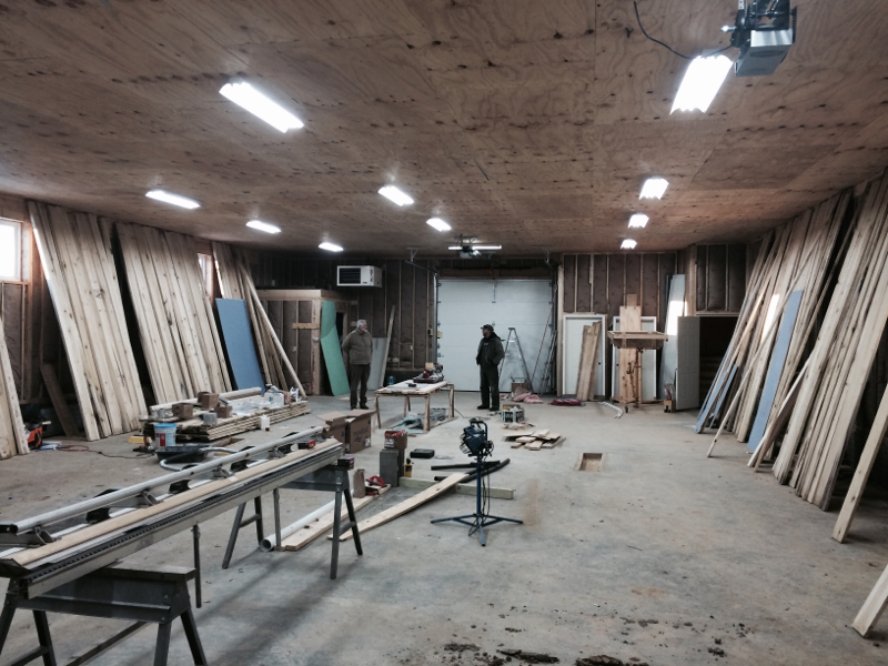

Tulip Poplar from my yard where I live. I hauled it to my property and made lots of sawdust with the sawmill.
