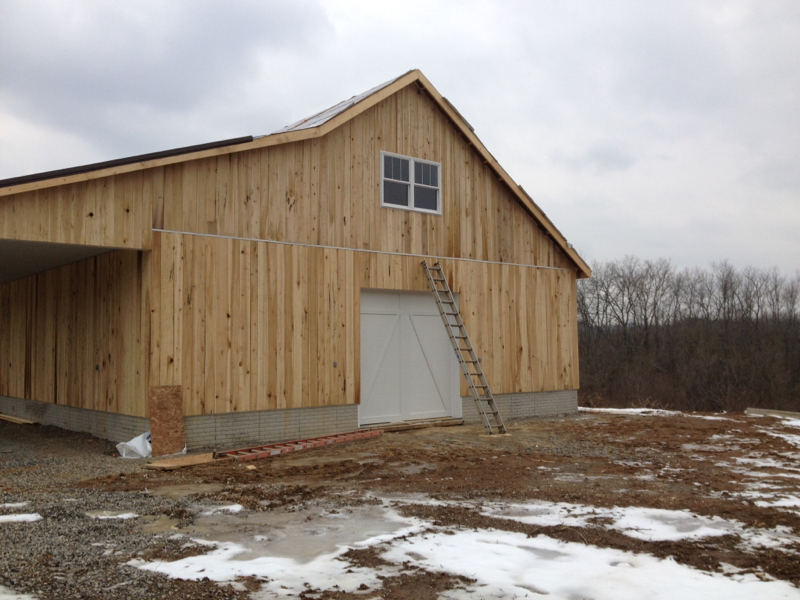

He said because he couldn't get long enough boards. Front of barn needs a few 14' sections and rear even taller. See rear of barn per attached picture. image-1679107283.jpg
Garage doors are 10' tall by the way.

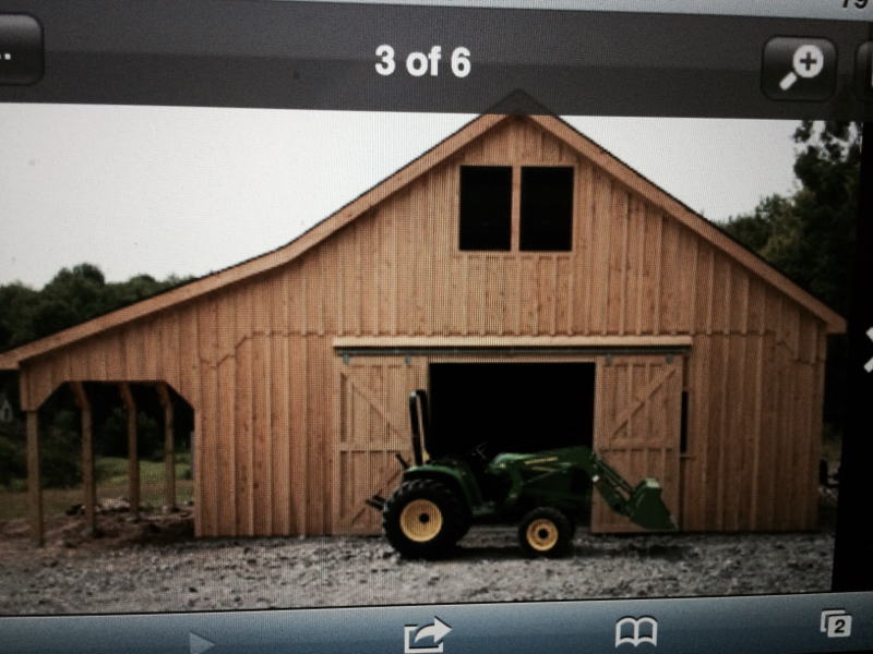

Ok after more thinking and reading I may have a idea. The original plan was to put on the battens this summer after the siding completely dries. So if we do this then put the extra layer of siding on the top portion as I mentioned earlier then the movement of the first layer of boards should be limited. Am I thinking correctly? Then we can install battens on the outer layer nailing them into the 1st layer. End result should come out something like attached picture. I will also make sure he puts bark side of boards pointed in toward barn or hump out so that the siding again draws in toward the barn itself.

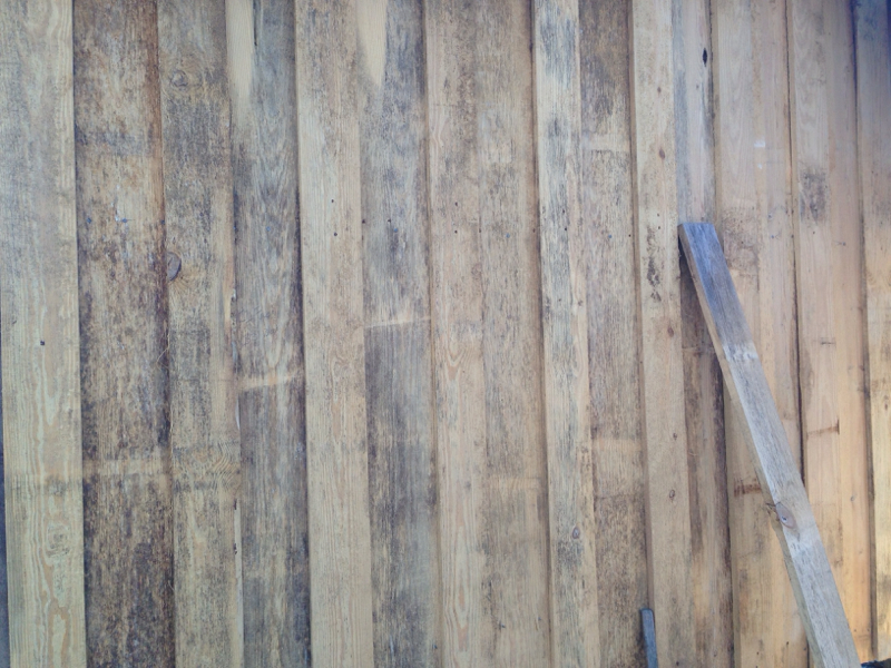

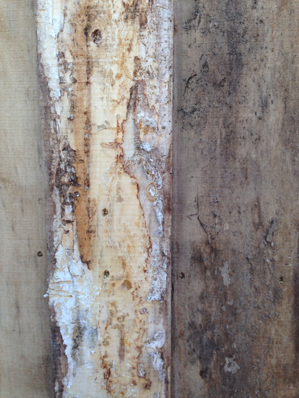

Here are some pics of one of my buildings and one of some poplar that didn't dry rite.
