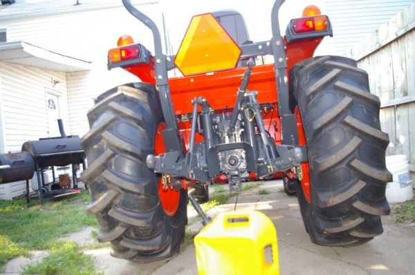

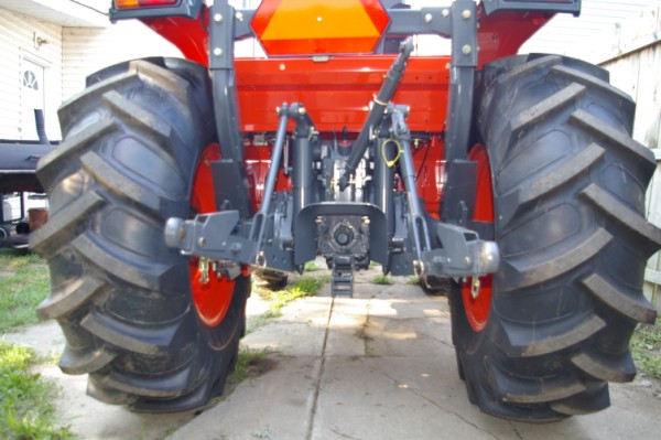

I have ags on mine and I am glad I do. I pull a brush hog and Decent grass and they only leave marks if I do a sharrp turn or it's muddy and i shouldn't be cutting anyways. I have Ags for a 3830 on my 3130 and i look at them as floatation ags. For me they serve the purpose of getting my jobs done. I think weight is the key as to what you are doing. You can " Float them" or weight them down and have them dig....
