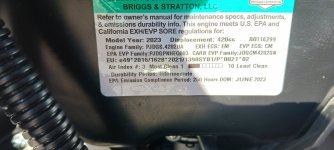

It seems its almost impossible to get something made in the good old USA anymore. Here is the spec plate on the Briggs in the L12. China has been slowly acquiring almost any company worth having. I think it started in the 90s.20231207_104518.jpg

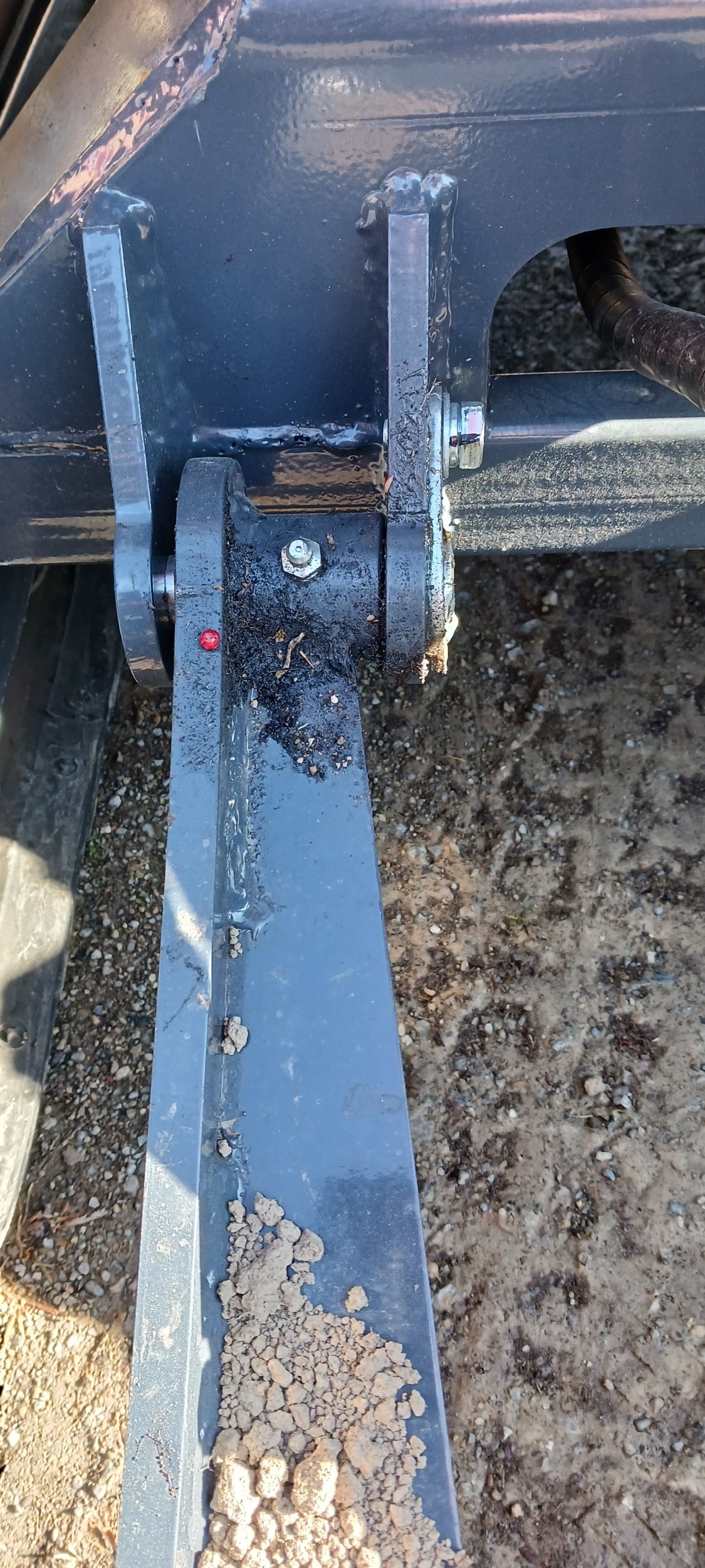

Something I dont understand is the grease fittings on the blade arms. All the other grease fittings work fine but these two refused to take grease. I removed them and found there is a white bushing in there with no hole for grease. is this a defect? Should I drill a hole in the white bushing?20231207_110232.jpg
That is a feature of poor quality control, coupled with the use of grease zerks that are not in the ends of the pins. In this location, pin-zerks would be harder to service so not ideal either. On my own machine, one of the blade cylinder zerks did not take grease. The easiest solution is to just unscrew the zerk and drill thru the bearing sleeve. There probably IS a hole in the bearing insert, but it rotated when it was pressed in. Or the assembler was supposed to drill a hole.
On any new equipment, it is important to take the grease gun to all the zerks (or needle grease fittings) right away to address this problem.

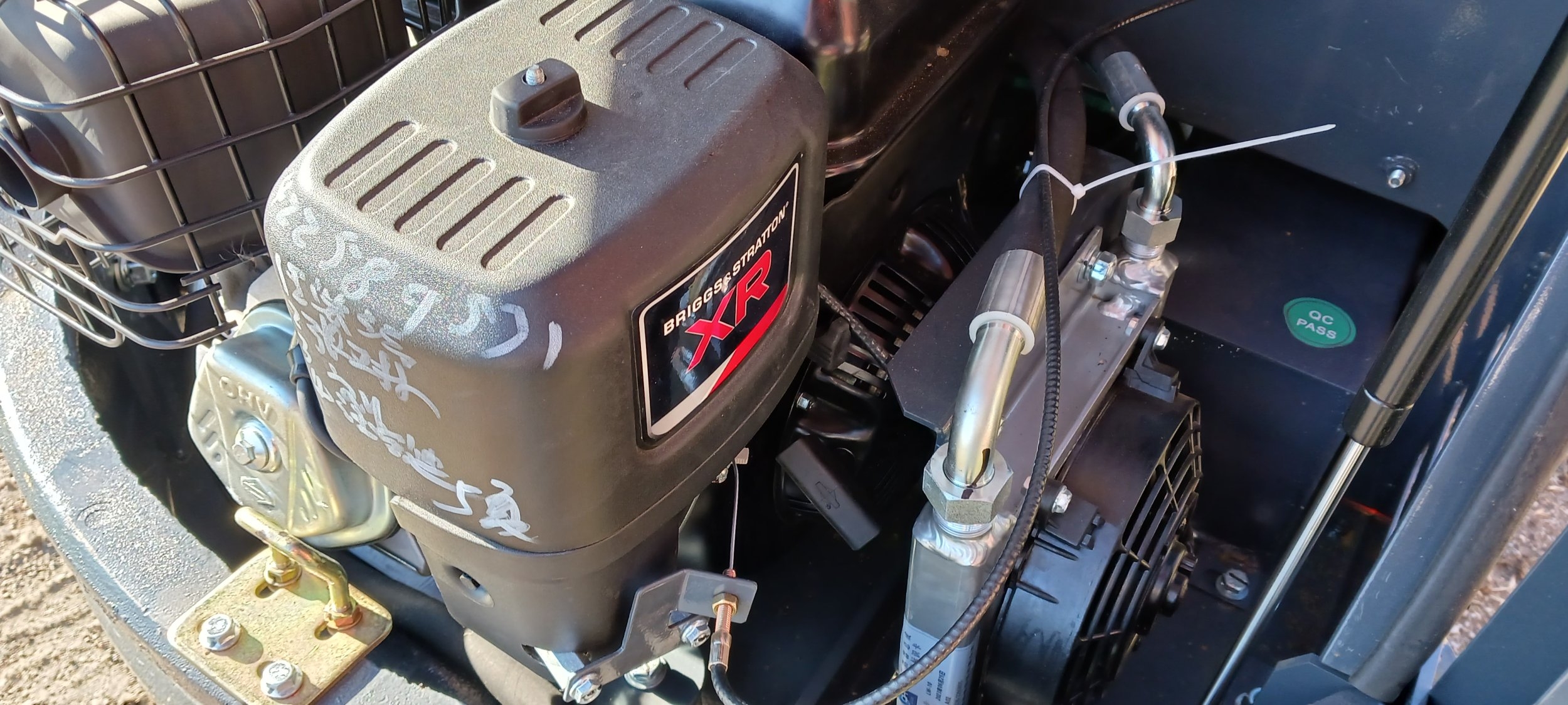

Thanks for the answer. I didn't want to drill holes without checking in here first. i found a minor issue with the choke on the Briggs engine. I noticed it cranked longer than it should when cold. with the choke cable pulled out as far as possible, I checked the little choke knob on the engine. it moved another quarter inch to the FULL choke position when I pushed it with my finger. The engine starts much quicker when you do this. The problem is with the bracket they used to attach the cable to the engine. It is not straight like it should be. I think there is enough room in the bracket for another hole to be drilled and this should solve the problem. I think that many of these machines with the Briggs will have this same issue. I hope this helps someone.20231207_104227.jpg
