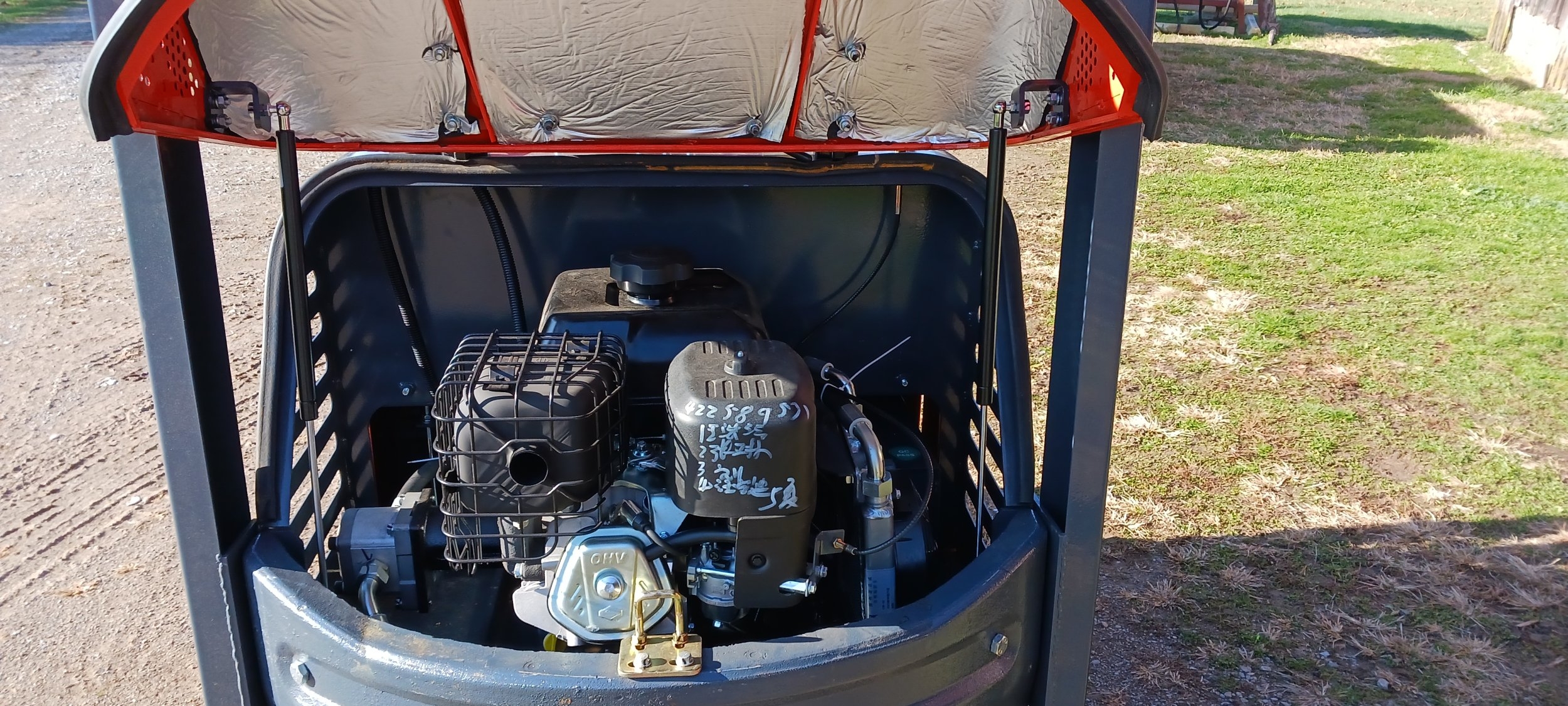

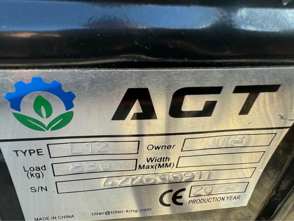

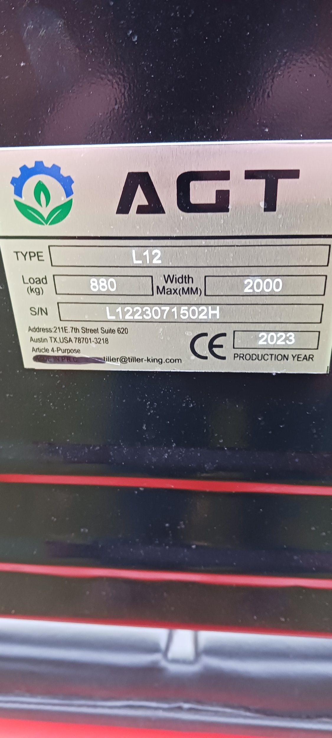

Sorry that your L12 has been a POS. I just bought 1 almost 2 weeks ago. I liked the way the L12 looked compared to the other models.. something unusual I have noticed is the identification plate.
Same model same year but you can see the difference. My L12 seems like a well made machine but I only have 10 hours on it. The tag on the right is mine. I sure would like to know why these are different .

Interesting tag differences. Besides the obvious quality of the one in the second picture two other big things I spot. Different weight 830kg vs 880kg and the serial numbers are not in the same format. The first one is simply numbered 422638911 whereas the second is L1223071502H. I am going to go out on a limb here and guess that AGT Industrial of America uses the 2nd serial number format and if you talk to them about parts for a machine lacking that type of serial number is when they will say it is not one of theirs. Parsing it to be model L12-date of July 2023 manufacture-1502 made- H series
I also note that the 2nd tag has an American Address and Purpose type to it.
A person might be well served to inspect ahead of time before buying an Auction sourced Baby Ex.
ETA. BTW I do like the fully opening back cover on your L12. Much easier engine access than my Typhon.

As to the hood,---- that is why I bid on this one. They had H-12's out the wazoo on the auction and after looking at that model --- I wouldnt take one home if they gave it to me! Cant get to the motor on them!!!
