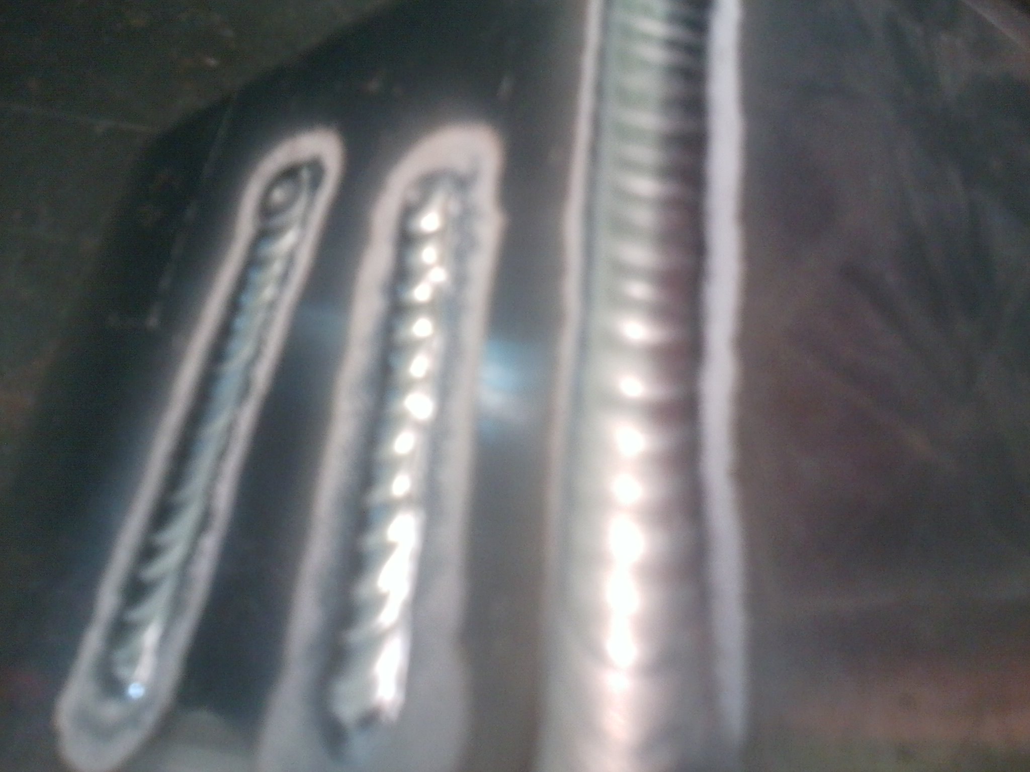

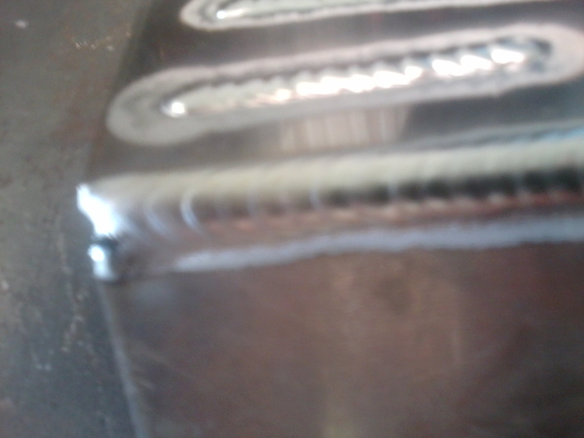

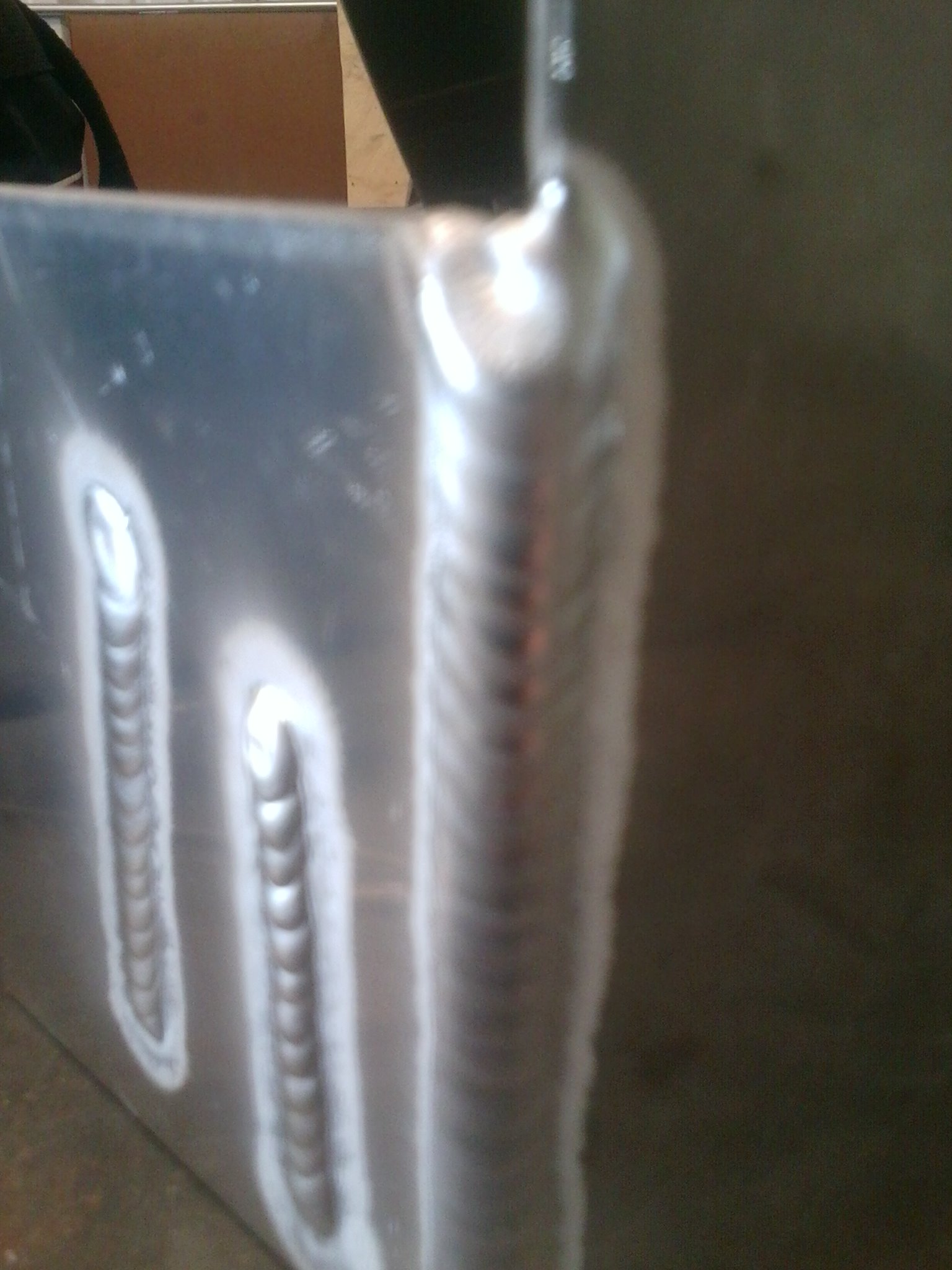

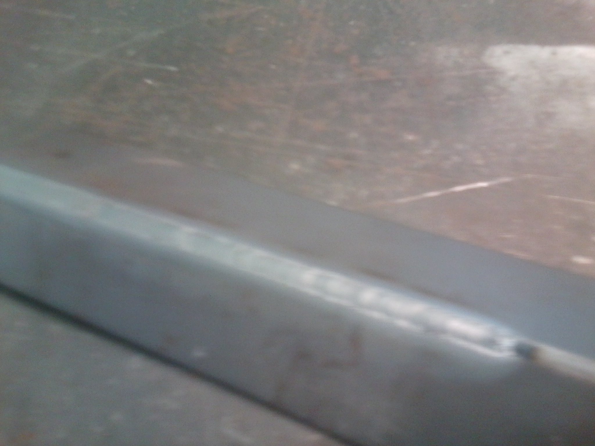

AHP Test 22ga steel.jpgAHP Test alum0.jpgAHP Test alum1.jpgAHP Test alum2.jpgundefinedAHP Test 22ga steel.jpgAHP Test alum0.jpgAHP Test alum1.jpgAHP Test alum2.jpg
I bought it on Amazon $719 + $30 shipping. Looks like they've gone up a little. I can see them going up quite a bit more if the reviews stay solid. Tried to upload some pics, if they don't work click the photobucket link:
AHP Test Welds Photos by kfawcett52 | Photobucket
   / Ahp Tig welder 200x #48
Those are some nice looking Tig welds! :thumbsup::thumbsup:
   / Ahp Tig welder 200x #49
Wish I could take credit for them, but the guy (Kenny) is an artist and that's no joke. Those are actually his first 5 beads using that machine and he ran them very quickly. Took him a couple of tries to get the AC freq where he liked it. The Miller he uses does all that automatically. 80hz was the sweet spot for that 1/8 alum.
