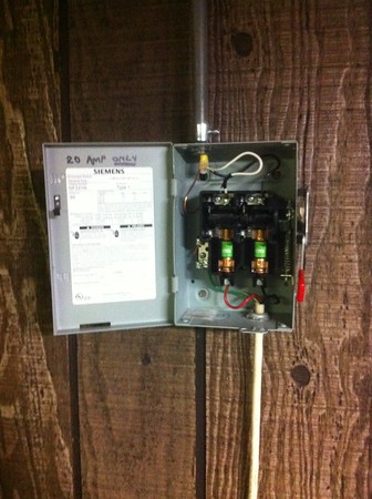

Anyway, IMO the ultimate electrical protection for the OP's compressor would be to install a separate, lockable, fused disconnect. Fuses rated for 'motor' use (time delay) might save the motor from itself if/when things go awry. (motor stall, etc) This type fuse (usually cartridge, btw) will allow motor start surges (brief, but ~ x7 FLA) but fully protect the motor if power wire/plug is sized to the load vs the main's '50/60?' amps.
A plug for that specific amperage would be best on/in that 'box'. Other guys on the main circuit still draw as they're wired/fused. My 230v mill & lathe are wired this way as std shop practice. (tho' w/o plugs) tog

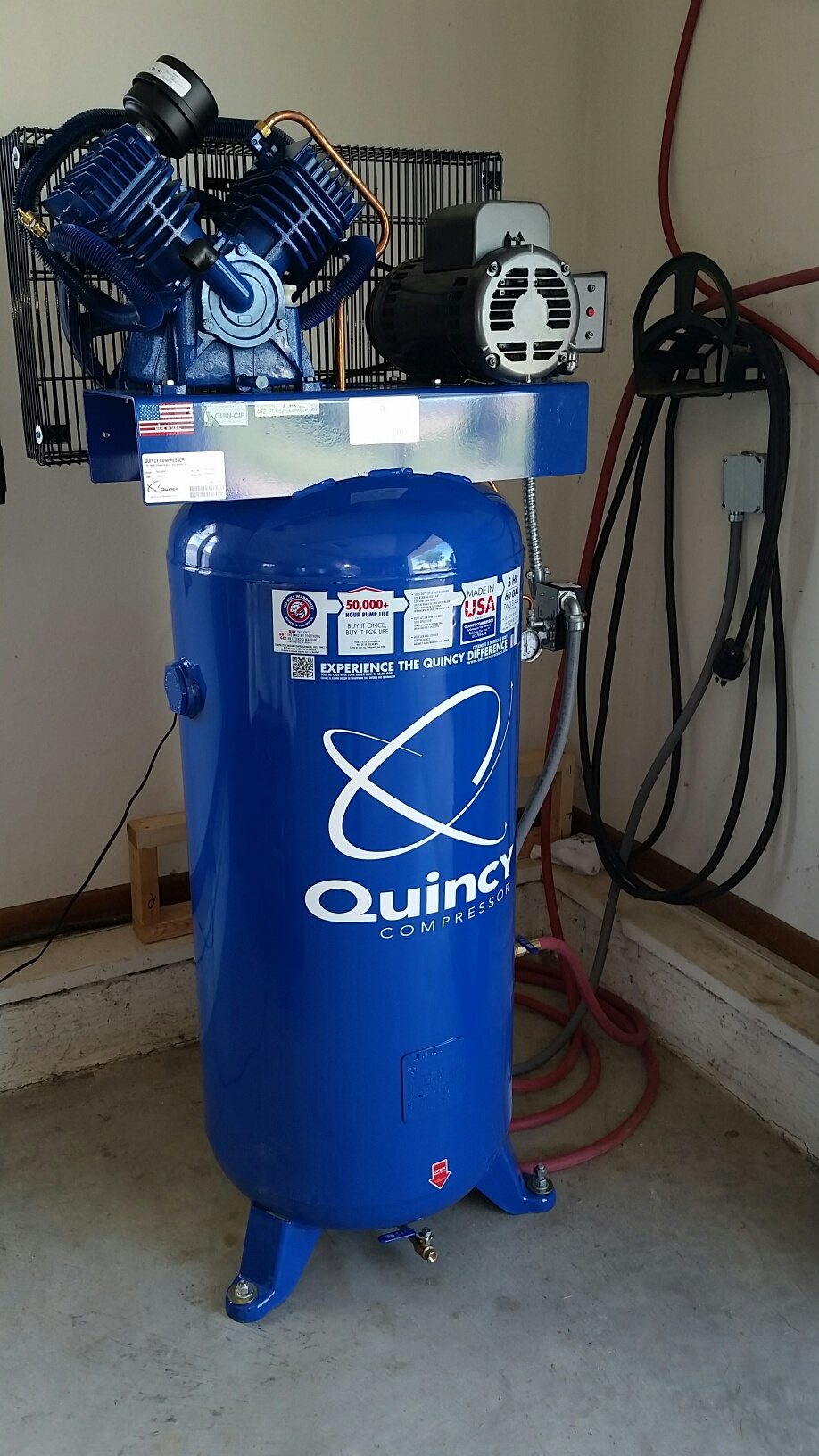

Now, for an update;
I decided to have an electrician do the wiring. He said the load should be about 80% of the power supplied so he swapped the 60 map breaker for a 40 amp. He removed the welding plug, added a 2" extension to the wall box outlet and ran a flex-line to the compressor on/off switch. It looks much better than just running a pigtail to the wall, and I'm glad he did it this way.

I used a HVAC 6 awg whip with a 40 amp breaker. He made his lead a tad long for a bolt down mount.

The lead length was my decision, because.... Also hanging on the wall is the drop cord to connect my generator to the transfer switch. I wanted the compressor power cable to be below the generator cable so it would be out of the way when i needed to hook up the generator during a power outage.

Don't know why he would swap out the existing 60amp for a 40amp ? The 60 amp is entirely legal according to code.

Maybe it was because of the size of the wire? The switch box on the compressor is only 4" tall, 2.25" wide and thick. It gets awfully busy in there with 2 clamp connectors, 3 wires in, 3 wires out and the on/off switch.

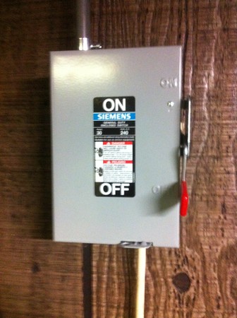

A 60A in the panel is OK to protect proper wiring to an outlet, but when hard-wired as bt's compressor is I would go with the motor rating* (FLA*) or the fixed lead to it, whichever is lower, for a safety margin.
* On many of our shop machines we use 'motor rated' fuses (time delay .. remember 'Fusestat'?) that will allow the x7 starting surge (<.5 sec) but blow at the continuous rating over a reasonably short time. We're doing similar to home AC units with a fused (or breaker) disconnect wired directly at the appliance.
2HP Lathe, 230v/30a panel/disconnect w/lockout (a must when servicing such, and to prevent unauthorized use.)
The line(s) is/are 12ga, with a 20a common trip breaker at the distribution panel.
(btw, I can hold a thou' tolerance on the lathe, but can't hold a camera/cel steady. :rolleyes:)

I overheard a discussion between the electrician and his apprentice about a lockout-disconnect. He said it wasn't necessary because the main breaker panel is close enough.

40 amp and 60 amp breaker are the same physical size.

The hard wired in particular make it legal to use the 60 amp breaker and prevent Nuisance trips. A 40 amp breaker doesn't trip any faster on a dead short than a 60 amp. Not making anything "safer". The motor thermals protect from overloads.

I'm liking it. More air than I have ever had! It is rather loud but it is a good kind of loud. A large, heavy machine type of loud. When it comes on, you know it isn't a $500 Sears model.
I broke it in today. I put a 1/4" hose barb on the end of the hose, turned the regulator down to about 45, started it up and let it run continuously for 75 minutes. After it cools off I will re-torque the head bolts - per the owners manual.

A motor's thermal internal o'load bits protect it from o'heating, regardless of the cause, and it's the not the only thing that can happen. Fuses are to protect wires, not loads. (Where did speed of trip even come from?) A fuse/breaker is to protect the smallest wire hard-wired to and beyond it, nothing more or less. (not 'plugged in', you're on your own there)
IMO the OP's connection setup is better than most I've seen. (my own compressor is no example, btw ... just yet ... :rolleyes:)
That said, a short in the OP's wiring at the motor will subject all wiring to it to as much as the breaker will pass w'out tripping, presuming all of it has the ampacity. If the OP's leads from wall box to motor are 10ga or 12ga they would become the fuse vs a 60A breaker at the main panel that could fry them. (Just sayin', and neither here nor there.
If one isn't familiar with slow-blow or time-delay fuses and their specific use on motors this all may mean even less. (btw: ... what the magnetic starter is for ... to disconnect if power is interrupted and require a manual restart. Stuff happens or we wouldn't have generators.)
This is not to criticize what bt has set up or to disagree with any comments put forth here. :) We each have our own methods. (Some folks disconnect seat switches :eek:) Some of us have 'blanket' liability insurance above our farm/home policies. Some have none at all. I hereby confess to using 40w bulbs in desk lamps that are UL approved for 60w ones, and driving ~5 mph below local speed limits when nobody is behind me, so I suggest that my comments not be taken too seriously. ;)
