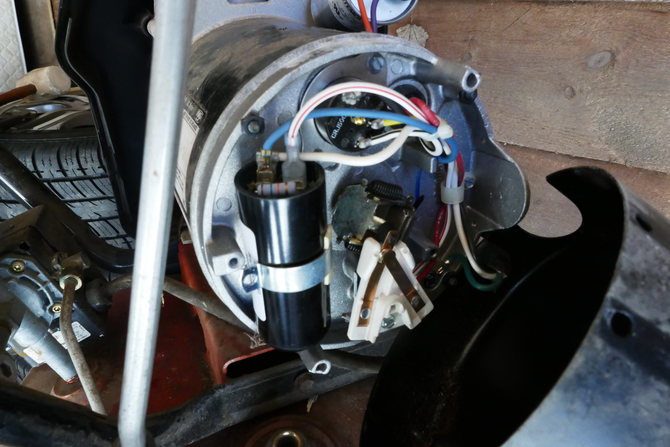

Here are some pics: First the meter as set on Ohms. I grounded the black lead to the green wire in the motor first. I then touched the output wire from the start capacitor. Nothing or no needle movement. I then touched the black wire with the red meter lead while meter was grounded. Nothing. I then touched each run capacitor wire while meter was grounded. Nothing. I then touched the two run capacitor wires and the needle went to zero. I then touched the green wire and the motor casing: the needle went to zero. All other touches needle stayed on infinity.
That means that the winding of the motor is not shorted to the ground. That is good. When you touch the capacitor wires you are measuring resistance of the winding that is parallel to it. It is typically some small value. To get more precise measurement you need to adjust zero fo your meter. Short the leads and use screwdriver to adjust the needle to zero. Then use the smallest range to measure the resistance. it should be around 10-20 ohms. Make sure both capacitors are good, the starting switch is closed and the power cable and plug are also good. If it still doesn't start it is time to take it to a repair shop. They have a tester that can detect bad winding and even might have used motor if your is bad beyond repair. And Moss Road is right if the unload valve on the compressor is bad the motor will not develop enough torque to start running and it will blow the breaker.

I don't think my meter has the capacity to measure "small ranges". Both capacitors are good. Cable and plug look to be fine.
If there his no air in the tank and the bottom moisture let off fitting is open, and the compressor piston turns freely by hand, would this cancel out a problem with an unloader valve ?
Allow me to ask another question at this time that may have been lost in this shuffle. I measured the start cap with a capacitance meter a friend has. It read 141. The label on the cap states a range of 136-163. This cap if good, should have still started this compressor correct? Even though it was more speccing toward its lower number Mf's, it should still be adequate?
There is still one more thing i can do and that is to dissemble the motor from the air valving and then see if the motor starts. This is a pain the the ***** job as I have already stripped a hard to get at Torx screw head deep in the covering.

There are two capacitors. Both have to be good for the motor to start. 141 mF should be good. Empty tank is equivalent to unloaded compressor.

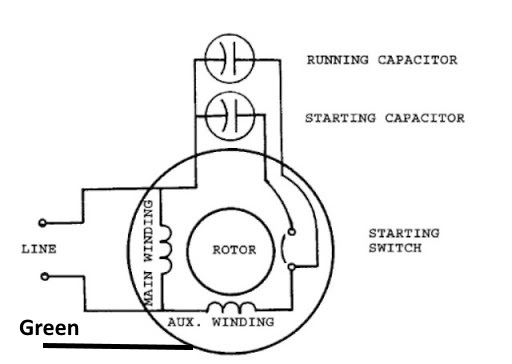

For AC wiring Black is "hot", White is "neutral" and Green is frame ground.
Part of your testing proved nothing is shorted to ground.
You need to test continuity through the starting switch and aux winding.
So where do I place the meter rods? One on switch and black to ground? Thanks
/ Air Compressor puzzle #71
No, measure across (one probe on each side) the switch and across the winding, in Ohms to check for continuity.
The switch opens after the motor starts spinning, so it will be closed with no power applied.
Note: black to ground is for measuring DC voltage.
Read and learn: How to Use a Multimeter

Thanks XFax. I have some type of reading deficit. I can read a small paragraph but anything after that my brain doesn't process in a cohesive manner.
Please bear with me but I think you mean one probe on the start contact of the switch and the other further up the circuit (winding?)
/ Air Compressor puzzle #73
No problem, ask again if needed.
Across the switch.
Across the winding.
