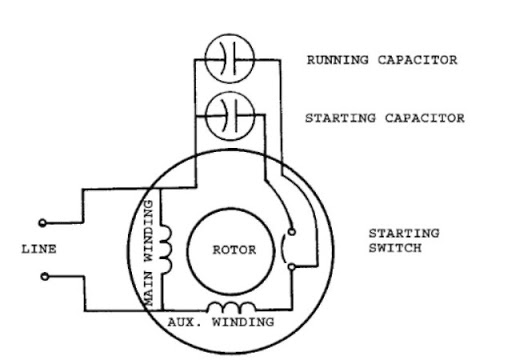

The motor has two capacitors. The inside is the run cap and the outside is the start cap. Both have to be good for the motor to start. They are parallel when starting and the start cap is disconnected after motor acceleration.

Can you measure the windings? Make sure you don't have a short/open?
I do not know where to put the leads nor the setting on the meter (50 ACV?) to test windings.
   / Air Compressor puzzle #44
It depends on the meter. Usually, you use the same position like for voltage but select resistance ( Ω ). The resistance against the ground (body of the motor and/or green wire) should be high (MΩ), the resistance of the winding is low 15-25 (Ω).
#45
Ok I'll give this a shot. Thank you. I tested the start cap with a proper capacitance meter. It fell within the parameters of the cap (136-163 with a reading of 142). So what's left are the windings and or a stuck reed valve.
Which is considered the "winding"?
   / Air Compressor puzzle #46
Winding is any wire going inside of the motor. Primary winding is connected directly to the power (to white and black wire) the second winding is connected to (usually) white wire and to capacitor and/or the start switch.
So I tried this. Needle pegged on the green wire. Didn't move on the white or black wire. When i touched the run capacitor wires w/o the capacitor, the needle pegged and stayed there. Why the resistance on the run capacitor wiring? Thanks
